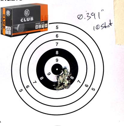

RWS Club - 0.391"
rws club

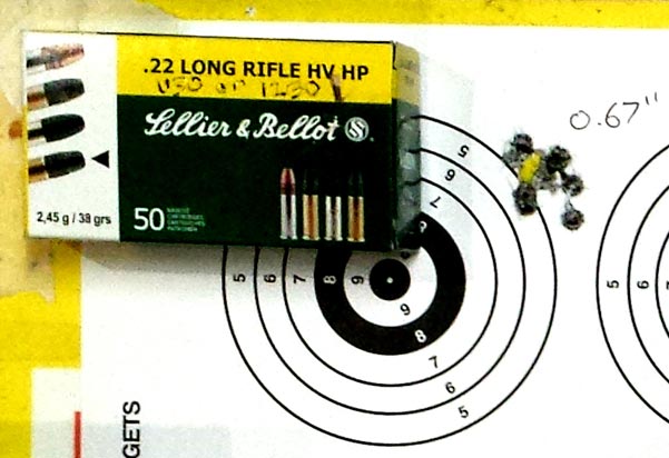

Sellier & Bellot HV HP - 0.67"
sellier and bellot hv hp

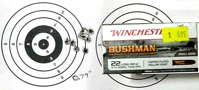

Winchester Bushman - 0.79"
winchester bushman

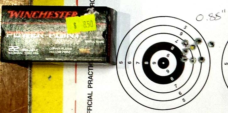

Winchester Power-Point - 0.88"
winchester power point

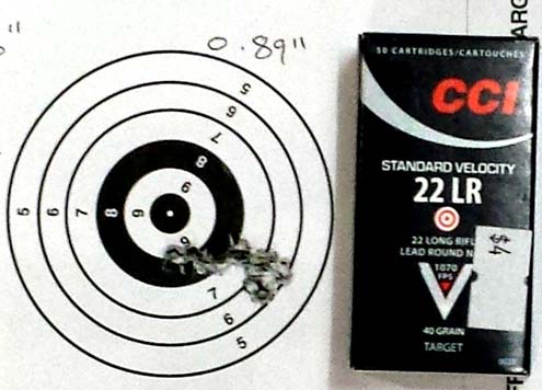

CCI Standard Velocity - 0.89"
cci standard velocity

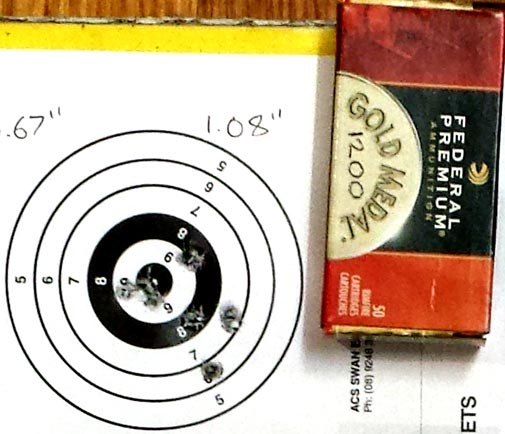

Federal Gold Medal - 1.08"
federal gold medal

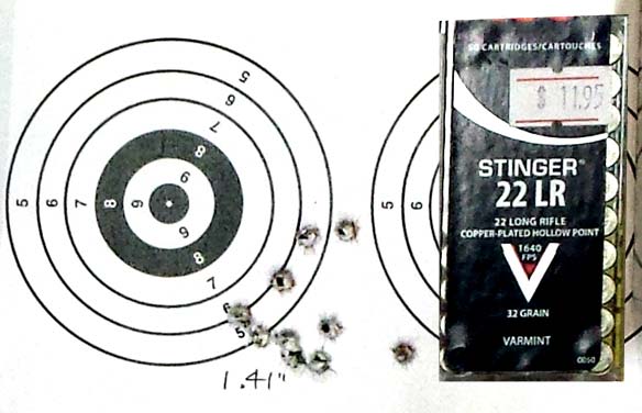

CCI Stinger - 1.14"
cci stinger

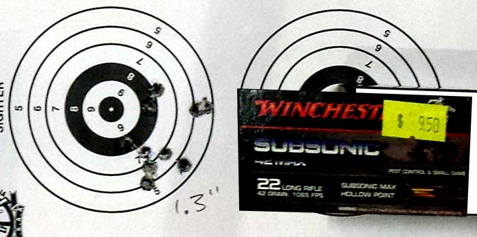

Winchester Subsonic - 1.3"
winchester sub sonic 42 max
