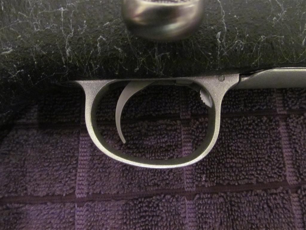

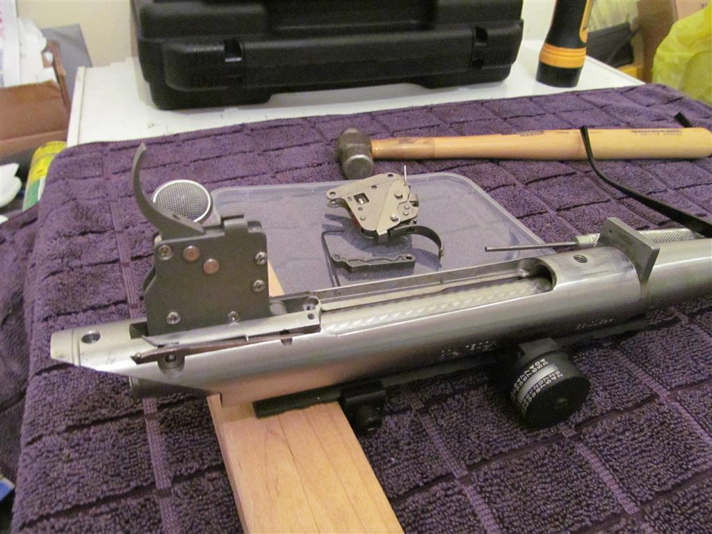

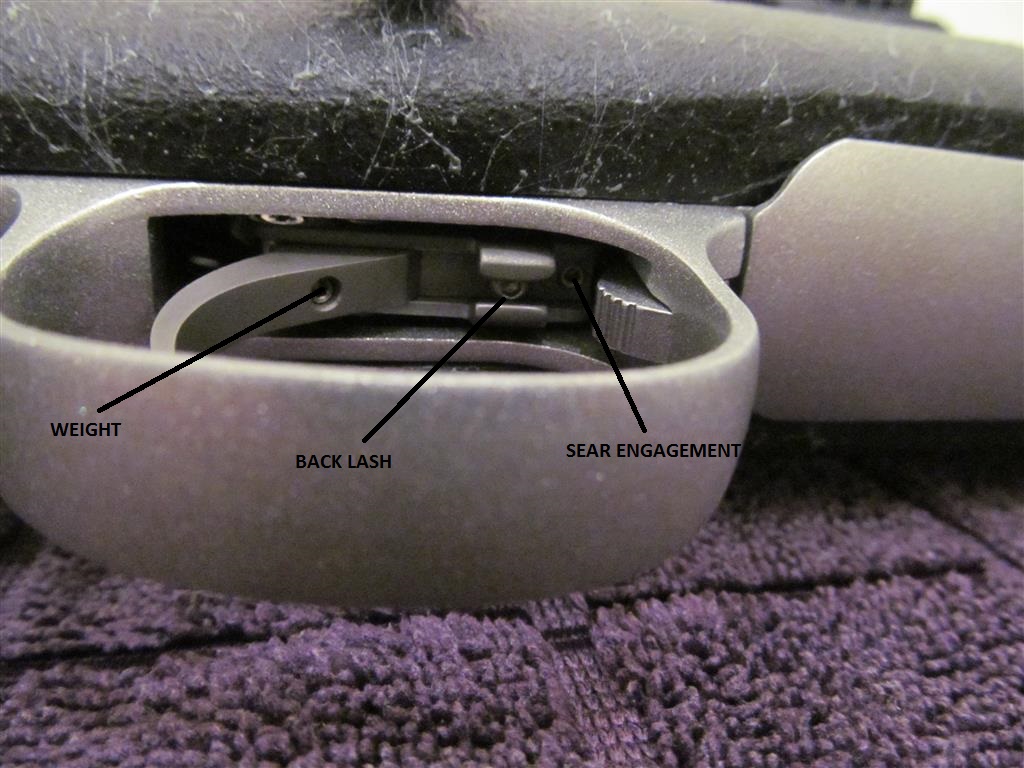

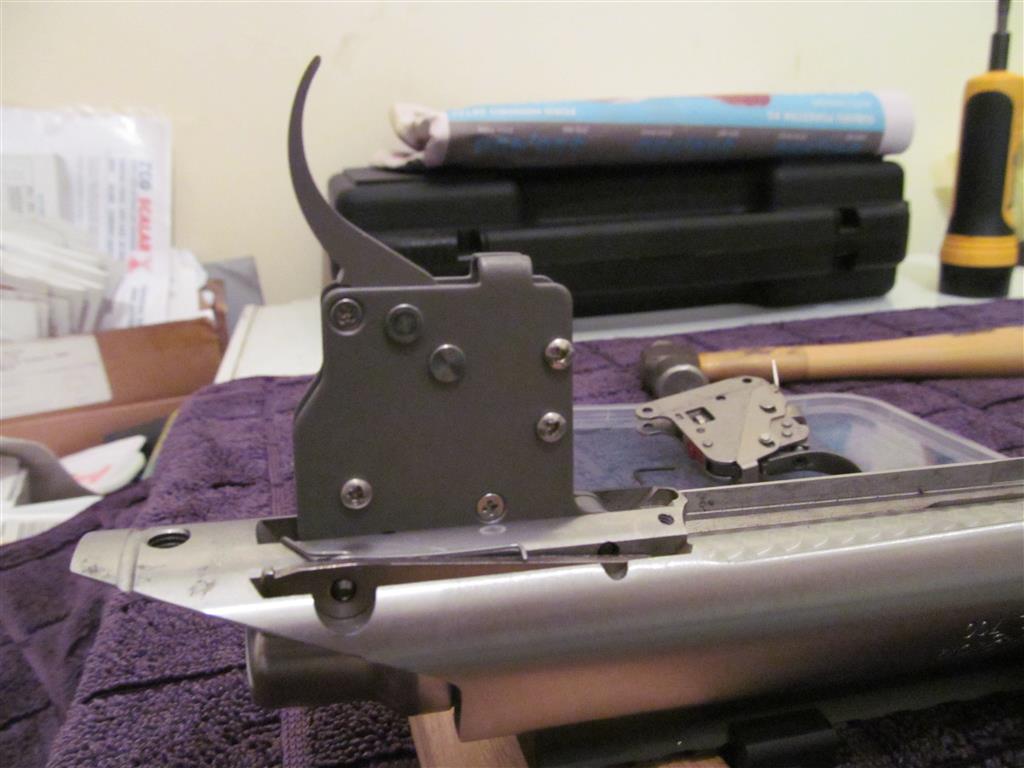

Sir, you have impeccable timing just finished the 7mm and AFAIC tell they're worth every cent.
I put the b spring so pull weight is aroun 6 to 10oz and buy far the best trigger i have ever played with.
one thing i realy like about these triggers is you can adjust everything without taking the stock off.....

Aand the x mark trigger that was in the rifle was set at about 11/2lb as the ebay guy worked it over, so now it's for sale.

Tell a noob what 'back lash' adjustment is?

i just do the adjustments before i put it back together .
buster wrote:Tell a noob what 'back lash' adjustment is?
it is the adjustment that limits the amount the trigger move's back after the sears break .
for off a rest i like no backlash but on a off the shoulder hunting rifle i like heaps of backlash
like on a cz 22 it is just personal preference .

Cool, thanks mate.
Never new such an adjustment was in there. Travel and trigger weight is all I've ever heard anyone talk about.
I see the reason for it though.

+1 for the hunting.
I've shot some minimal backlash triggers in the field and with the difference pace of shooting I find my finger starts to ache from pushing against the stop when I'm expecting some follow through on the trigger pull.
