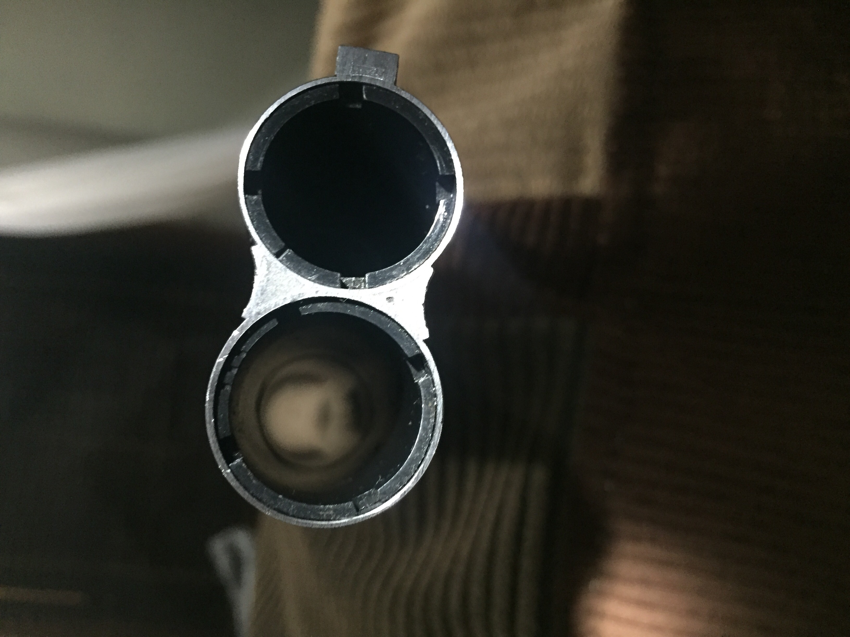

Posts: 157
Re: Miroku Mk70 help
Post by Bigjobss » 20 Mar 2017, 6:10 am
I went through the same learning curve a few months ago.
Yep theyre chokes, the top is "full" and ths bottom is "half" - or the confuse matters Browning / americans call it "full" and "modified'.
See the smaller notches on the chokes? The bottom choke has a set of three small notches at the top left. These identify the choke sizes and are explained on the green tubes.
Im guessing the spare is marked "CL" or "Cyl" for cylinder and is the most open of the chokes with "full" being the tightest.
Its good to have the other choke options when switching between field vs target or steel vs lead. I know last year I ran a different choke setup on the rice where the shots were a lot closer.
Bigjobss
Post by Bushie » 20 Mar 2017, 6:34 am
Ohhhh I okay I see, but even s that leaves me with 3 all up and I should have gotten five, I'll have to talk to the boys from the shop and see what the go there is
12G > Anything else
Bushie
Posts: 157
