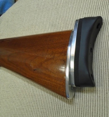

You can fit the recoil pad yourself .. the end result doesn’t have to be overly pretty ... I just wouldn’t rule out a gun choice because of the recoil pad that it comes with out of the box.

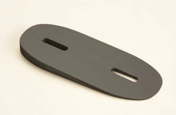

I put in a pitch spacer - ie. a wedge shape spacer between my recoil pad and the stock and it just required sanding.
If u have a Dremel it helps get it close then I used a basic sanding block and sand paper to get even closer. You wouldn’t notice if the pad extends over the sides of your stock by 1 or 2 mm.

Thanks - does a pitch spacer absorb recoil??

Not really, it's more to help me with the second shot by helping with the direction the recoil is directed. ... I mentioned it because fitting a recoil pad couldn't be much different to installing a spacer.
But, I'm not sure if this might apply to you and your collarbone but this is the theory with the pitch spacer:

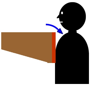

Say for example this is how you need to mount your shotgun to get your eye aligned down the rib (ie. a little high).

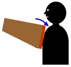

Notice the gap between the recoil pad and shoulder? .. when you fire the gun, the stock is going to pivot upwards to fill that void (the barrel will point upwards as a consequence).
It will take a bit of effort to get the barrel back on target in this case - and my suspicion is that the gap will cause "more" felt recoil than if there wasn't a gap.

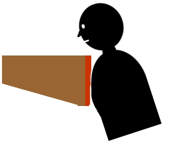

You can mount the gun with more of a forward lean, to help fill the gap .. or do lots of push-ups :lol:

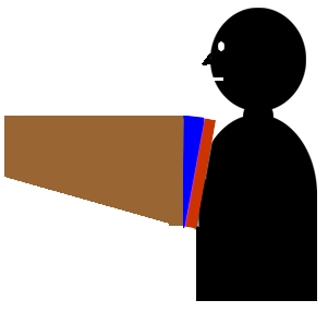

Or a cheap option, is to try and fill the gap with a pitch (wedge shaped) spacer.
I've found it has helped me stay on target and I get many more second shots than I used to - I can also use faster cartridges (for olympic trap later on)
