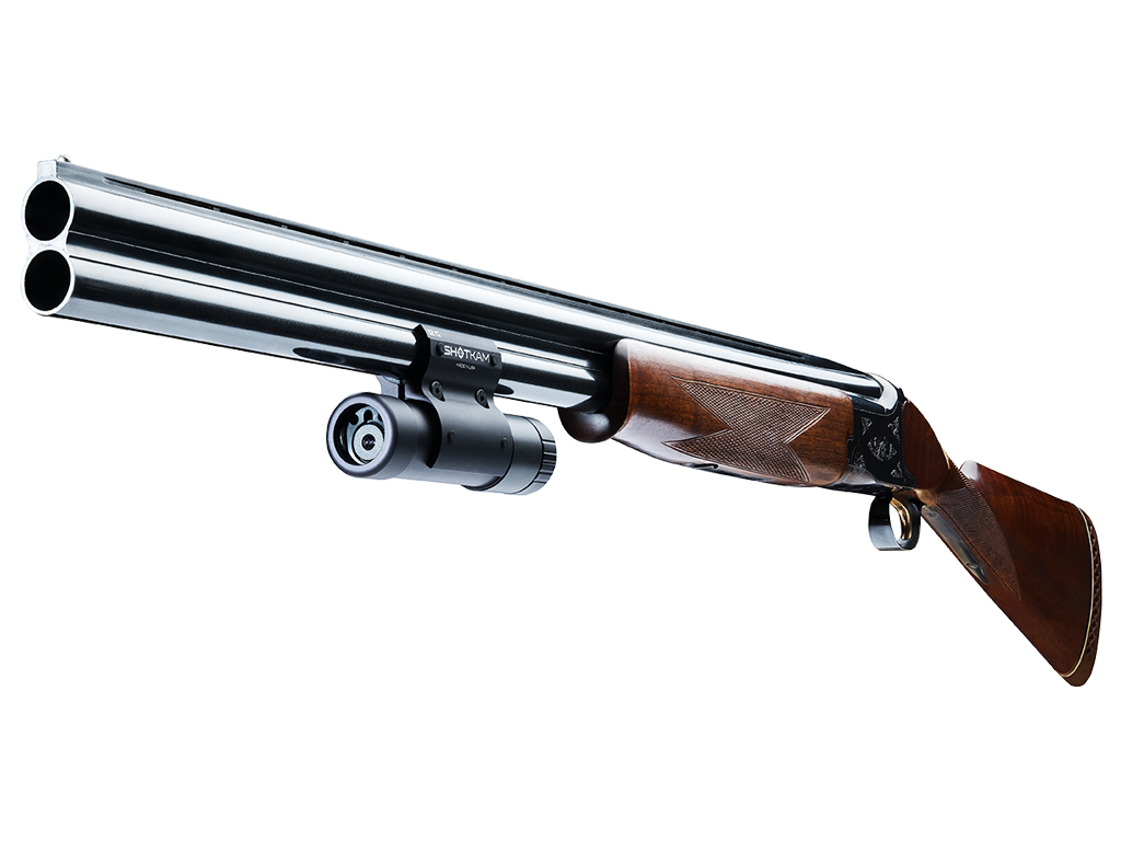

Hi guys,
I saw on fb that shotkams are available in australia now.
https://au.shotkam.com/products/shotkam
Anyone have any experience?
I’m looking at their samples (on YouTube) it’s looks good if you’re not quite sure where your shot placement is.
I’ve been shooting DTL (atleast once a week since the start of May) and have shot 24/25 a couple of times (last week with 2 second barrel hits), 23/25 a handful of times and 22/25 countless times.
I often get one shot out of 25 that I’m not sure how I missed .. so curious about this shotkam for that reason.
But I think my issue is gun mount. My next thing I want to work on is cheek weld at recoil. So not sure if this shotkam is worth it unless others have good experiences?
Just working on getting that so far elusive 25/25 (then on to 50!)
... the price at $895 is a fair amount of money to me .. I’ve saved up most of this for my first centrefire rifle, so the shotkam or a .308?
Your thoughts? Especially any A/AA grade DTL shooters .. that’s my goal .. before doing skeet
Maybe it’s better to see a coach?.. or continue with self practice... there are a couple of AA shooters that have been giving me useful tips where I shoot but they’re old school and don’t like to over think it with new things like this ..
Cheers,
Mick

bladeracer wrote:Couldn't you get the same info from a $60 Go-Pro?
I tried it actually .. I bought this: $26 (from eBay from China) .. I already had the GoPro
I can’t say the results are anywhere near the same ..
- as there is no zoom on the GoPro, it’s hard to see the clay most of the time
- u have to video edit to scale and crop to something close to what that shotkam does .. this takes ages and where your actual point of aim is, is a big guess .. I pointed at the corner of the trap house before each shot but that wasn’t too accurate
- every shot the GoPro would move out of position, so u do have to mark a position before each shot - and if u shoot 5 targets, u have to move it back into a right angle by guessing (out on the line) ... trying to figure out where it’s pointing on a second shot is really just a guess
- the weight is quite noticeable .. but I could live with it
At the end of the day, u really want to video yourself whilst doing a round without any of these distractions.. so giving up on the GoPro method
This is the one and only video I made .. took hours to get it to this point .. and most of the cross hairs is just a guess during editing .. especially the position it goes to for any second barrel shots:
https://youtu.be/u7IMkiCV_zo - just fast forward to 8m 15s to get an idea of what I worked with ... I left it at 200% zoom because I also got a lense for $20 at 2.2x zoom .. but I received the lense later and I now find there’s no chance it was stay on with the recoil.
But I suppose, if I took that video at its highest, I did learn when I play loose, I was tending to miss by swinging past the target. .. gives me a sense when I need to sharpen up, to ensure I moderate the swing speed .. something like that ..
Shotkam would save an enormous amount of time figuring those things out but I guess one of my questions is, is there only “so much” it can teach u (for DTL anyway).
Even in sporting clays i doesn’t really tell u how much lead to use .. u still gotta figure that out ..

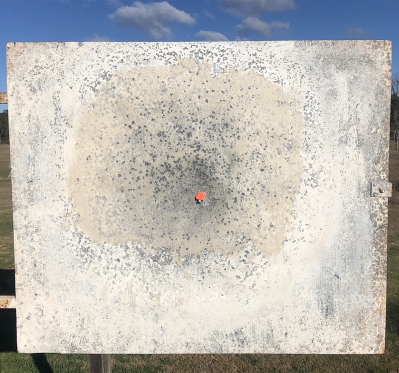

on_one_wheel wrote:Other things to consider with those shots that you're sure should've hit, could be
Holes in your pattern... have you patterned it?
Yep .. this was after the last time I adjusted my comb:
Looks pretty tight but that was at about 24 metres instead of the traditional 30 or so metres I’ve read people talking about (don’t have room to go further back) .. but honestly I can’t remember if that photo is a 3 shot average or single shot (only photo I took)
I use fixed 3/4 and full chokes
