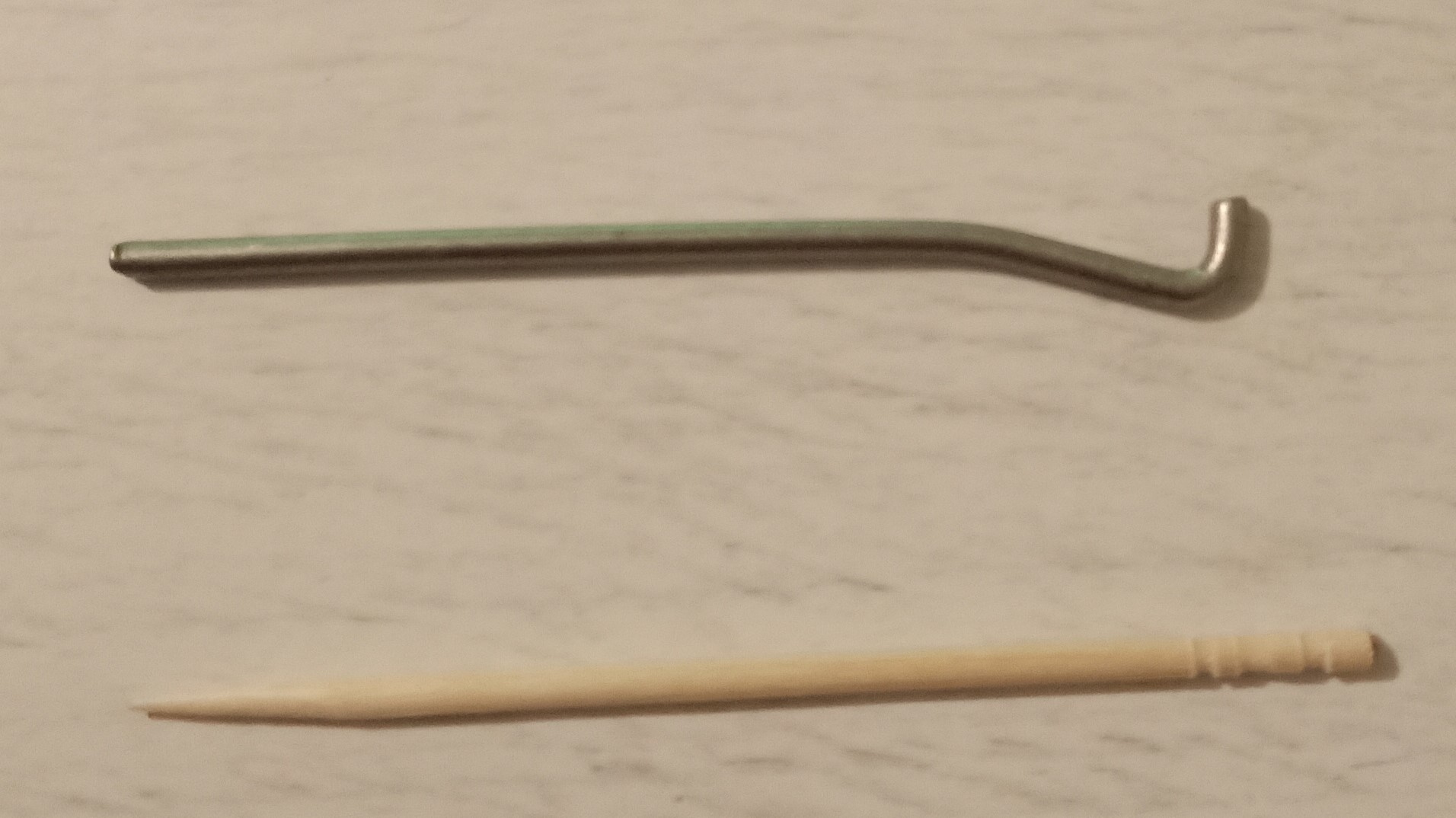

I noticed this piece of metal on my bed where the snap caps where being ejected. I'm 99% sure that it wasn't there before I was practicing loading and cycling.

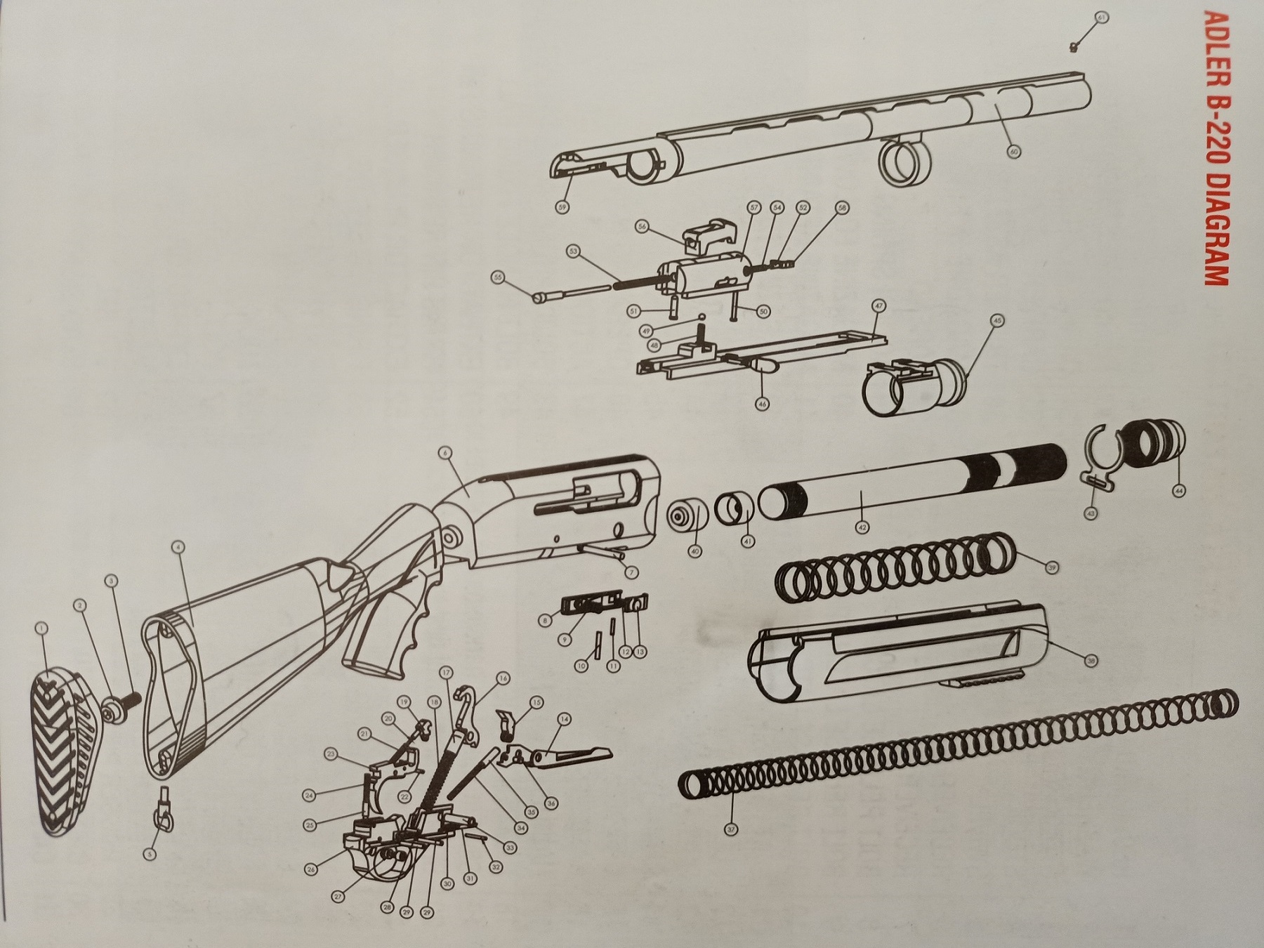

I had a look at the Adler instruction manual exploded parts diagram but can't seem to identify it. Since then it seems to alternate between cycling OK, jamming, or simply ejecting the snap caps from the tube.

I've attached a picture of the piece of metal with a toothpick for scale:
Edit to add: I'm hoping this is me just being a noob. I did press the bolt release button with an empty chamber when the bolt was locked back (to see what would happen basically) and it wouldn't lock back again until I pulled the trigger/dry fired it. I realise the shells ejecting out of the tube would be a feature, not a bug - otherwise to unload the gun you would have to cycle each shell into the chamber before ejecting, which is a potential safety issue. I'm just not sure how to do it on purpose, and why the gun seems to fail to load the next shell into the chamber sometimes.
Does anyone who has disassembled their Adler recognise the part in the picture?

This is just a guess based on whats happening.
On my shotgun (its not an Adler) th cartridges can be removed from the tube mag by holding the loading gate release button and depressing a piece of spring steel, this looks like it may have done the same job as my peice of spring steel MAYBE

Can you post the exploded parts picture, or a link to the manual?
I had a look at the lever-action manual but didn't see anything resembling it.

The little piece of metal still has me puzzled though. It doesn't really make sense for a part to fall out but still have the gun function correctly, apart from the jams which are probably due to the snap caps. On the other I have no idea where that bit of metal could have appeared from.
Here's the exploded view from the manual:

Nothing jump out at me I'm afraid.

That’s not a common looking item. I think if u had that thing in your possession prior you would have noticed it , and perhaps know what it was for ....bit of a mystery

Blr243 wrote:That’s not a common looking item. I think if u had that thing in your possession prior you would have noticed it , and perhaps know what it was for ....bit of a mystery
Yeah. And weird for it to be on my bed when the only mechanical thing I've had nearby was the gun. I thought it could be part of the loading flap mechanism, maybe a latch that locks the flap to direct the shells either into the chamber or out the loading port.
Just speculation though, and not backed up by the diagram.
I'll see what the fella at the shop says and report back.
