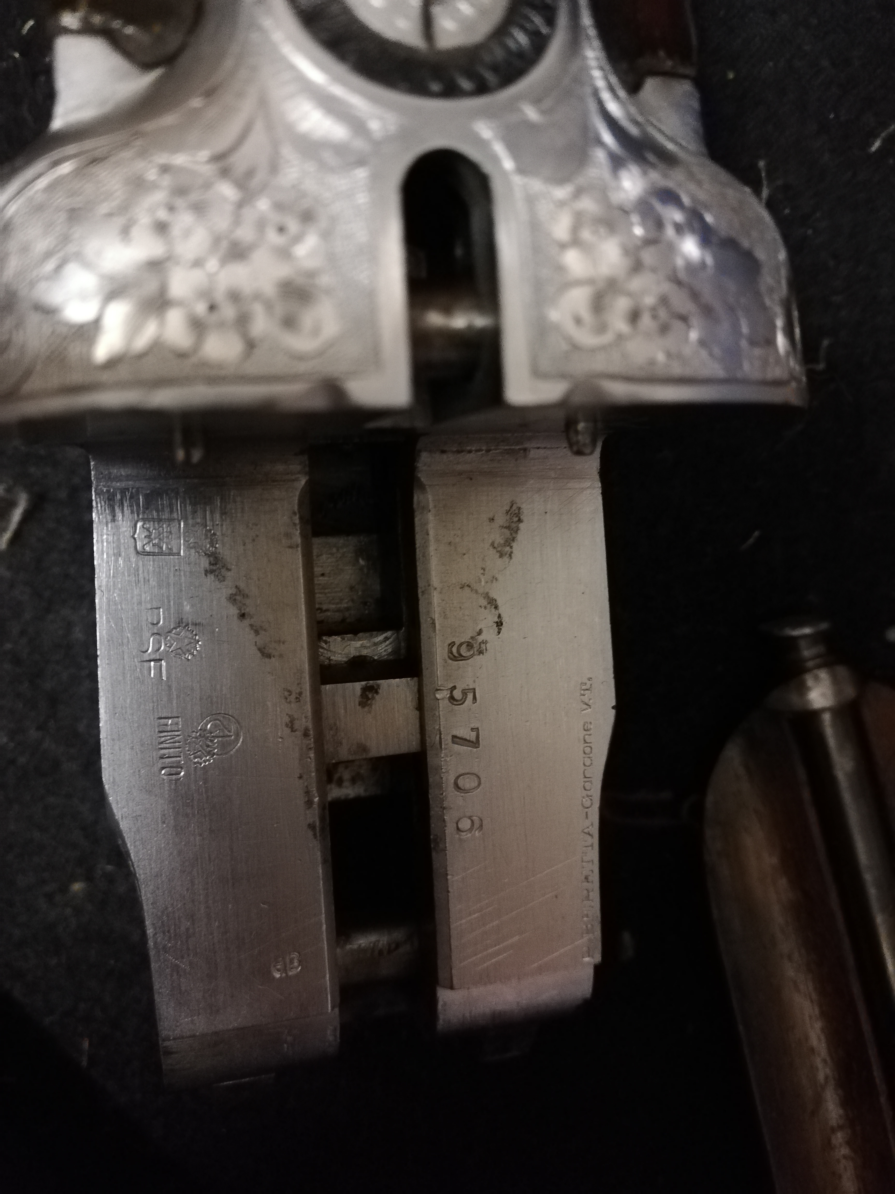

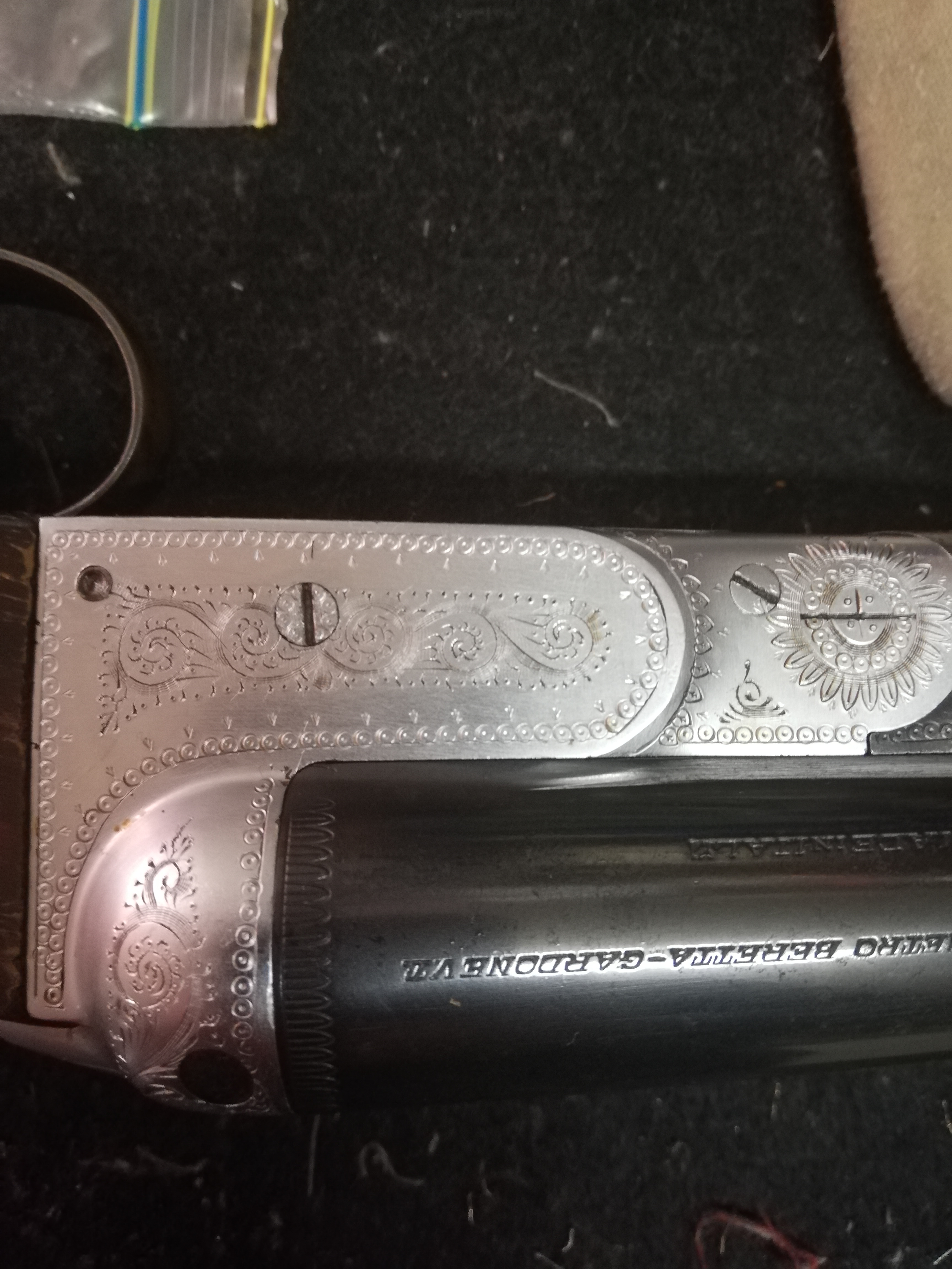

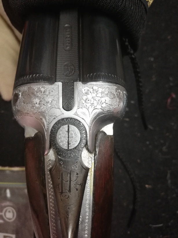

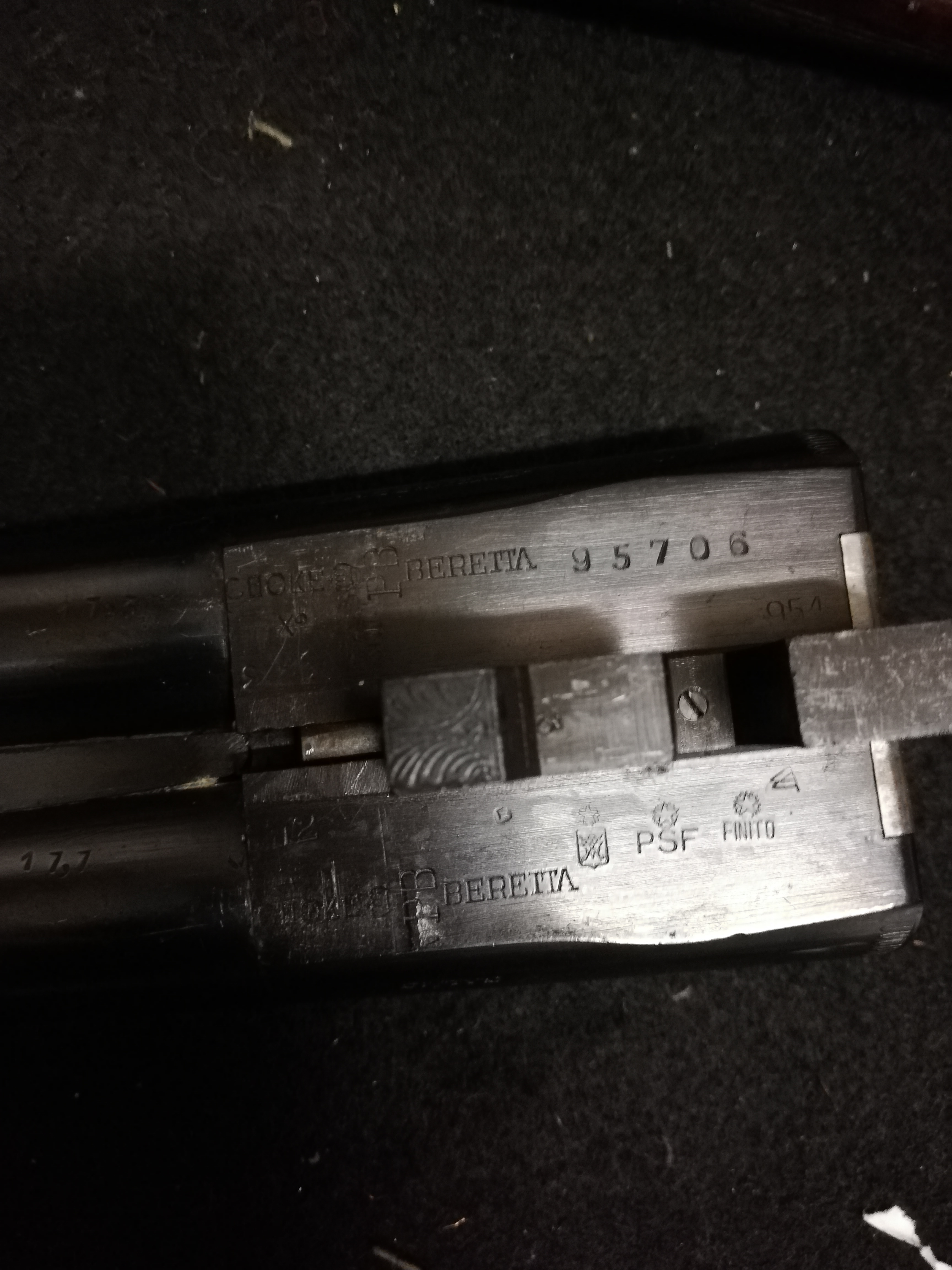

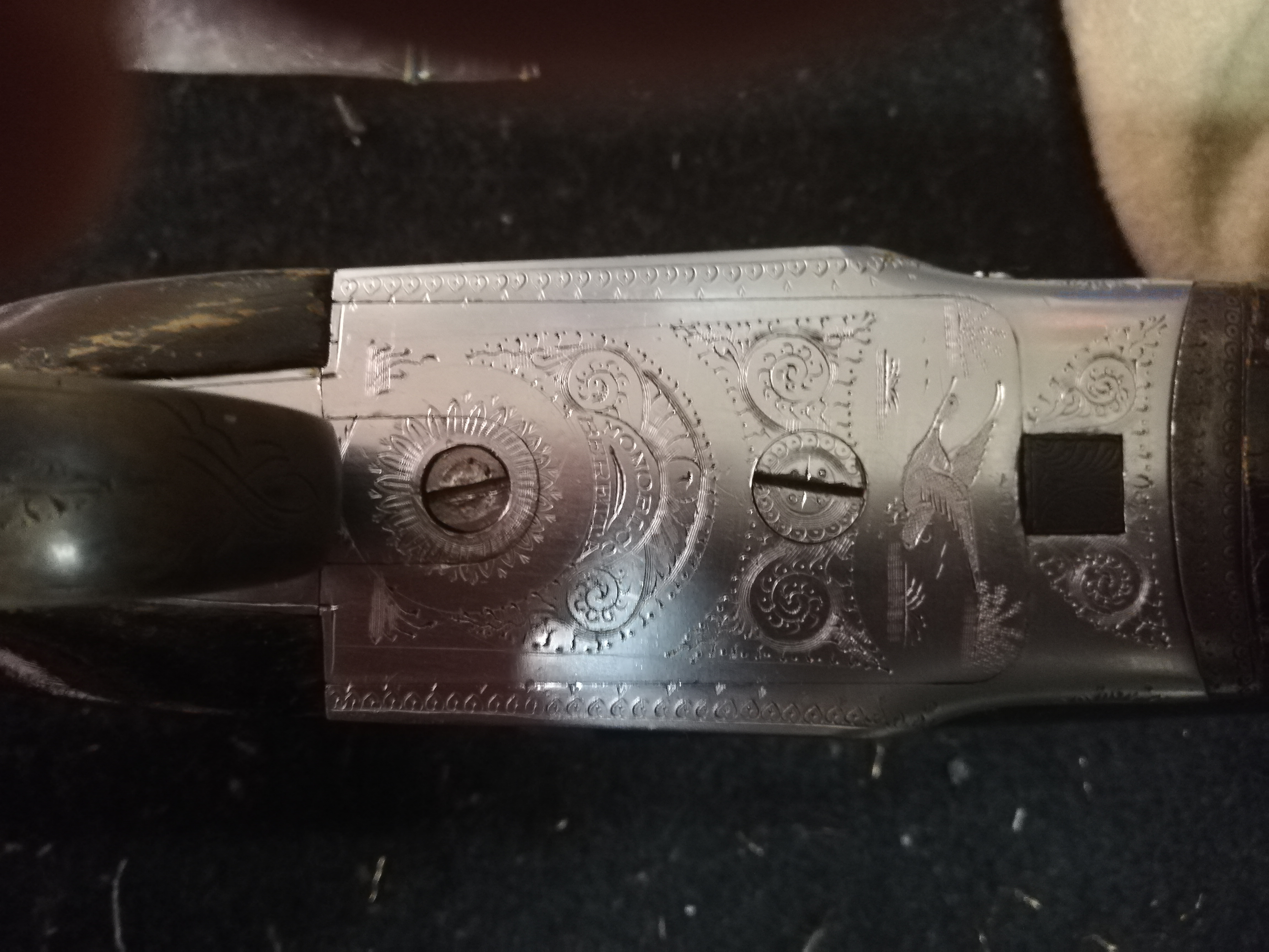

Hi
My father passed this Beretta shot gun onto me back in the 90's.I would appreciate if someone could tell me more about it, I think it is a 1960's manufacture.

It is as written under the action a Beretta monobloc. I think it may have been replaced by the Silver Hawk in the early 60's. Contact Beretta Australia with the serial number and they will be able to tell you when it was made.

Post by No1Mk3 » 11 Jun 2020, 6:45 pm
G'day tlia7,
Your gun looks very much like a Model 409, having the square back boxlock. To date it, and any other information, we would need to see the marks stamped on he barrel flats and action flats. Cheers.

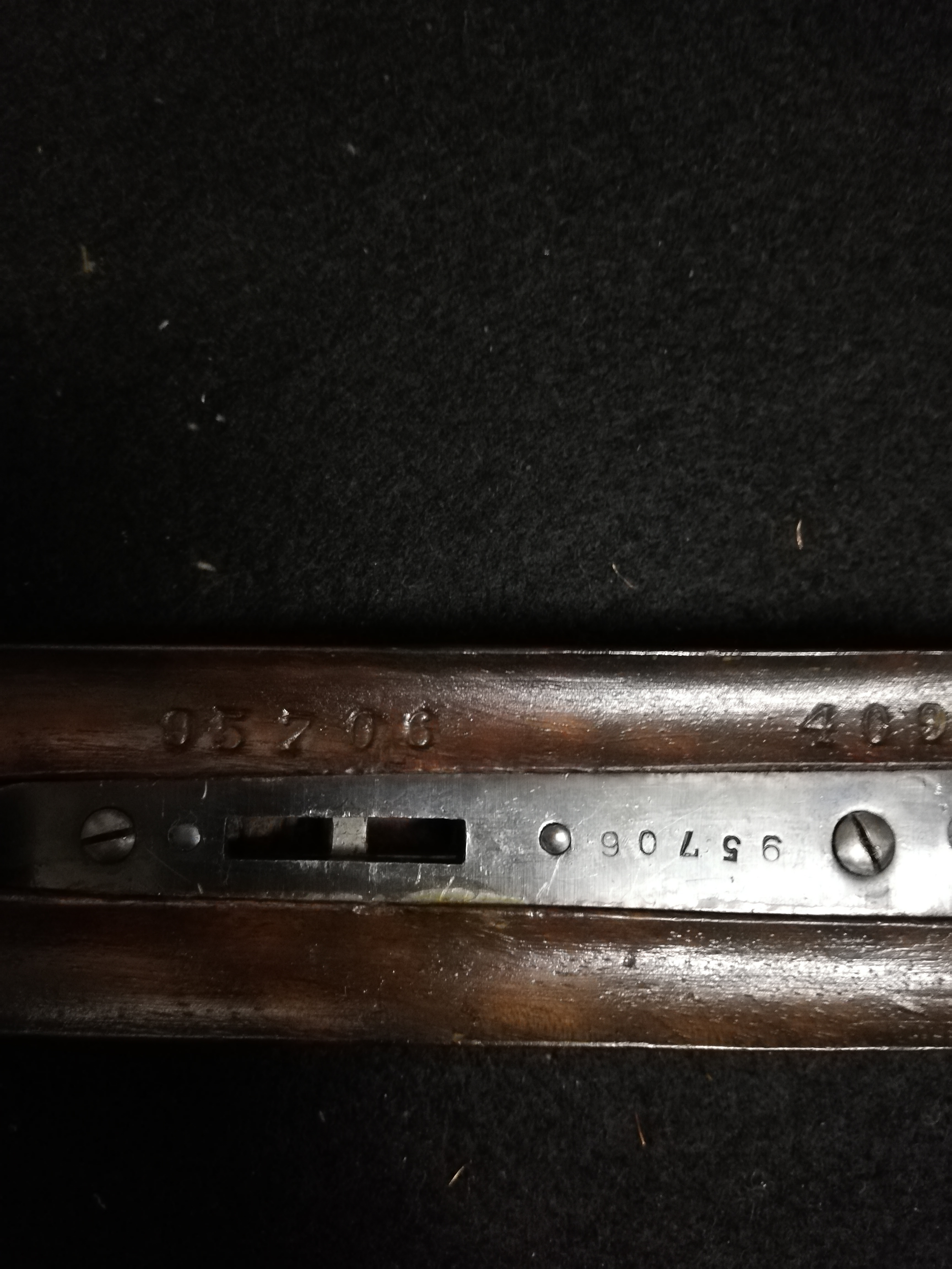

With Beretta SXS, the actual model number is generally stamped into the fore-end wood, in one of the barrel channels.

Post by Jarhead » 19 Jul 2020, 8:47 pm
Well tlia7,
The last post by pomemax makes it clear that not only is that gun old, it will be costly to dispose of due to a clear long history of contact with lead and other dangerous contaminants.
I will make you a deal and take it off you hands for free.
Bahaha.
Seriously, I can't offer any conclusive advice. I can however observe that the engraving looks like it was done by the same craftsman (or tool) as my 1980 Beretta 680 special skeet.
Can you find the two letter date code? I would be interested in knowing what year that magnificent piece of work was made.

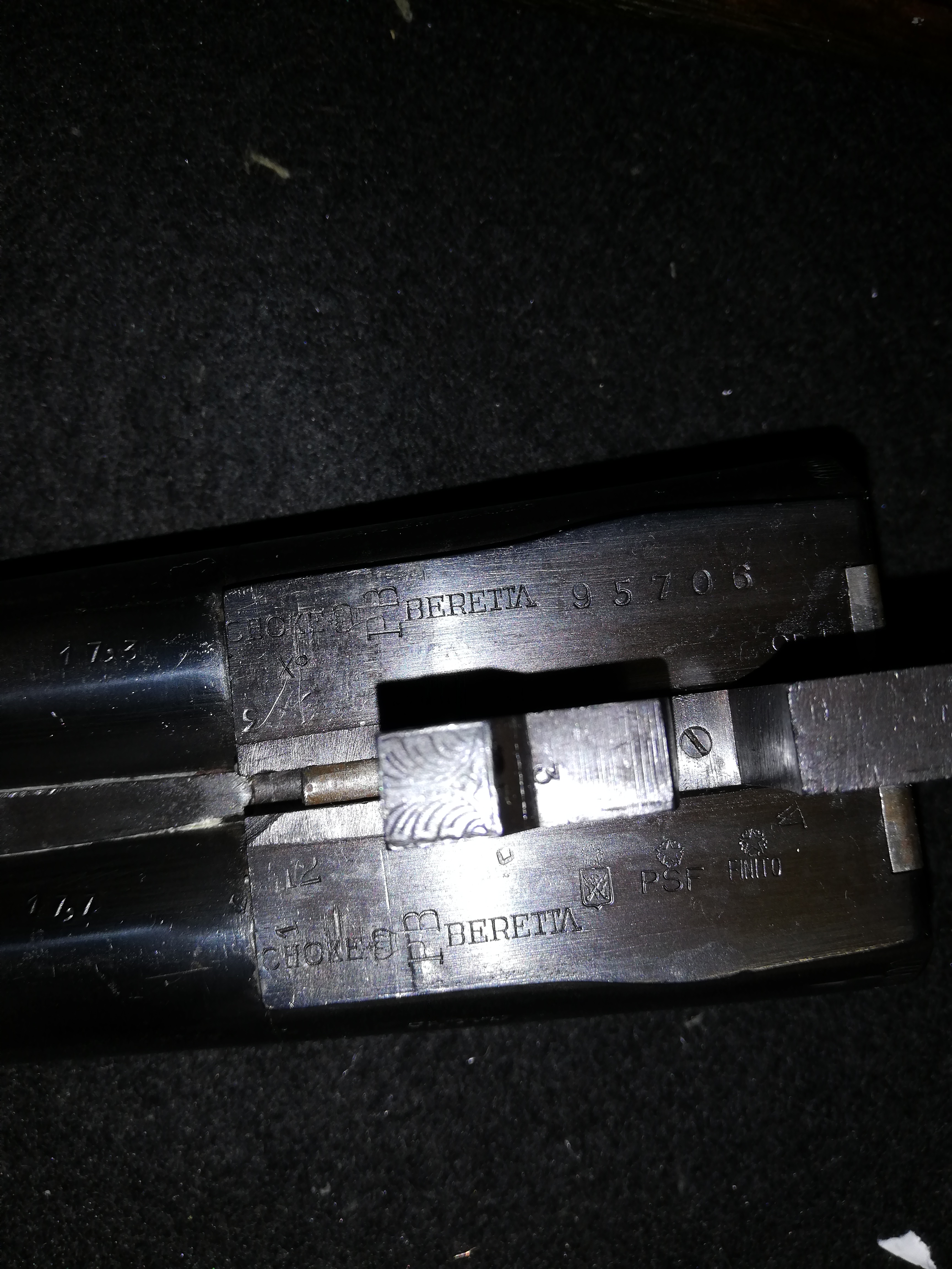

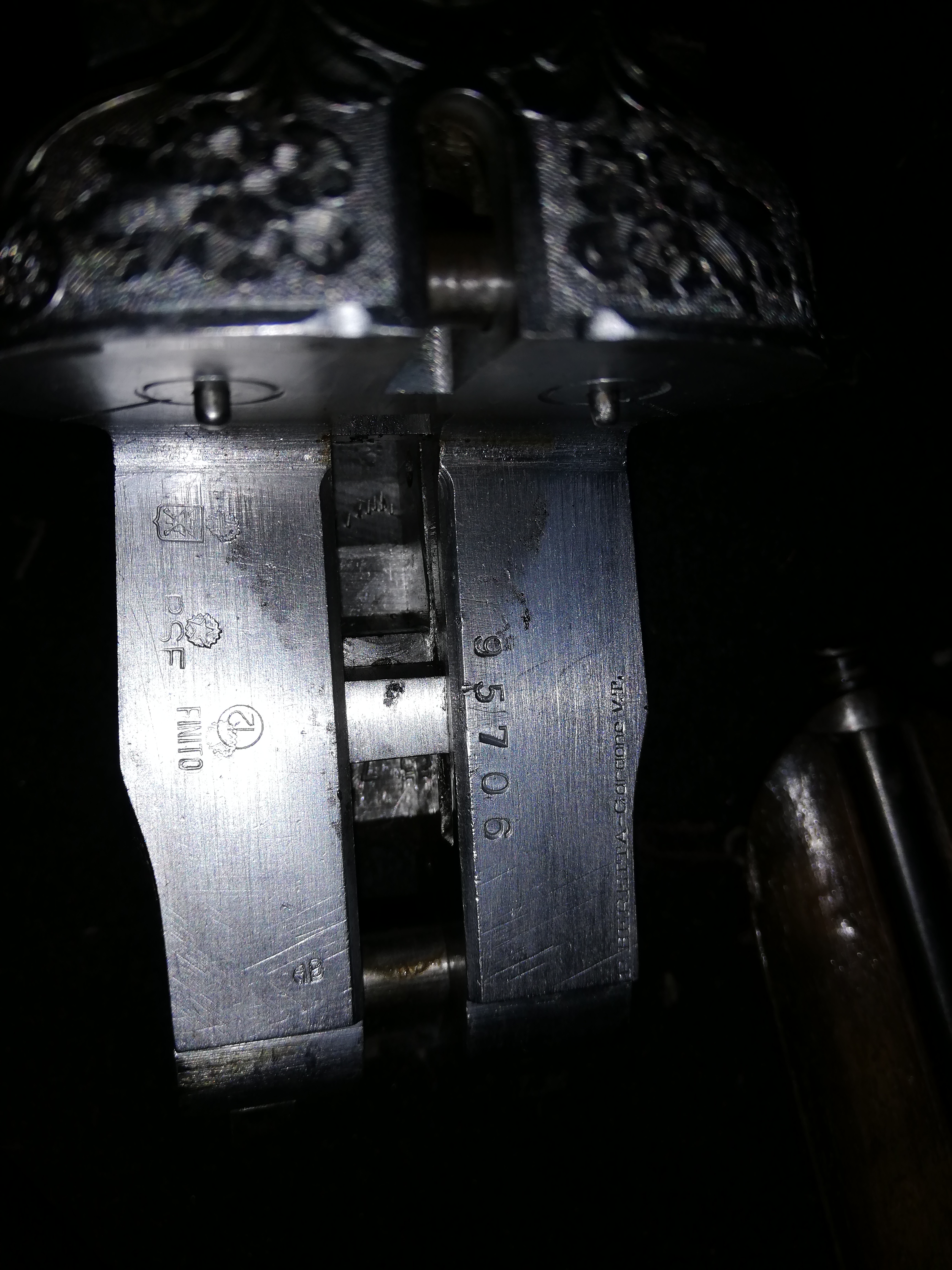

Hi all thanks for your feedback, I have taken more pictures and so far can confirm it is a model 409 and has all the appropriate smokeless proof marks.I can see what looks like a GB stamped and the number 12. but not sure if the GB is the date code as it is not on the list.

Post by Jarhead » 23 Jul 2020, 10:42 am
tlia7,
The year of manufacture looks to be 1954.
The proof marks are post 1951 and the giveaway is the "X." It is easy to miss as few years marks are single digit.

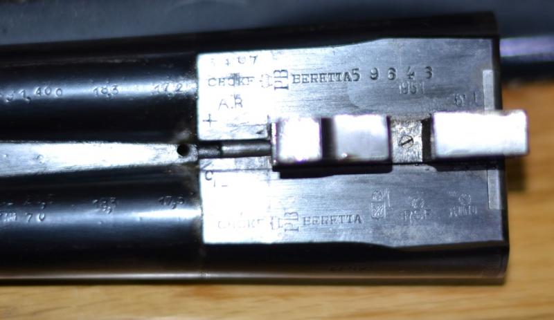

Here is a similar Beretta from 1976 with an "AB" stamp in the same spot.......

A redundant question, perhaps?
Shown in one of the photos above, the number '409' can clearly be seen, stamped into the stock wood.

possible but anyone who may search for what model gun they have may find the information of some use. I've seen a lot of Beretta sxs's over the years not all have the model number stamped on the fore end
