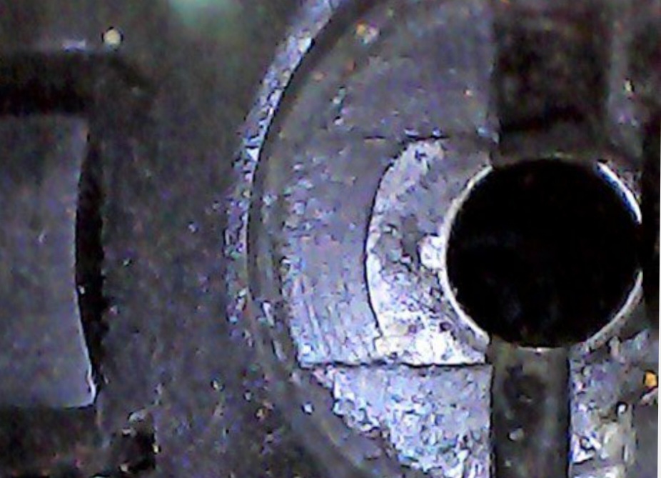

Post by on_one_wheel » 03 Mar 2021, 12:26 pm
Personally, The only firearm I don't deliberately dry fire is my .22lr, however occasionally it happens. There's a witness mark where the pin has smacked the back of the chamber but there's no evidence of damage to the pin.
I've deliberately dry fired my Rem 700's countless times for trigger training, I dry fire my Adler every time it goes back into the safe, the Stoger gets the same treatment.. ill report back to you all when something gets damaged. :thumbsup:
