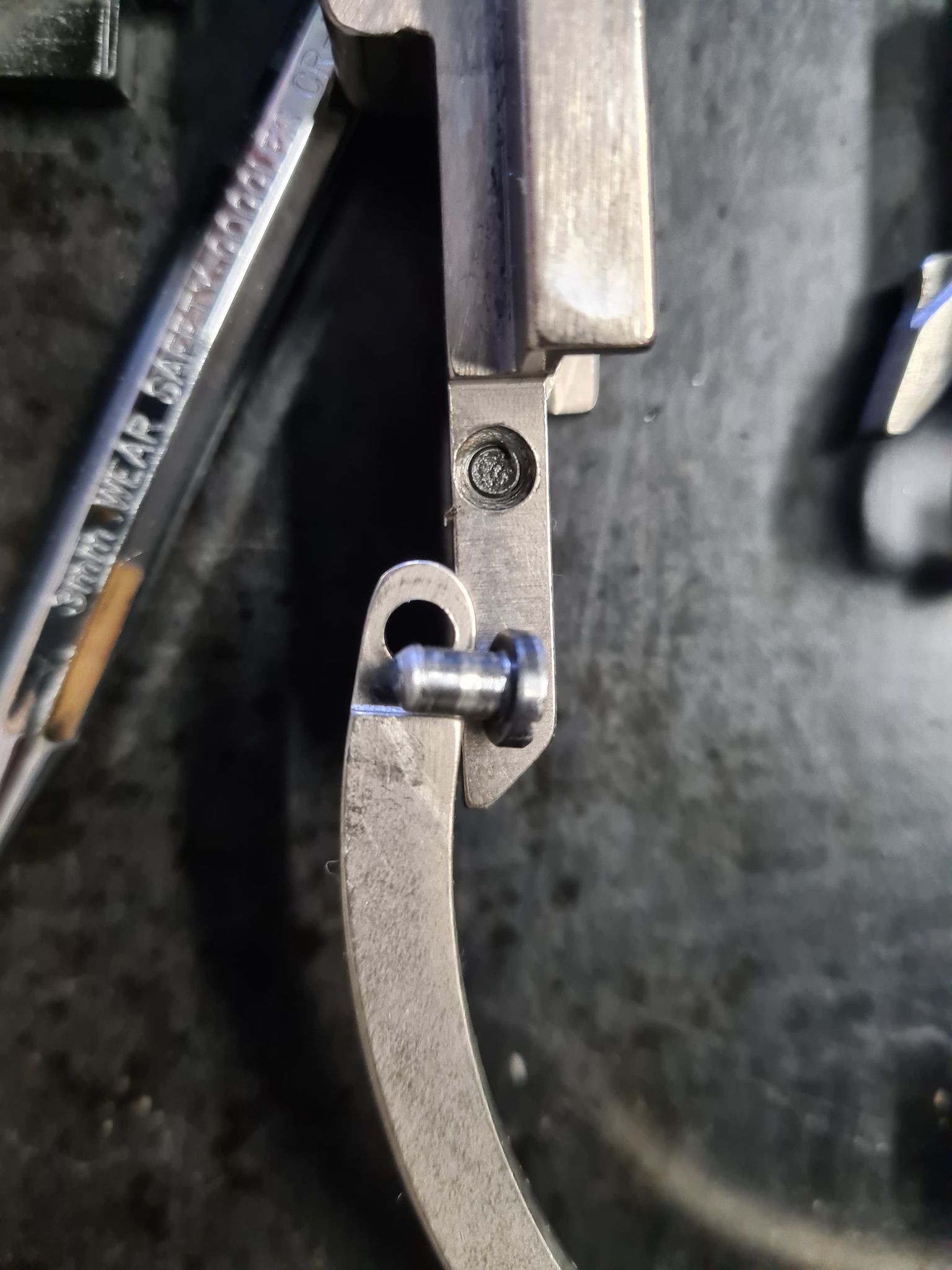

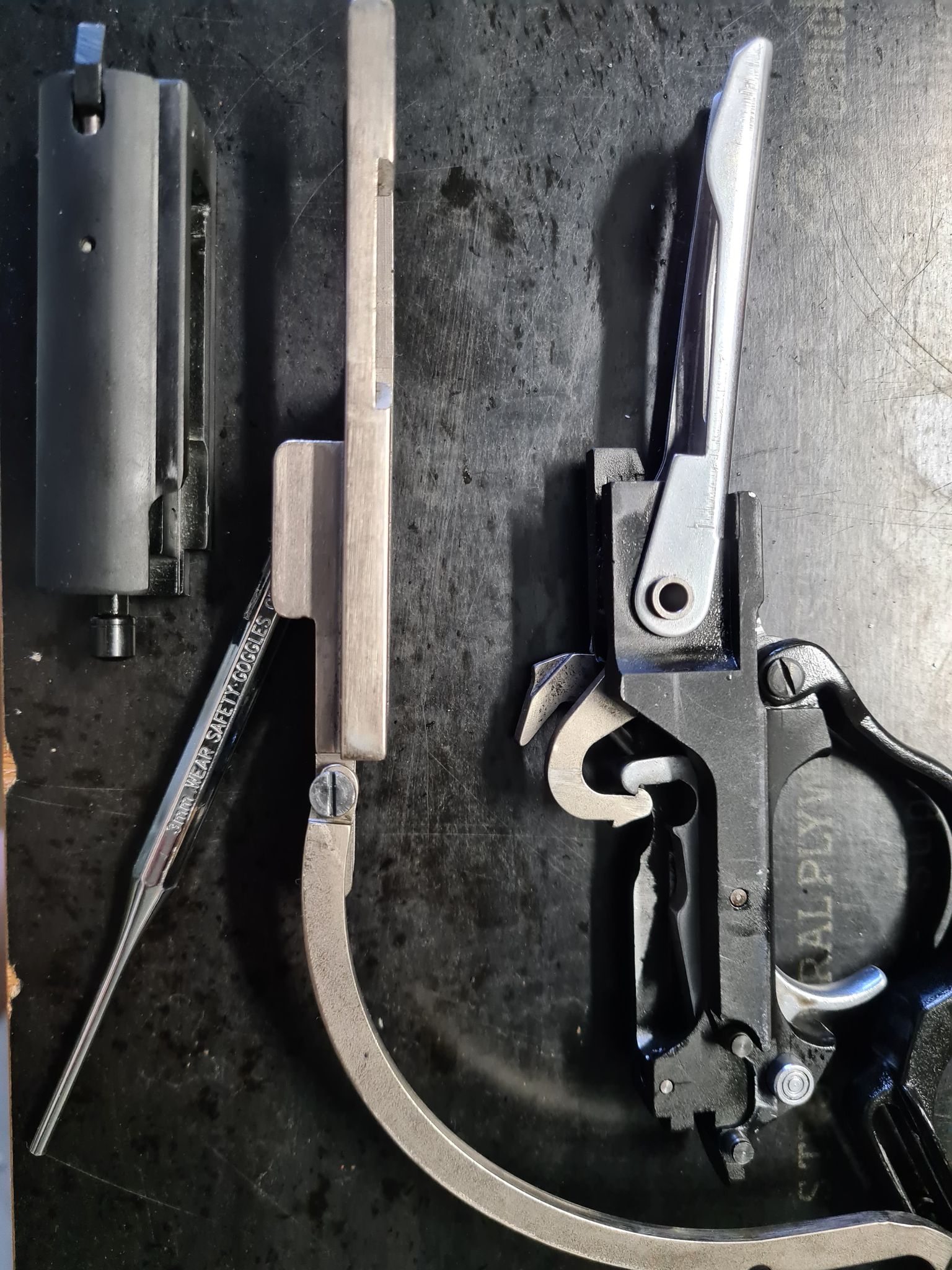

Post by TigerPigeon » 12 Aug 2022, 7:51 pm
Problem found.
Worked out how to punch out the trigger housing pins.
The screw attaching the lever arm to the bolt carrier had sheared, and was only staying in place due to the fact that the components around it were holding it captive. Will return, and hopefully have it repaired under warranty.
