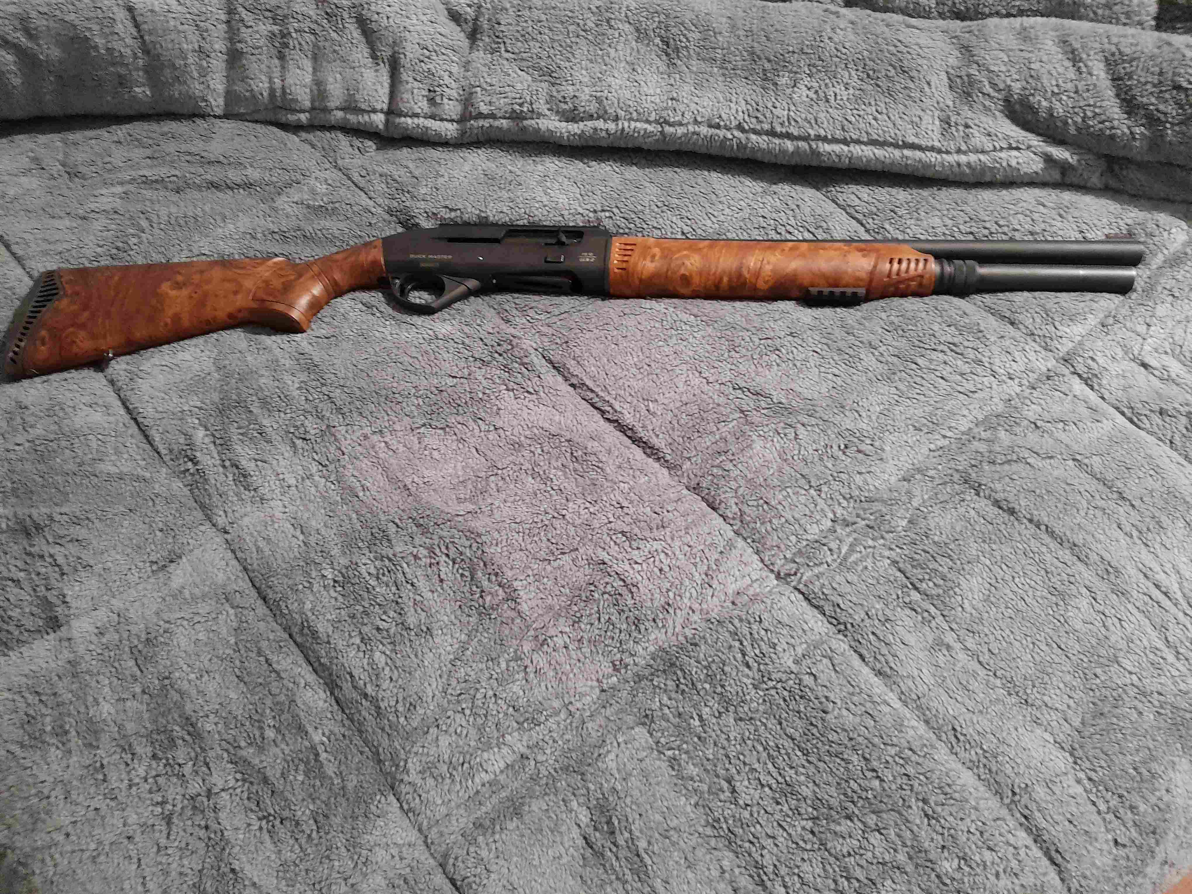

Well I decided that I wanted to throw away the crappy black stock that mine came out with, and replace it with another Buckmaster PB12 stock, the fake walnut lookalike one. No, don't ask why.
So the dealer grabbed what we were told was the last set available, and out it came. First issue was the price... $400 dollars. First punch in the face. Oh well, I never asked what the price was.
Good bit was, it was screwed straight off a gun at the importers, so it has the rear stock bolt in it, and was fully kitted out up front with the fittings including the press-mechanism too. So I had a spare everything.
Second issue, when I finally decided to fit it was when I tested it. All seven shells of buckshot in what I recon was less than one second.

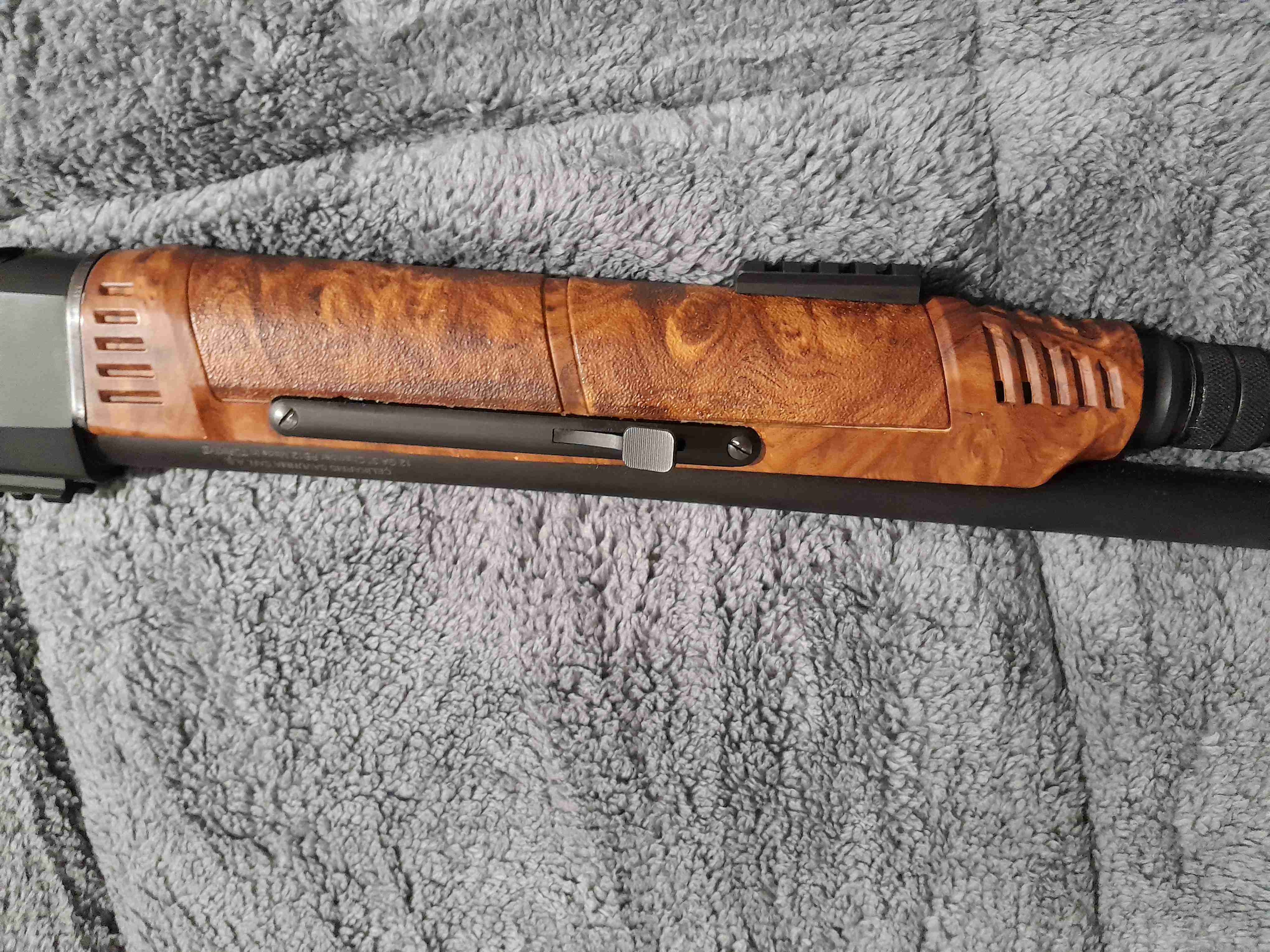

I had a look at the forend press-release, and it wasn't catching properly. Well, it was, momentarily it seemed. What was happening was, it WAS catching, just long enough for the hammer not to ride the bolt home, but rather it was tripping the hammer to drop just the instant the bolt shut fully. Even with my thumb off it. Maybe vibration, maybe a tiny evil troll sitting in there doing it. I could not actually see why.
So, out with the screwdriver and I swapped the press mechanism from the black stock it came out with.
Anyway, with the original forend mechanism taken out and swapped in the "new" fake wood stock, now it's back to normal.

There's not really much going on Damo, I haven't really diagnosed the actual reason why, possibly a radiused edge just holding until shocked by the bolt slamming home, or even possibly the suspected troll inside levering the catch at just the right moment.
I'm just glad I had a working mechanism in the old stock that had somehow been blessed.
