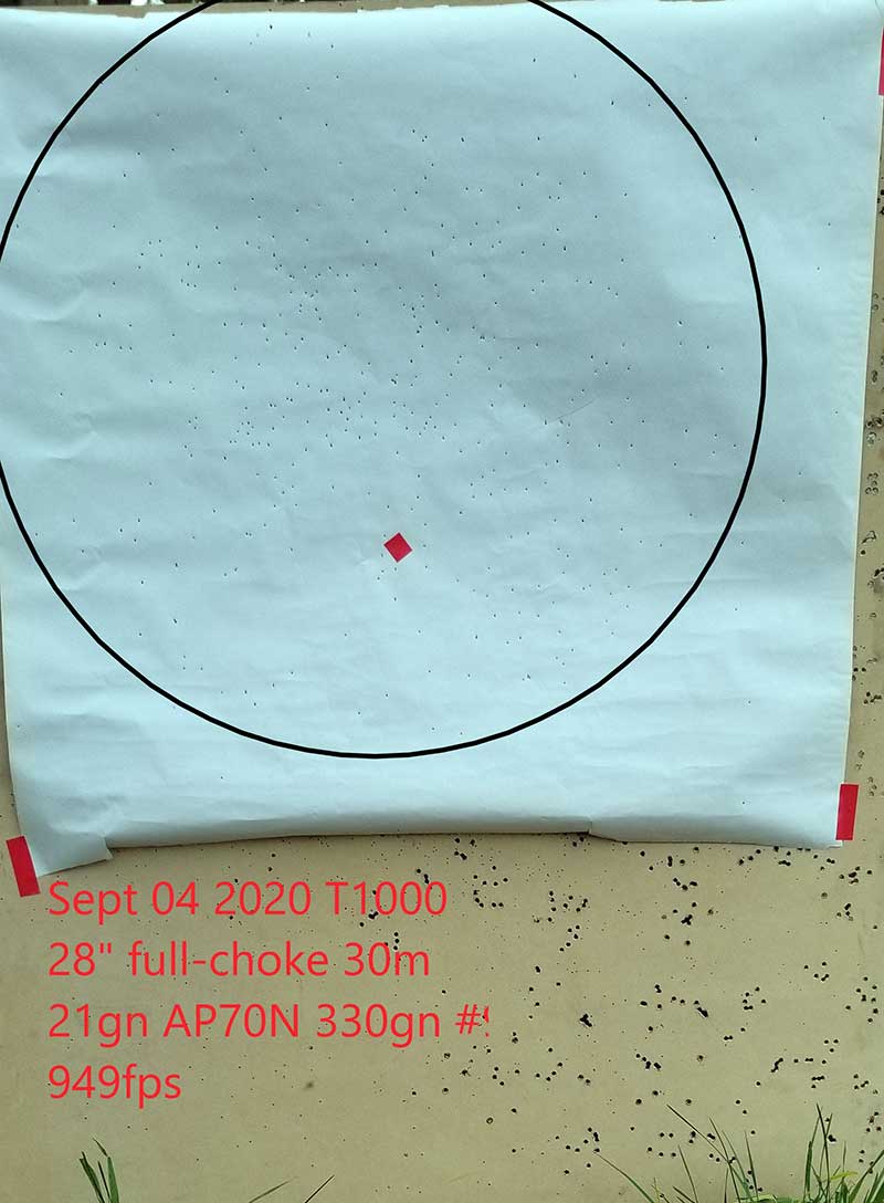

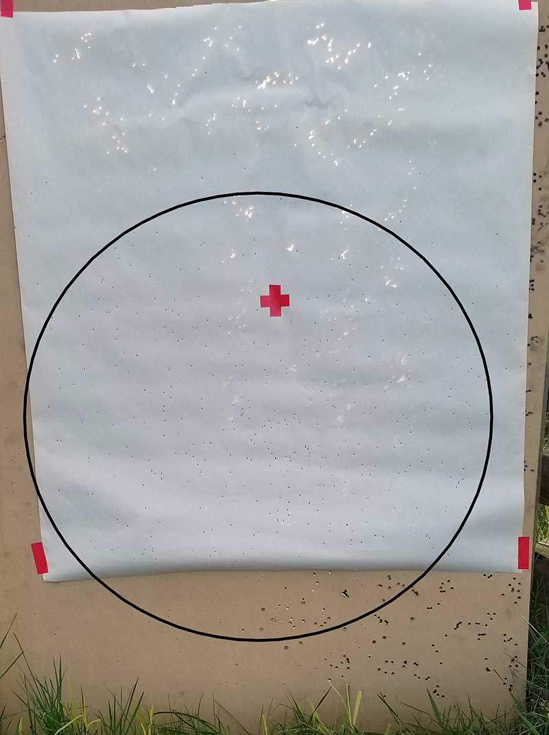

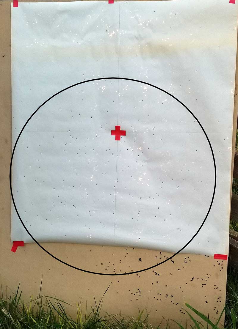

As a baseline I patterned a factory Bronzewing Terminator 28g #7-1/2 1200fps load at 30m. It made 1230fps.
1
I'm using a roll of paper that is 32" (800mm) wide, taped to 3mm MDF sheet as a penetration indicator (I figure any pellet going through 3mm of MDF at 30m won't have any trouble breaking clays). I'm patterning at 30m because of the paper width, and 30m is very handy to shoot right out front of my office reloading the same shell. I'm drawing a 30"-diameter circle on the pattern where I think the rough centre is.
I'm starting with AP70N simply because I have more of it than other suitable powders, but I'm happy to try other ADI powders if they're a better option - if I can get them just now. The load data I've seen is for the new APS powders so I'm just guessing with the AP70N load data. To start with I figure a 7/8-ounce load around 900fps _should_ be reasonably easy on me (it's still going to bloody hurt but will hopefully be tolerable), so I'm using Winchester AA12L 7/8-oz wads (39.1gn) and the factory Bronzewing hulls (I believe they're considered to be "Cheddite" straight-wall ribbed), with a .046" plastic over-shot disc (5gn) to fill the gap over 380gn of shot (total payload 425gn excluding powder charge), then star-crimped. Primers are Win209.
20gn of AP70N pushing 380gn of #7-1/2 (320 pellets) makes 875fps, and is not at all hard on the shoulder.
2
The thing is though, I'm not seeing a significant difference in the pattern, despite having only 87% of the pellets, and only 70% of the velocity of the factory load. The pellets are identical as they're taken from the factory Bronzewing loads.
22gn of AP70N pushing 380gn of #9 (530 pellets) makes 955fps, and is starting to be felt.
3
I do think I'm seeing a denser pattern with the #9 shot though, since there are 65% more pellets.
All of these are still passing through the 3mm MDF so I think the velocities are sufficient, I want to try the #9 at the 875fps velocity next.
More testing to do yet. Anybody feel like explaining how to analyse a shot pattern :-)

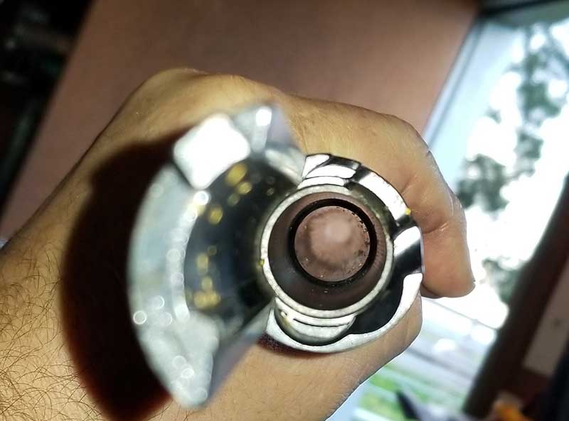

I'm not seeing anything particularly fithy in the bores so far.

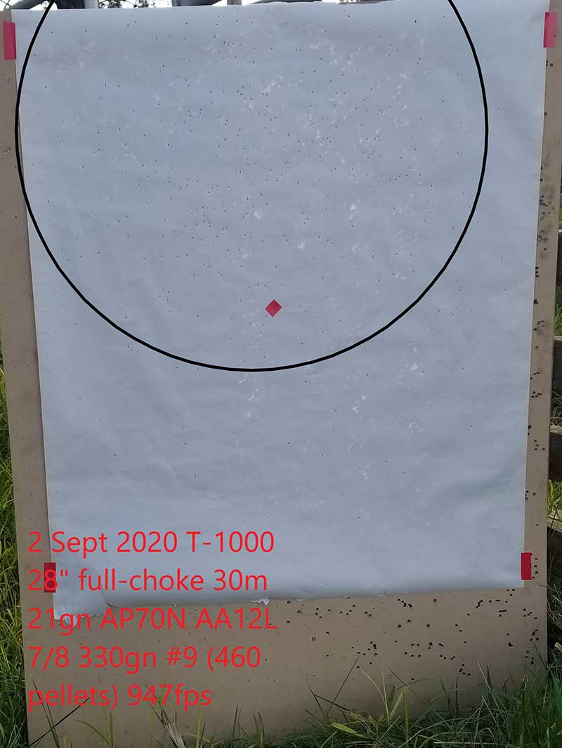

I think I've settled on a load of 21gn of AP70N under 330gn (3/4oz) of #9 shot (460 pellets) at 950fps. Not all the pellets are pushing through the 3mm MDF but the pattern is still quite dense.

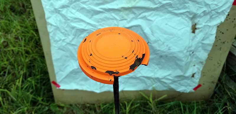

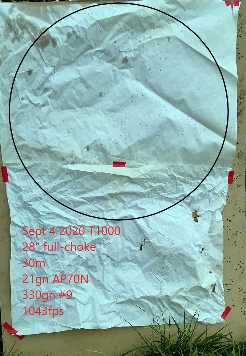

The wind died down enough to pattern five more rounds just now.
I sat a clay side-on on top of a bamboo stick in front of the board to test penetration, with very poor results :-(
Only the hottest load actually managed to chip some pieces off, despite making 1043fps, after being dinged by the four previous rounds - without knocking the clay off the stick! Because the gun is patterning around 180mm high I'm aiming at the tape diamond, but the clay is sitting nearer the pattern centre. It's probably taking eight-to-ten hits with each shot, in flight I think it should take two-or-three at least out of the shot column. The first shot dinged it nine times then I rotated it for each shot.
1
And this is only 30m at a stationary clay, I think #9 shot is going to need 1200fps at least, just to be effective to 30m. But I suppose I've made a light-recoiling load for close-range pest birds and rats :-)
I think I'm going to have to look at #7-1/2 shot again.

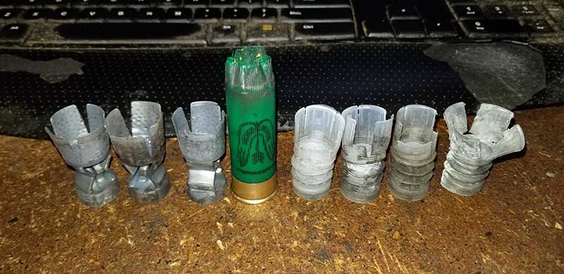

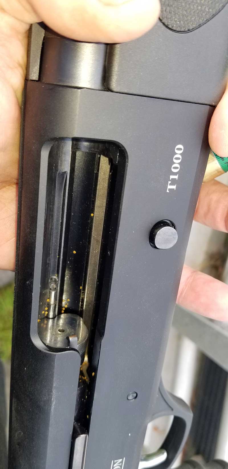

There's a small amount of burned powder residue in the action and bore, but not much. Case heads are expanding .003-.005".

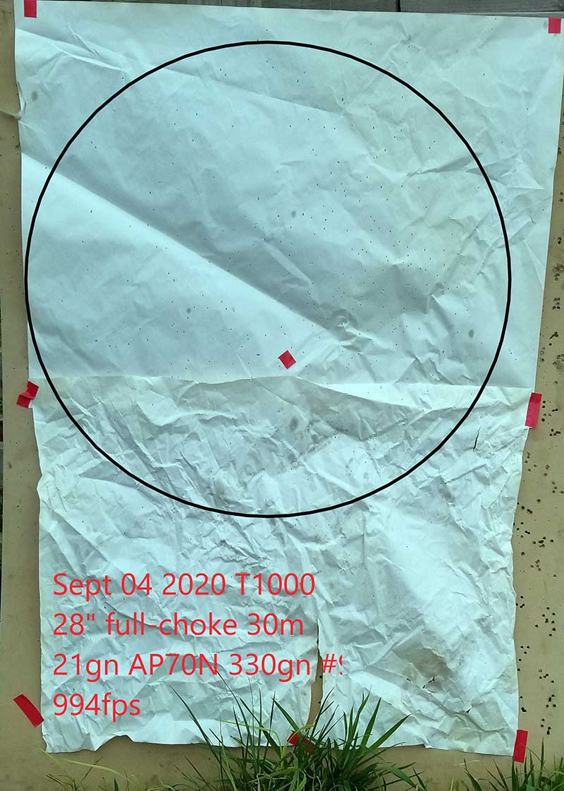

2
3
The first shot was the tenth firing of the hull, which still looks fine, although it now has three splits in the crimp. It went 925fps. I've drawn the circle a couple inches too far to the left I think.
4

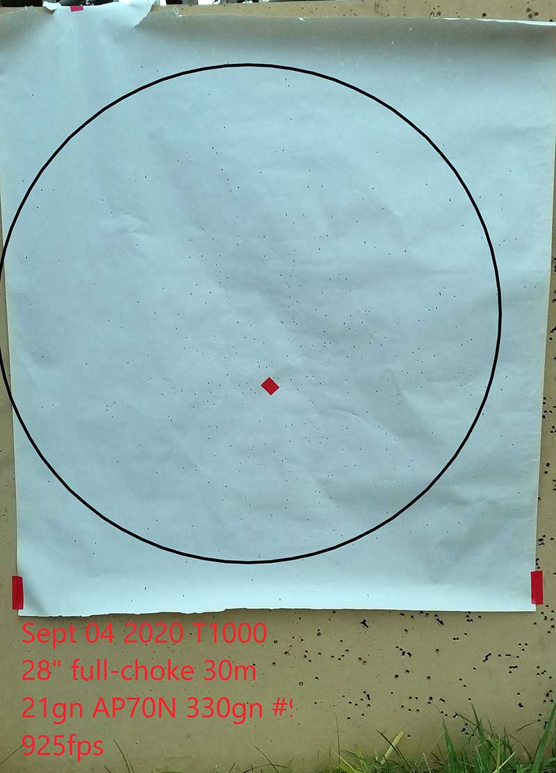

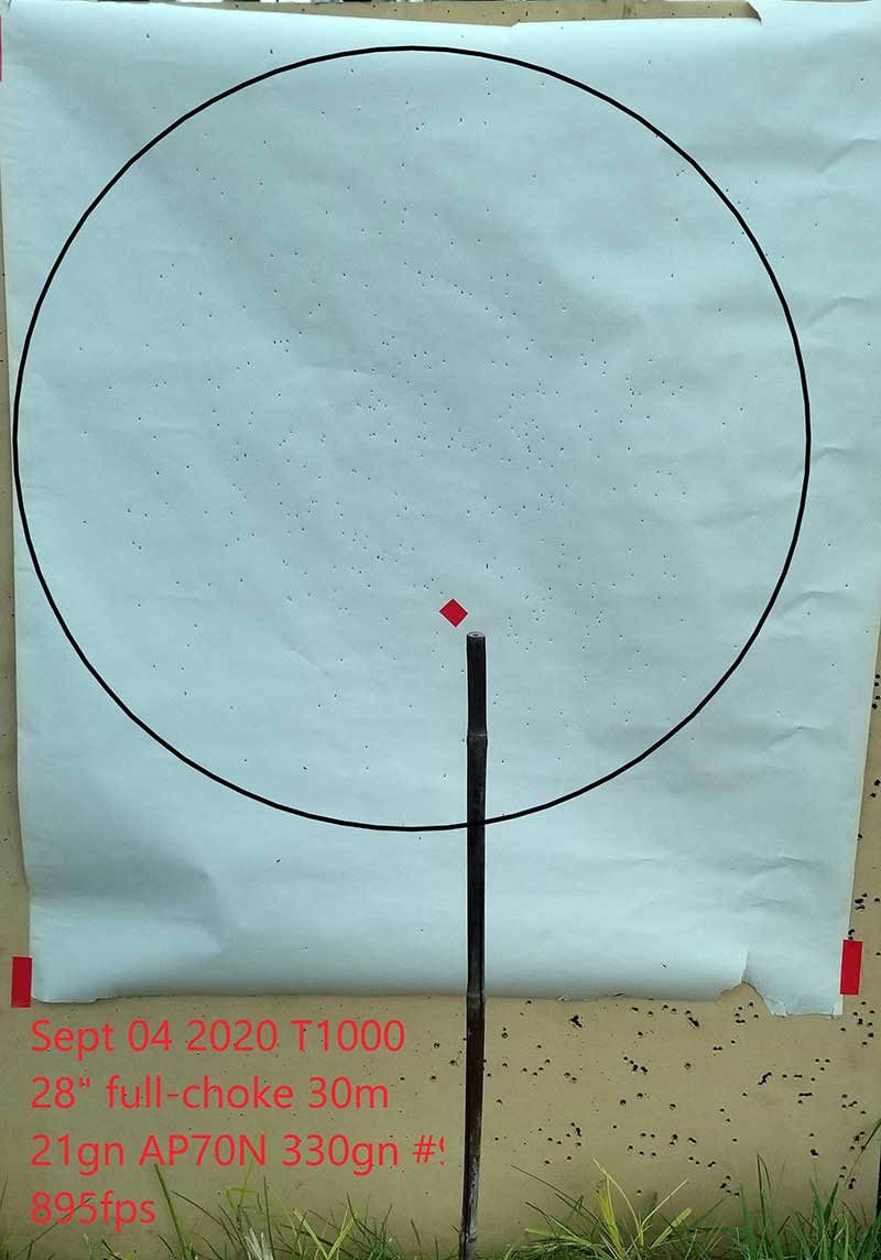

The rest are once-fired Bronzewing Terminator hulls. Second shot made 895fps.
5
Third went 949fps.
6
Fourth went 994fps and has some patches in the pattern.
7
And the fifth went 1043fps.
8
I'll see if I can find a tighter choke for it so I can shoot lighter loads of #7-1/2.

bladeracer wrote:I was going to include pics but today the forum has been restricted to 500Kb attachments!
Which is way too small to see pellet holes.
Mate, the pics above are under 100kb and look ok on my mobile. Maybe the more recent ones are out of focus or something? If the original pic is good then compressing it to under 500kb should result in a very good pic.
Edit, I'm on 2 other forums and they are limited to 250kb. That's a tough ask but it works.
Those pics I posted have been renamed and made smaller. When I posted them they were between 1Mb and 1.5Mb. Admins I guess.

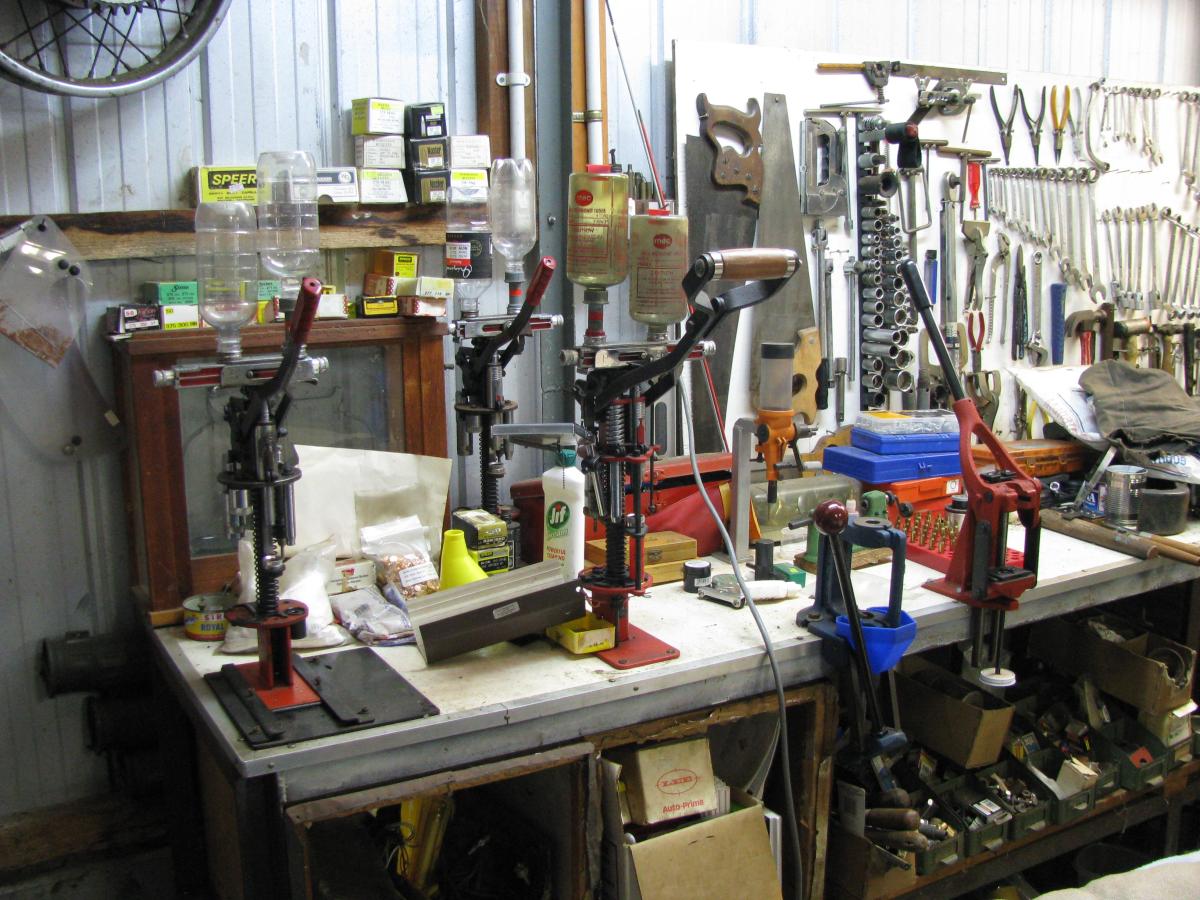

my loading bench
L to R; MEC600jr 12ga, MEC600jr 20ga, , MEC650 12ga.
Awesome Gadge :-)
