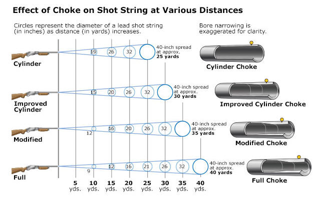

Choke spread will not be derivative of barrel length. Choke is a simple barrel restriction, a funnel if you will, sending the shot into a tighter pattern downrange.
Cylinder will generally group 40" at 25m, improved will go to 30m, modified 35 and full 40m with the same spread.
This will vary gun to gun and choke to choke so it's important to pattern your gun. Load will also make a difference, heavier shot tends to fly straighter.

LawrenceA wrote: Full choke is the amount required such that any further restriction does not tighten the pattern.
Lets not confuse the guy.
Cylinder - No restriction
Improved - .010"
Modified - .020"
Imp. Mod - .030"
Full Choke - .040"
Those are the industry standards. Patterning your gun will reveal where you want to be with a given load. Beyond a point some chokes may be detrimental to the desired pattern.
You can get others, too, like 'Skeet' which is often .005" restriction, and 'Extra Full' or 'Turkey' chokes which can be as much as .060" restriction. Typically these are for specialist applications and not all that relevant to the beginner, or dare I say most typical hunters.
