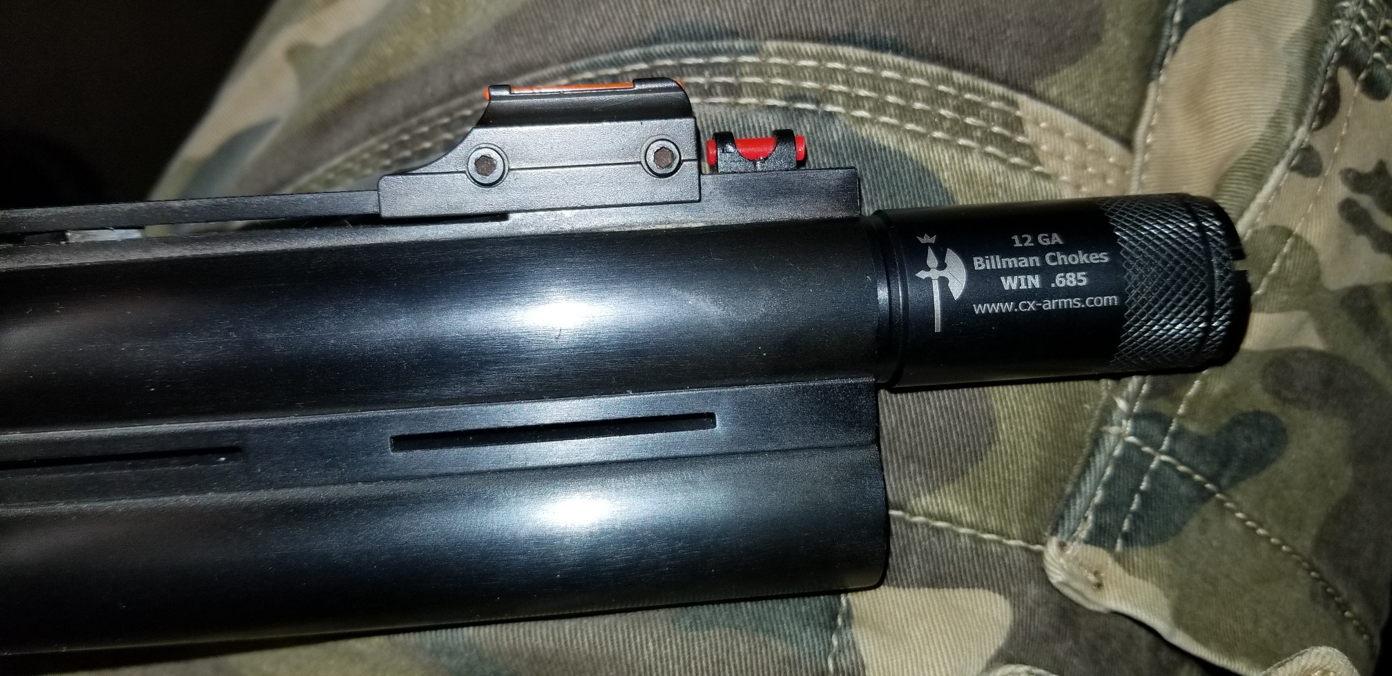

I got the .685" choke installed in the top barrel yesterday but it was a hell of a job :-)
The last part of the thread was left "high" to allow for a tight hand fitment, but I think it was a bit over the top.
The seller in Sweden has been amazingly helpful though, even offering to send me another set for free if I can't get these installed. I don't want anything for free, but I have also ordered their turkey choke. Although it's the same .685" restriction as the full-choke, it is ported which may aid in reducing felt recoil.

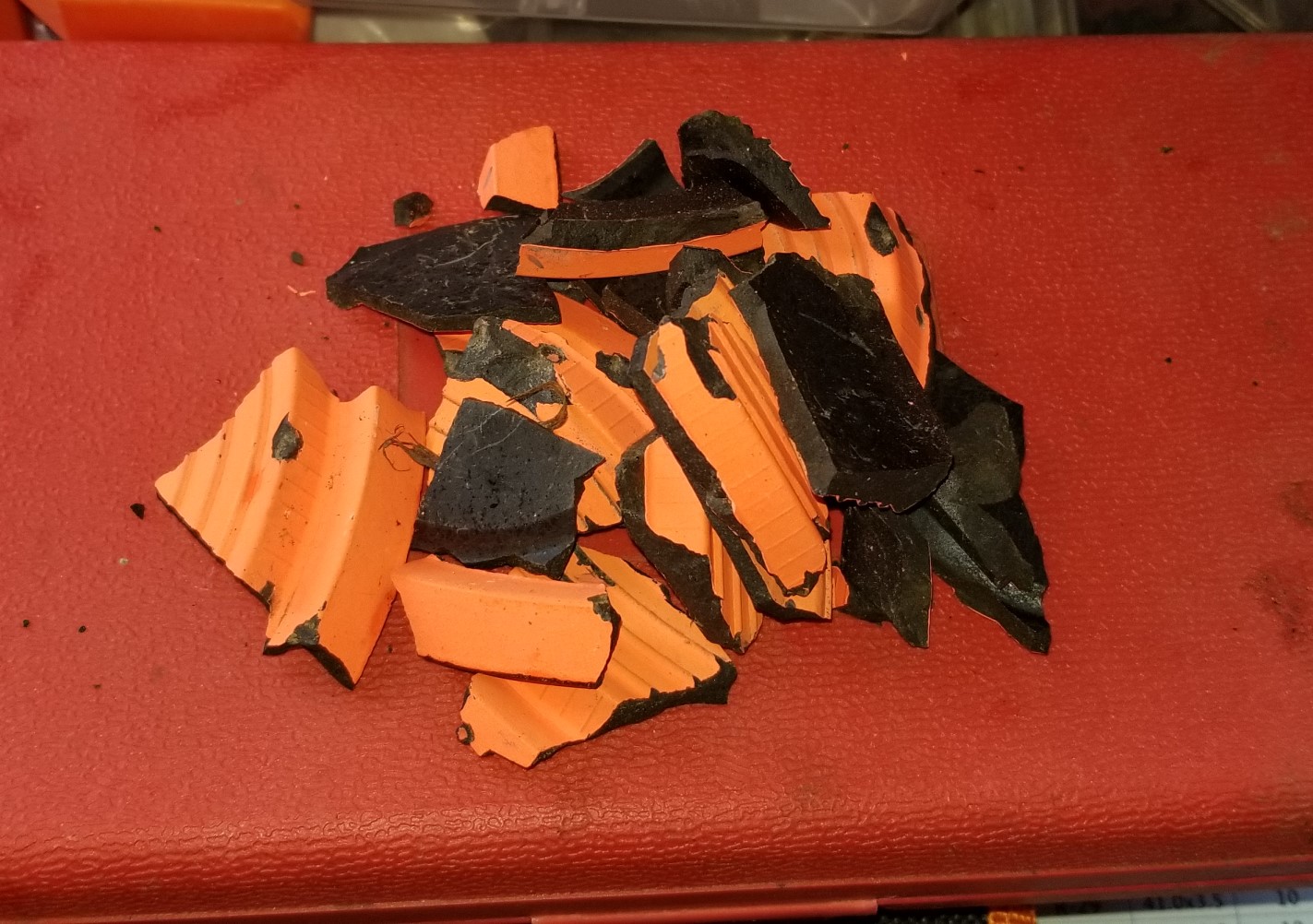

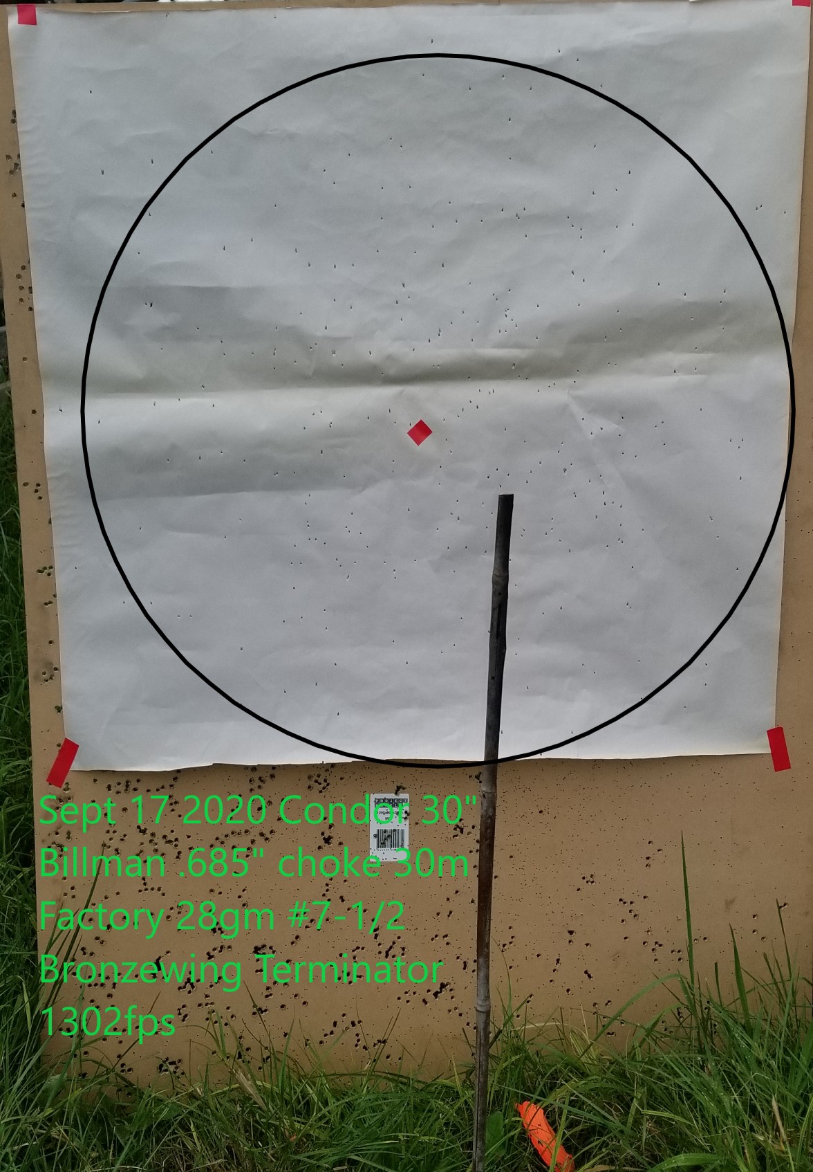

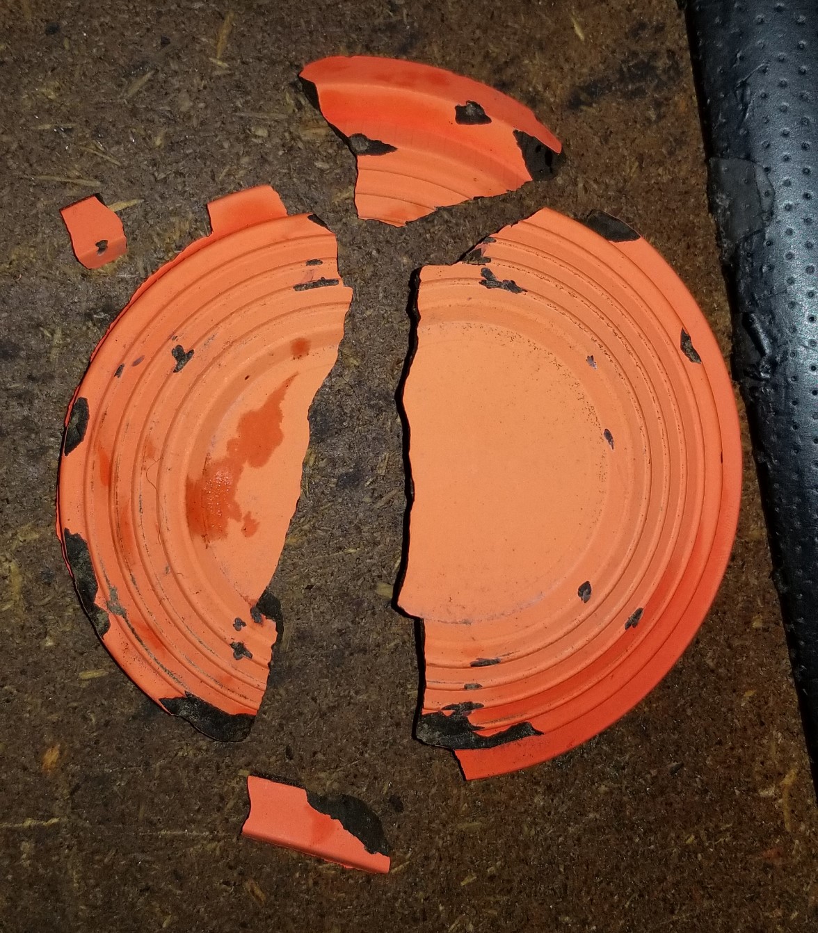

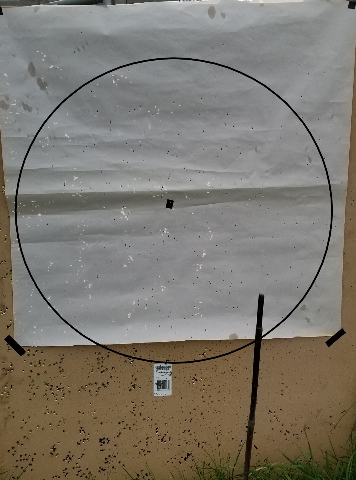

At 1302fps, a factory Bronzewing Terminator 28gm #7-1/2 patterned nicely through this choke, and finally broke the clay!
It didn't exactly destroy it, just broke it into a few pieces, although it did vapourise the edge of the skirt.
I think the pattern is dense enough that I can try reducing the payload and see how that patterns.

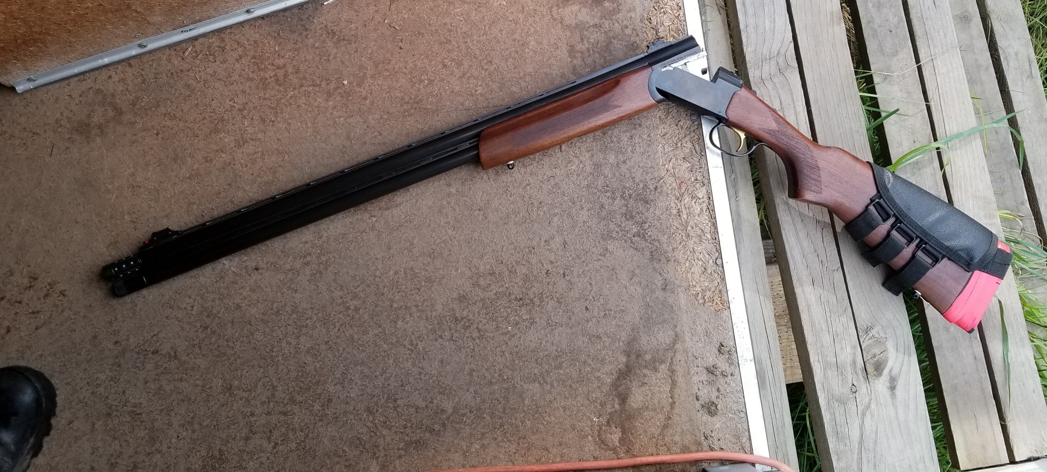

Even better, the doubled-up buttpads definitely made the gun much easier on my shoulder, so thanks for those tips. I didn't even find the extra length of pull to be a problem. I'll have to put a box of factory loads through it and see how I feel afterwards.

That pattern doesn't look too bad.

Yes, but that is a full one-ounce load. My shoulder does feel it, a sort of gentle ache right now, down to my elbow, up into my neck and my chest in between, but tolerable. Last week I was getting very sore so I took a break from the 12ga. testing.
I did look at it as the buttstock does have a hole for the bolt to pass through. It's not very voluminous though so I didn't think it'd be significant without drilling at least two more large holes above and below it. I'm waiting on another soft buttpad still, one that encapsulates the buttstock. I'm thinking with that wrapped over the two very soft pads already on there it should make it even better. While I'm doing that I think I'll try some lead shot in the butt as well. With the three buttpads, and the extended chokes on the 30" barrels, a bit more weight at the blunt end might help with balance :-)

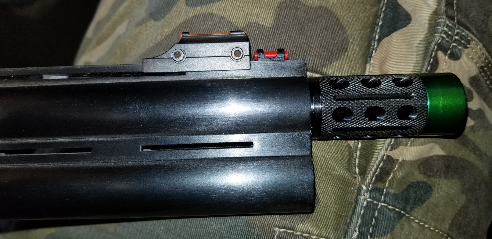

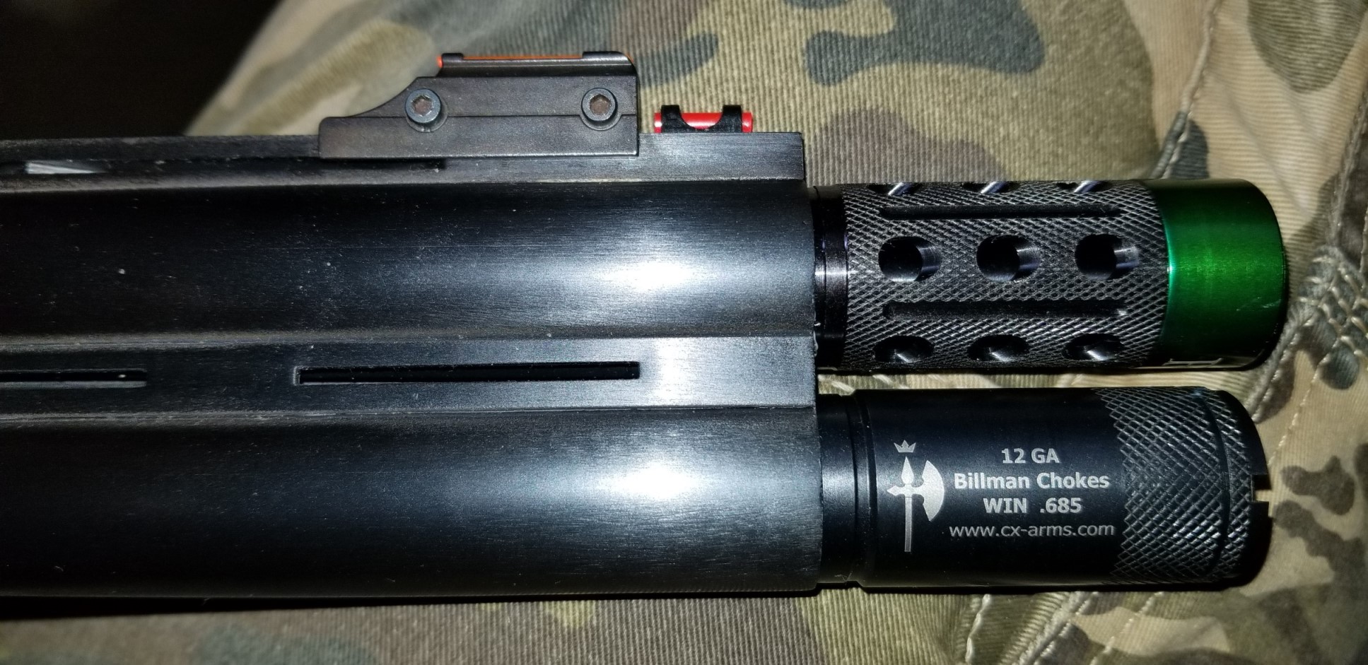

Received the ported "turkey" choke today (six days again from Sweden - OzPost could learn heaps!).
The Billman full-choke - .685".
The Billman Extended Ported Turkey choke - .685" also.
With the full-choke installed in the lower barrel for comparison with the ported choke (it's not fully seated yet).
The ported choke indexed just fine, although being symmetrical it has a decent chance of being pretty close to one of the six positions (to direct gases out to the sides rather than straight up or down into the side of the other choke tube).
Way too windy today for patterning, but I might have a few shots just to see if it makes any noticeable difference in felt recoil.

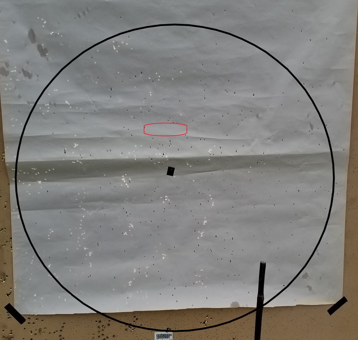

The pattern with the factory Bronzewing Terminator #7-1/2 28gm load looks very good - 1294fps.
The white "holes" are just light shining through bullet holes in the MDF.
And it even destroyed the clay :-)
I can certainly feel that I've just fired six shots, but it's fairly tolerable due to the doubled soft butt pads, as most people suggested, softening the butt pad is a great place to start in recoil mitigation. Current weight of the gun is 4.14kg (9.13lb) - 470gm heavier than OEM - and balance point is right at the hinge-pin. Length is 1265mm or 50" - 4" longer than OEM, and now the longest firearm I own (5mm longer than the M96 Swede). I'll try adding some weight with lead shot as well.

I strapped 3.4kg of bullets onto the buttstock and fired six quick rounds of factory ammo.
Very nice, but not very practical I'm afraid at 16.5lbs :-)

bladeracer wrote:I strapped 3.4kg of bullets onto the buttstock and fired six quick rounds of factory ammo.
I forgot to mention, the gun with all that mass at the back of it swings significantly faster and easier. Bringing it up to the shoulder is more effort, but once it's seated there the weight acts like an anchor and the gun simply pivots around it, very surprising. But the ballast is as heavy as the entire OEM gun was so it doubles the weight overall. It is certainly effective at reducing the recoil though.

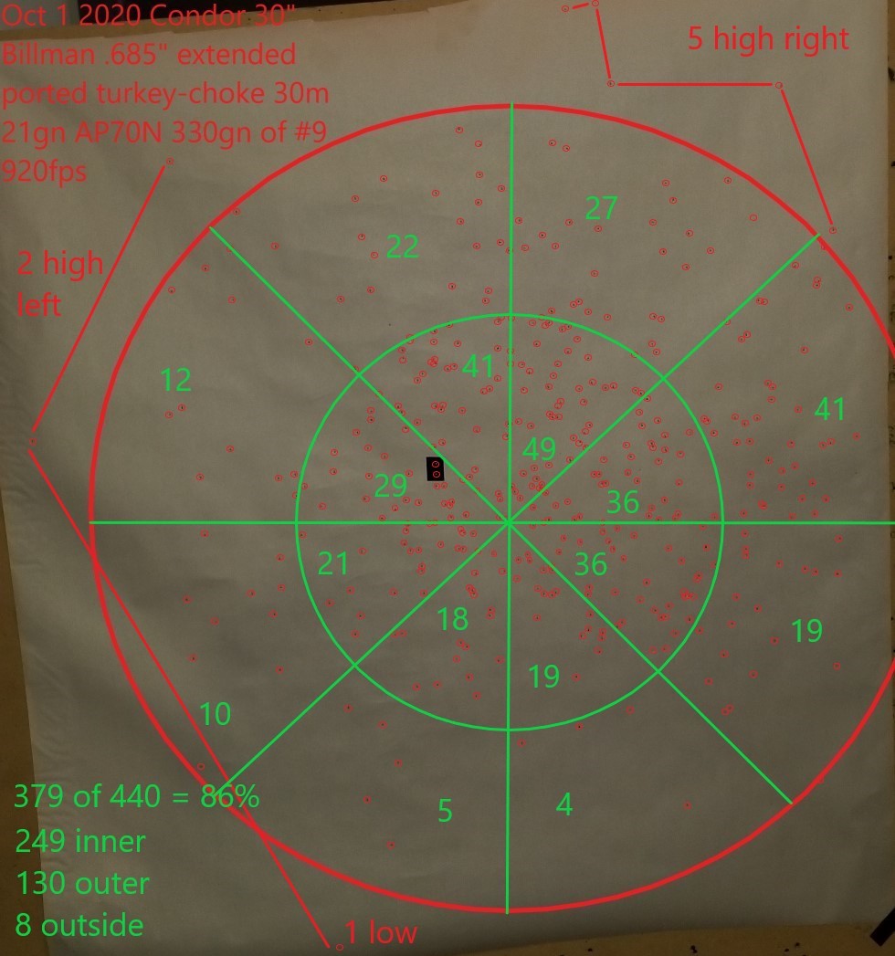

I patterned a reduced load this arvo through the .685" extended ported turkey choke.
21gn of AP70N under 330gn of #9 shot - 920fps and very comfortable indeed, I felt nothing at all, partly due to the three butt pads stacked up :-)
Tomorrow will tell me how I went if I'm aching or not.
Pretty happy with the pattern.
I weighed ten pellets at 7.48gn and twenty pellets at 15.06gn, giving me about 440 in the 330gn (3/4oz) payload.
379 or 86% of those hit within a 750mm circle at 30m, 249 or 57% within a 375mm circle. I have no way of measuring the length of the shot column at 30m, but if I can put the centre of it over the clay I should have plenty of hits, especially if it's going straight away from me. Only about 60 pellets either went through other holes (and there are a number of tight clusters that do indicate that likelihood) or were well outside the 750mm circle (52 of them so far out as to miss the entire 800mm-wide sheet).
I split it into segments to make counting easier. The pattern tends to be heavier in the upper right quadrant, I'll have to pattern some more and see if that's a constant. Half of the outer pattern is weak, with between four and twelve strikes, but the centre is dense.
I've ordered two slabs of some factory 24gn loads to test also, I think they'll be too hot for sustained shooting but are always handy for friends to enjoy.
