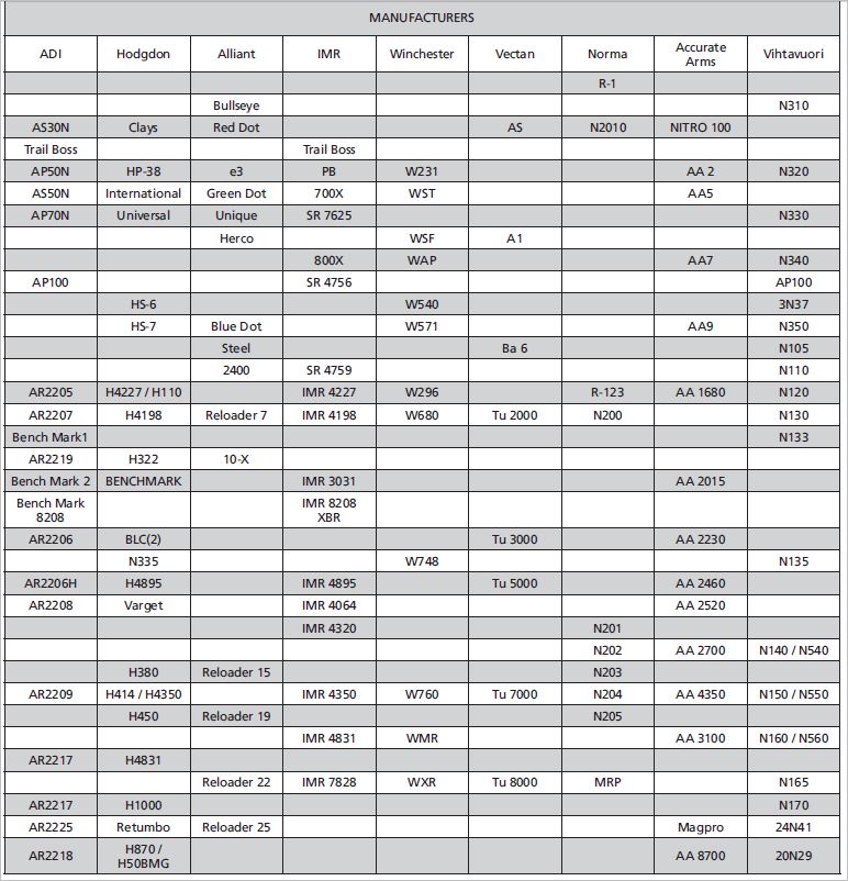

I've collated the data for the Winchester WAA12SL 7/8oz wad as that's what I'm using, and I've separated those data by powders.
ADI Shot data WAA12SL wad.JPG (93.93 KiB) Viewed 11473 times
Working with AS50N, the charge varies from 19.0gn for an 1180fps 1oz load up to 22.5gn for a 1400fps 7/8oz load.

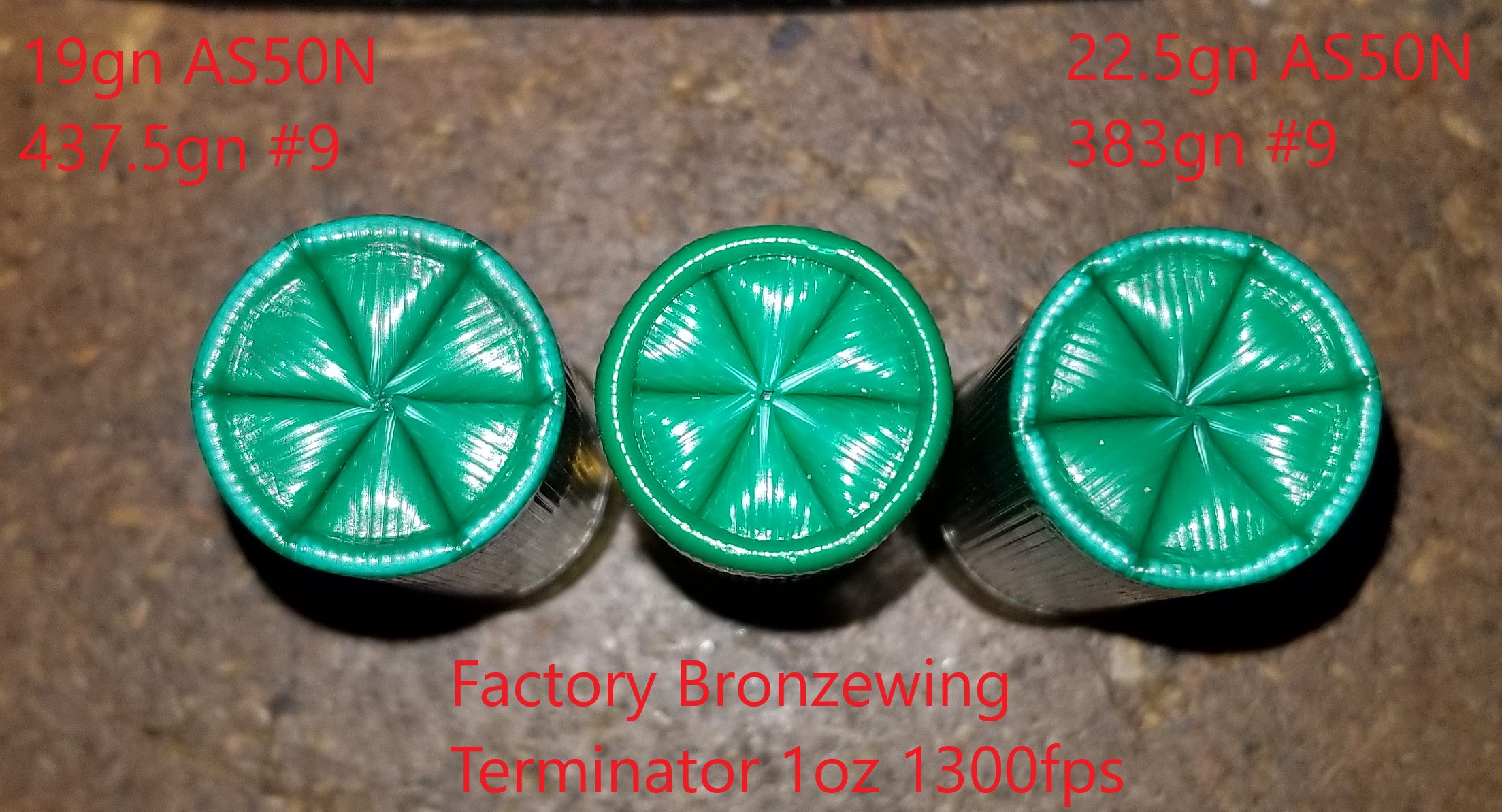

The 19gn 1oz load crimps to 2.316" overall.
The 22.5gn 7/8oz crimps to 2.307" overall.
The factory Bronzewing Terminator 1oz (#7-1/2) 1300fps is 2.243" overall, but obviously all the components (primer/powder/wad/shot) are different.
I really put some weight into the crimps this time though, and they look good. Hopefully I can chrono and pattern them tomorrow.

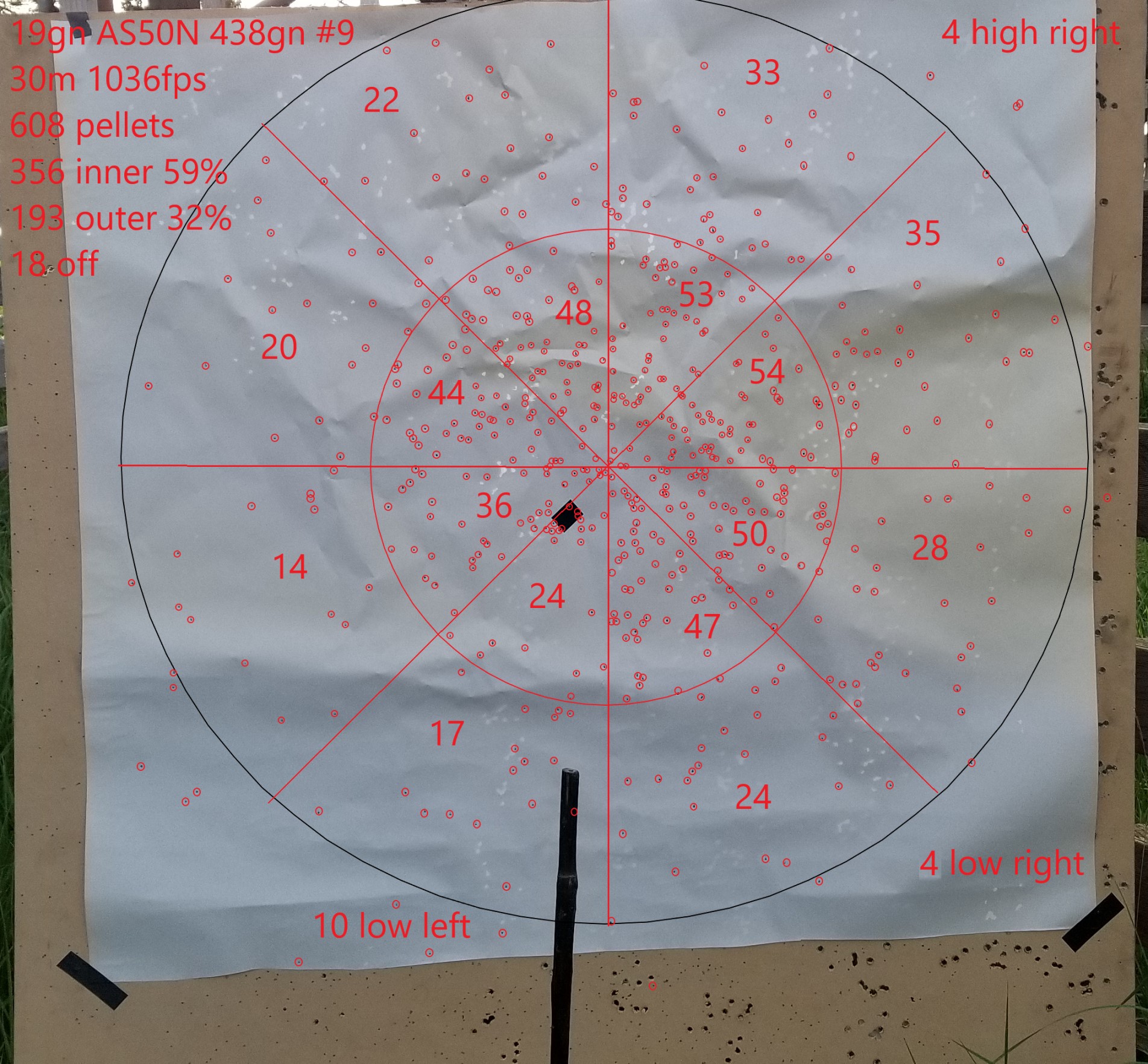

Managed to test these two "standard" loads this arvo, in the Condor 30" with .685" turkey-choke.
19gn of AS50N behind 1oz of #9 made 1036fps - ADI expected 1180fps, so well short.
Pattern is good with 90% of the pellets inside the 30" circle at 30m, and 60% within the 15" centre. I didn't crop the pics as much so I could count any pellets out on the MDF. Only about 40 of the 608 pellets are not on the board at all, were deflected by the clay, or went through other holes. But it barely damaged the clay. The hole in the pattern just left low of the aiming mark where the "24" is, is where the pellets were deflected by the clay (i'm just sitting the clay on a bamboo stick). I think it must've taken plenty of hits, between ten and twenty.

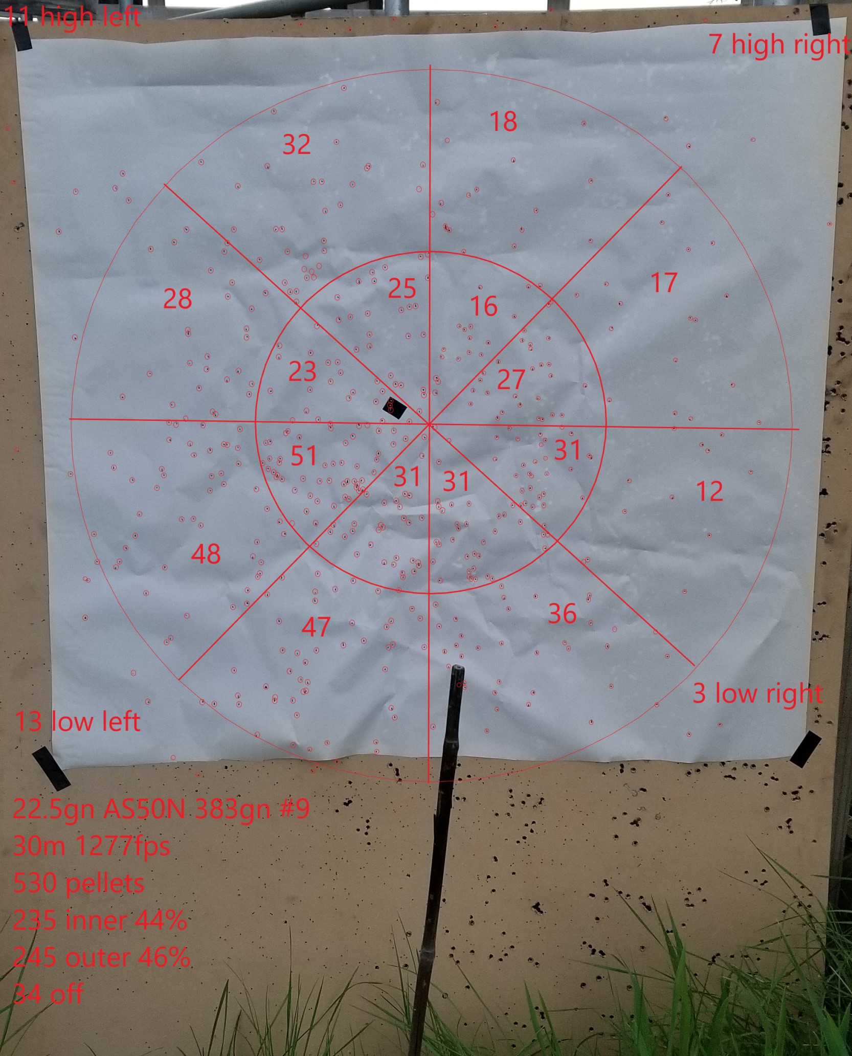

22.5gn of AS50N behind 7/8oz of #9 made 1277fps, ADI reckoned on 1400fps. I left my chrono out last night so it may have gotten some moisture on the sensors perhaps. Again, 90% within the circle, though split evenly this time between inner and outer, which is probably preferable for most clay shooters I'd guess. Only about 15 pellets missed the board or were deflected by the clay.

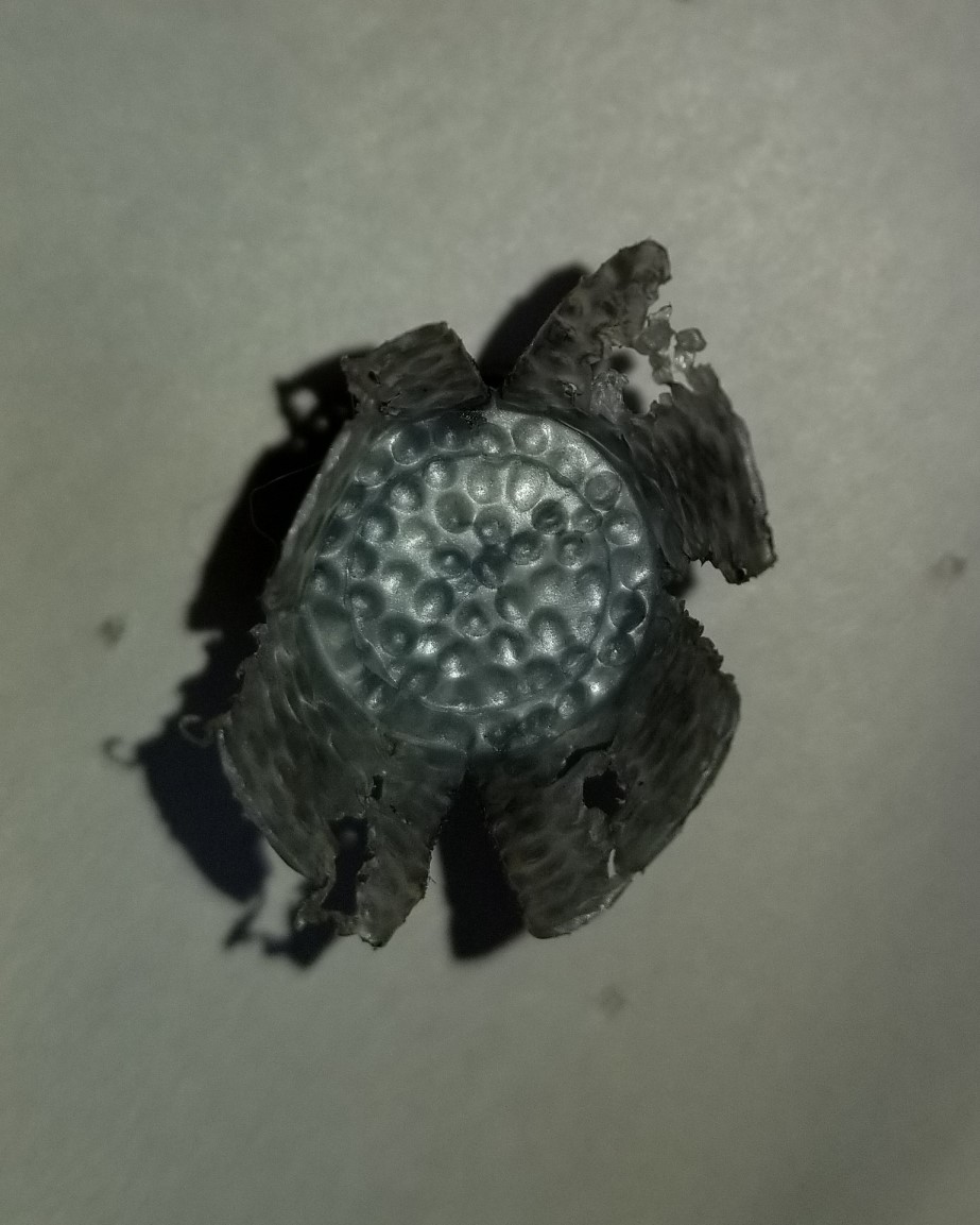

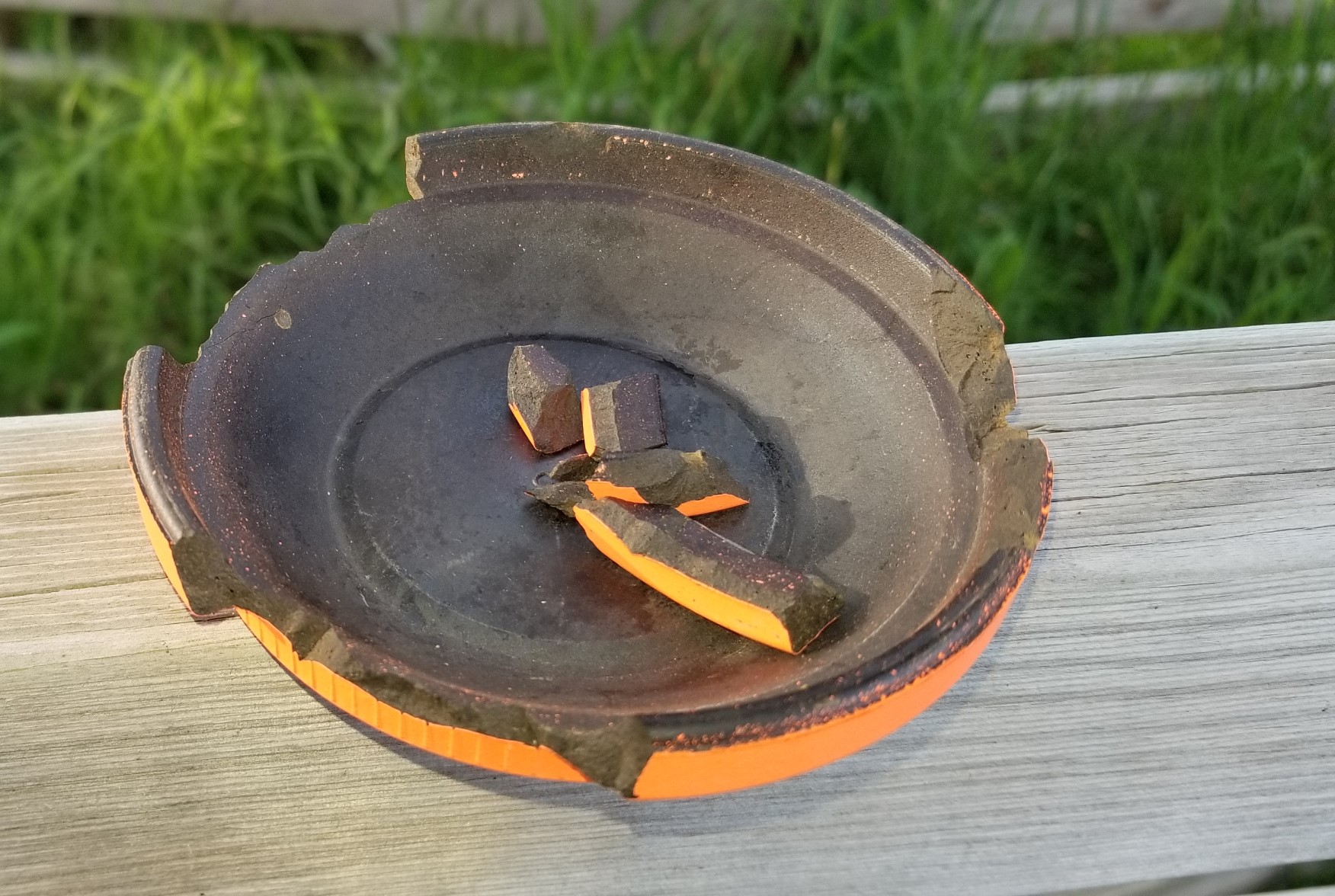

This time it totalled the clay, the extra 240fps velocity must make a major difference. This time the clay was in the hole just low right of the aiming mark.
And it's really tearing up the wads today.
My MDF is taking a hammering, this is the back of the sheet :-)
And we've had six of these so far this season :-)

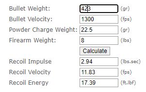

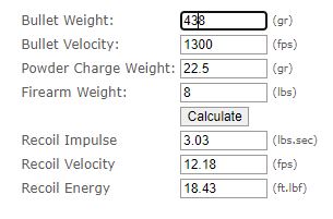

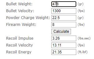

I also discovered something that might explain partly why the recoil calculator under-rates shotguns.
The plastic wad is 40gns. Adding that to the 438gn payload increases calculated recoil by more than 15% in a 1oz 1300fps load. It might even be more if a 1oz wad is heavier than these 7/8oz wads.
12ga 1oz recoil without wad.JPG (19.55 KiB) Viewed 11432 times
12ga 1oz recoil with wad.JPG (19.21 KiB) Viewed 11432 times
In a 7/8oz load it's closer to 20% more recoil when you include the wad.
12ga 7-8oz recoil without wad.JPG (19.23 KiB) Viewed 11432 times
12ga 7-8oz recoil with wad.JPG (19.32 KiB) Viewed 11432 times

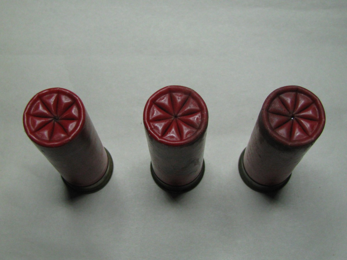

Crimps - yours look quite good bladeracer, here are some examples of some of mine, off the MEC 650. Win AA Compression Formed hulls, which were always the gold standard for good crimps.
The slight 'swirl' can be adjusted out, BTW, if you want to be that 'anal retentive'. :lol:
Do you have the OEM manual for your press, assuming it's a MEC?
That covers the finer points of crimp die adjustment - I think have PDF's of the 600Jr [Pre 1985 and Mk V], and 650 manuals, if you need those.

Mine are six-point crimps, but I've read that the eight-point is easier to get right? When I start on my new hulls I'll try those with eight-points. I'm using the Lee Load-All II, but I'm only using it to size, prime and crimp. I don't need to roll out dozens of shells, even a Lee Loader would be great if I could find one. Do you know of a device just for star crimping shells?
I think the problem I'm having is that I'm not stacking the load high enough, so when I compress it it goes under-size and the crimp falls in. Although I've also been stacking some too high and barely getting a crimp to lay flat :-)

Don't worry too much about what they chrono at.
It is more important to get the pattern density good.
Remember that speed can open shotgun patterns.
24 grams is 7/8oz. Slower is less recoil.
What you are striving for is an even spread of shot without holes big enough for a target to fit through. If you handload you will find that the wrong load can easily put 2 big holes in a pattern. 1 as the wad flies through the shot column on exit and another as the wad slows down and the shot strikes it. Donut patterns are also a popular choice. :-)

Post by Oldbloke » 11 Apr 2021, 4:03 pm
Blade racer. This might help you. See bottom of page attached.

Re: 12ga. reloading
Post by bladeracer » 11 Apr 2021, 4:56 pm
Oldbloke wrote:Blade racer. This might help you. See bottom of page attached.
Youth Loads AR2206H = H4895.pdf
Bugger, I thought you'd discovered AR2206H shotshell loads :-)
I'm only interested in using ADI powders.
I already use AR2206H way below those levels in rifles.
Re: 12ga. reloading
Post by Oldbloke » 11 Apr 2021, 4:59 pm
:unknown: Did you look at the 12g loads?? :unknown:

Re: 12ga. reloading
Post by bladeracer » 11 Apr 2021, 5:18 pm
Yes, they're for Clays and International powders, not ADI.
Re: 12ga. reloading
Post by Oldbloke » 11 Apr 2021, 5:37 pm
Blade, you could consider trying some of the ADI equivalents.
ADI Equivalents.JPG (134.84 KiB) Viewed 10629 times
