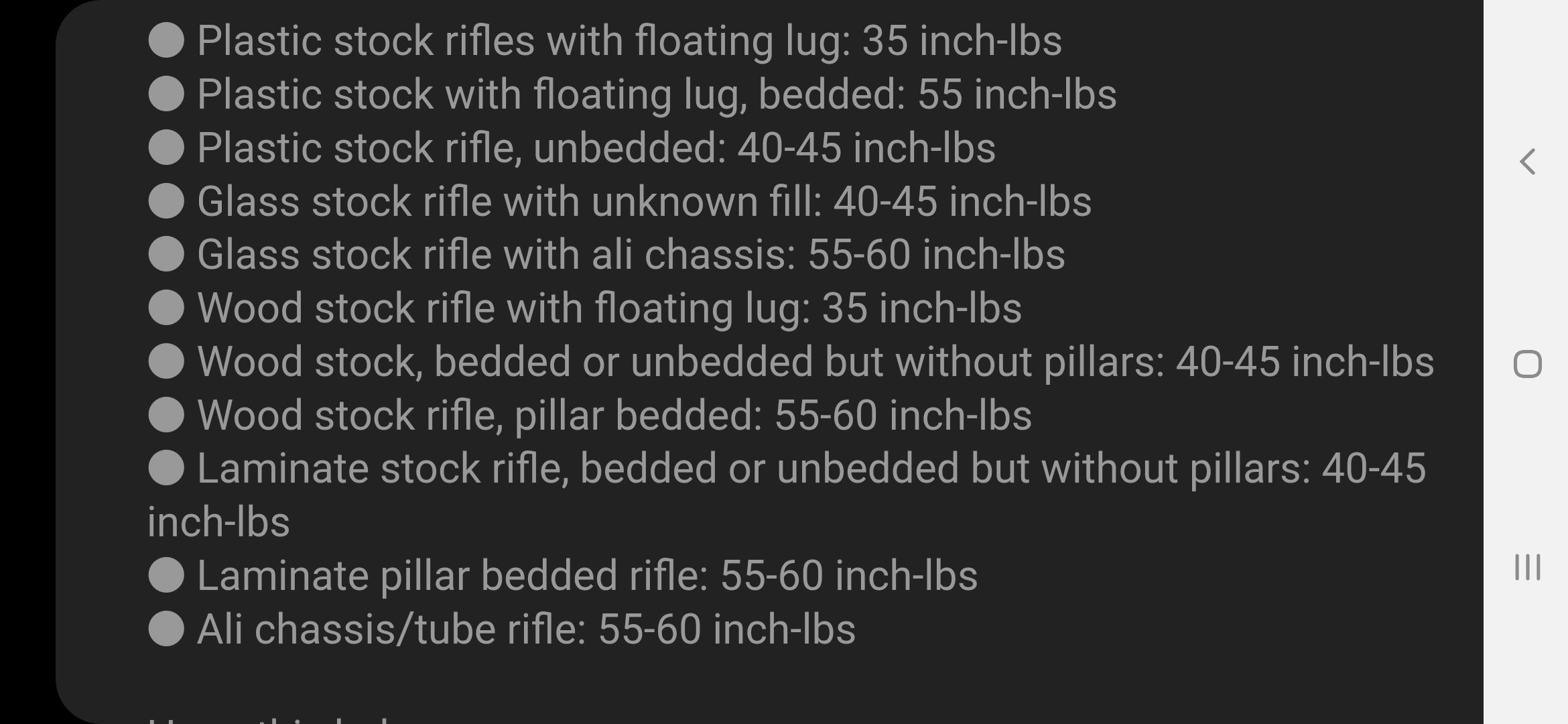

Help needed on the screw torque settings for a Brno #4 58 model, heavy barrel in a Boyd's Laminated stock

Jeff wrote:Help needed on the screw torque settings for a Brno #4 58 model, heavy barrel in a Boyd's Laminated stock
In a Boyd stock I'd keep it light unless you've put pillars in, laminated timber is very easily crushed.

These were some values I found on another forum once. You can use them at your discretion. Ask 10 people you will get 10 different answers but it gives a good ballpark to work from.
Screenshot_20191126-133505_Samsung Internet.jpg (422.69 KiB) Viewed 2526 times
