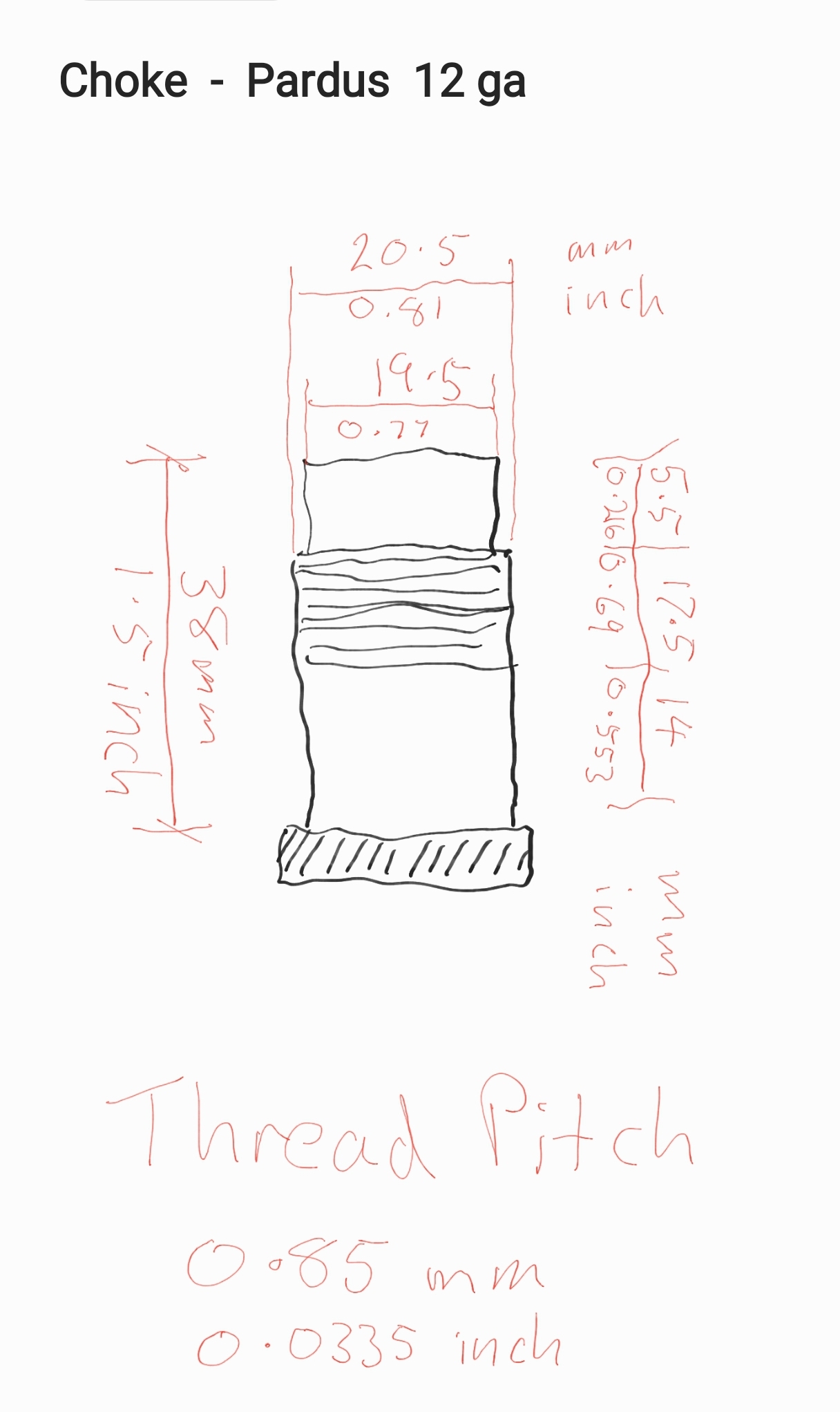

I've got a Pardus LAX12 Marine and I'm trying to find out if the chokes are compatible with any other brand of shotgun. There's plenty of rifled chokes around but nothing listed or mentioned for the Pardus. There's even one listed for the Adler but I can't find any compatibility information.

Measure the thread diameter and pitch of your choke if you can't find specs for it.
I would expect it to be the same as other Turkish guns though. See if you can try chokes from some other guns.

I've attached a diagram with the measurements of my Pardus choke.
If someone could measure their choke and see if it matches I'd really appreciate it.
I'll send the diagram to Carlsons as well and see if they can match it up.

Hi mate, did you end up resolving this because I am looking for aftermarket chokes myself for a Pardus side by side (DE 12G)? Any info on which chokes fit your Pardus would be beneficial to me finding some for myself, cheers
