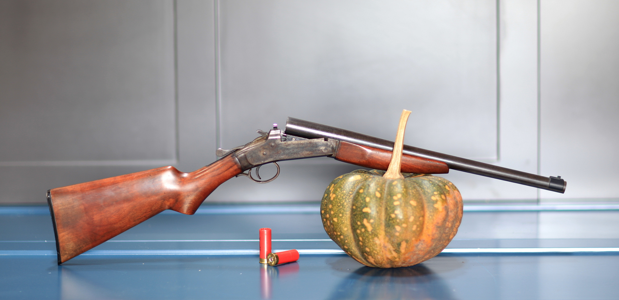

Post by SHV » 18 Feb 2020, 7:28 pm
always like peep sight

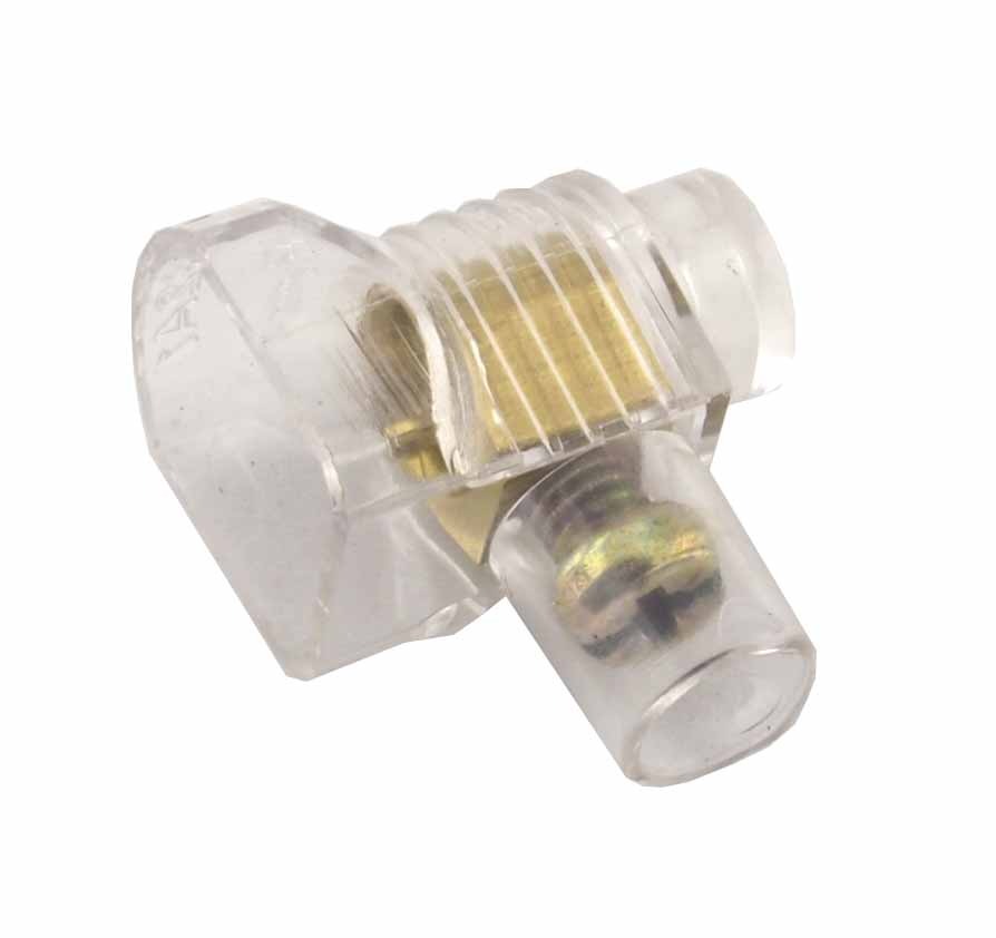

after cut 30 inch barrel to 20 and thinking maybe use slug for hunting, I got this in my hand, a connector...

the metal parts fit in the deep screw hole on the action perfectly so now I have a shotgun with peep sight :lol:

it fits there very tight, need shorten the screw length and the base of the ring part to make the rear peep sight height as low as possible, just need a fill and 5 minutes, easy job
after install it is really solid no movement at all but still put a little AB glue to secure

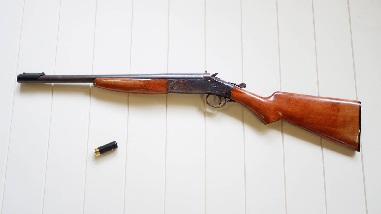

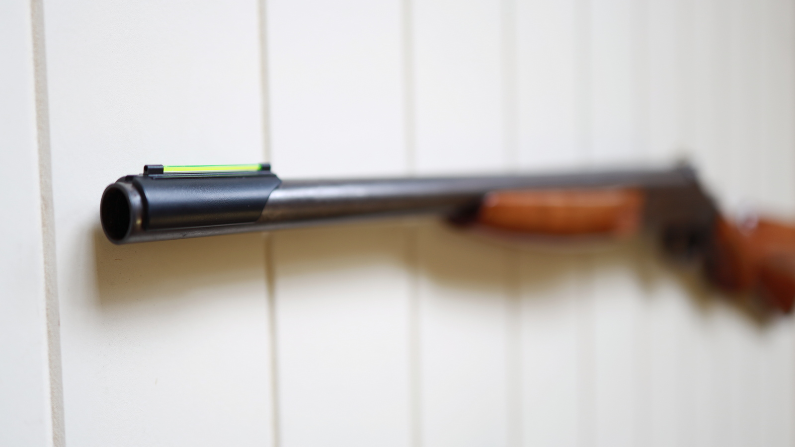

front sight is truglo universal 12g sight, easy to adjust windage

Post by SHV » 18 Feb 2020, 7:51 pm
the peep sight is not on the end of the barrel, but this old girl (made in Japan) lockup very tight, should be alright
the ring size fits the purpose perfectly, just like some "combat" sight on rifles, the sight picture is big and still provide good reference for aiming

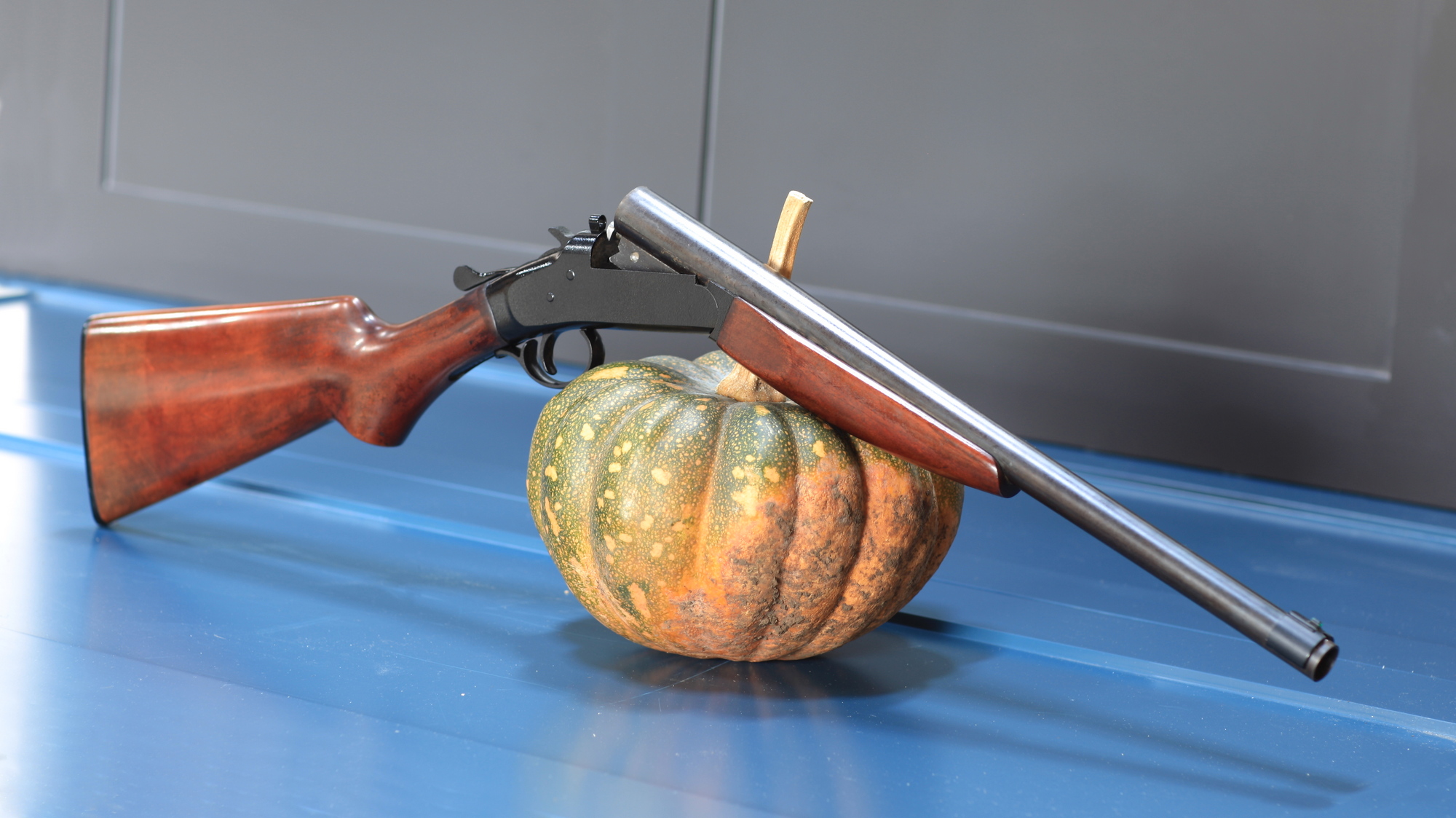

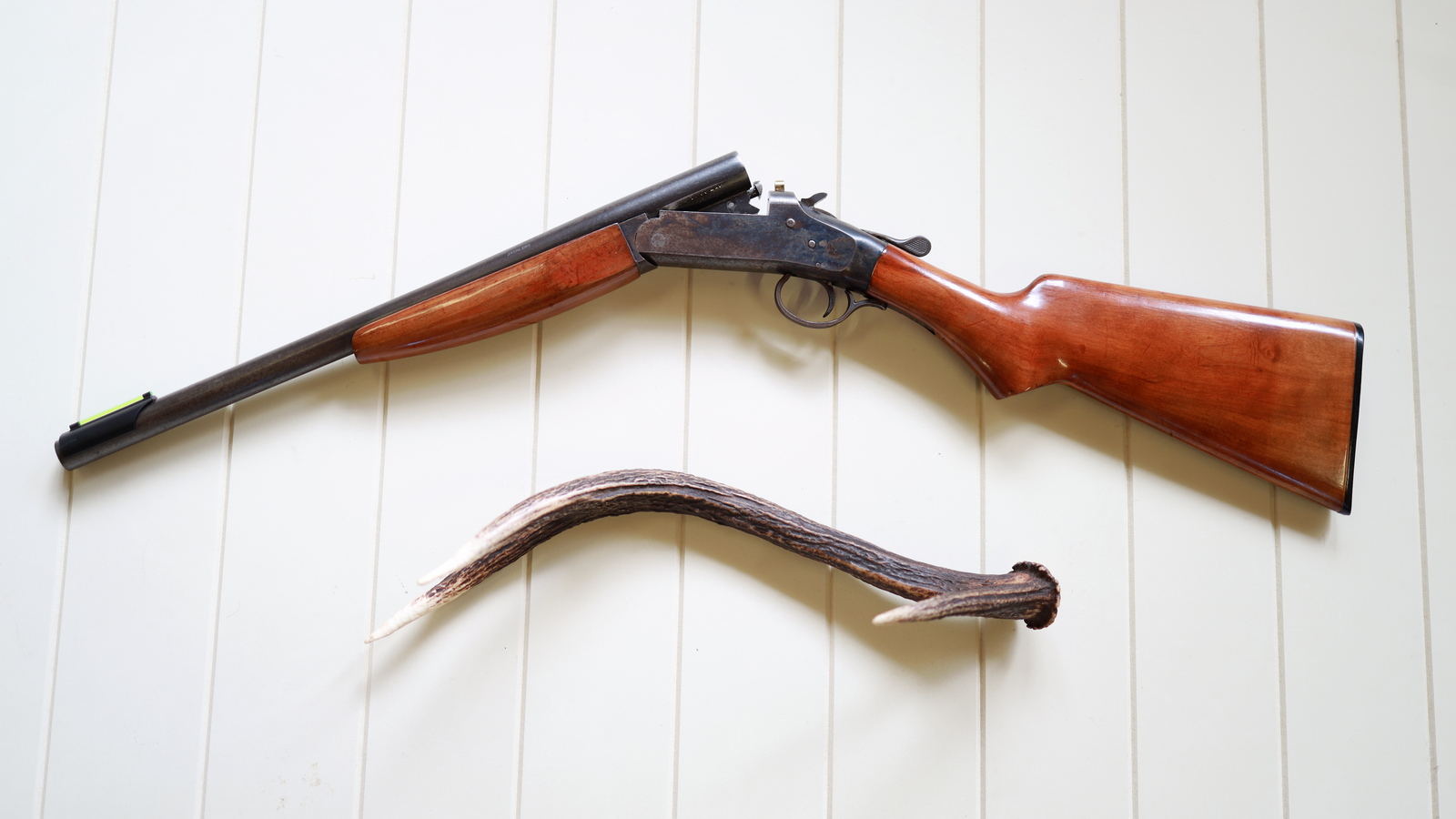

Post by SHV » 29 Feb 2020, 10:04 pm
my "new" “tactical” single barrel break action shotgun :lol:

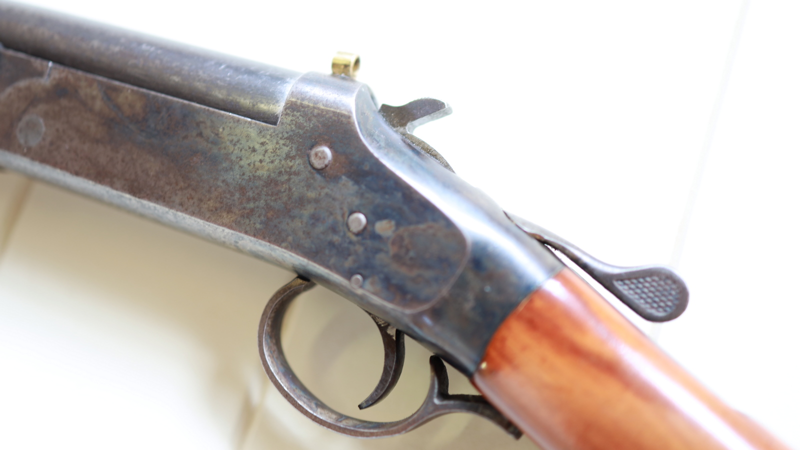

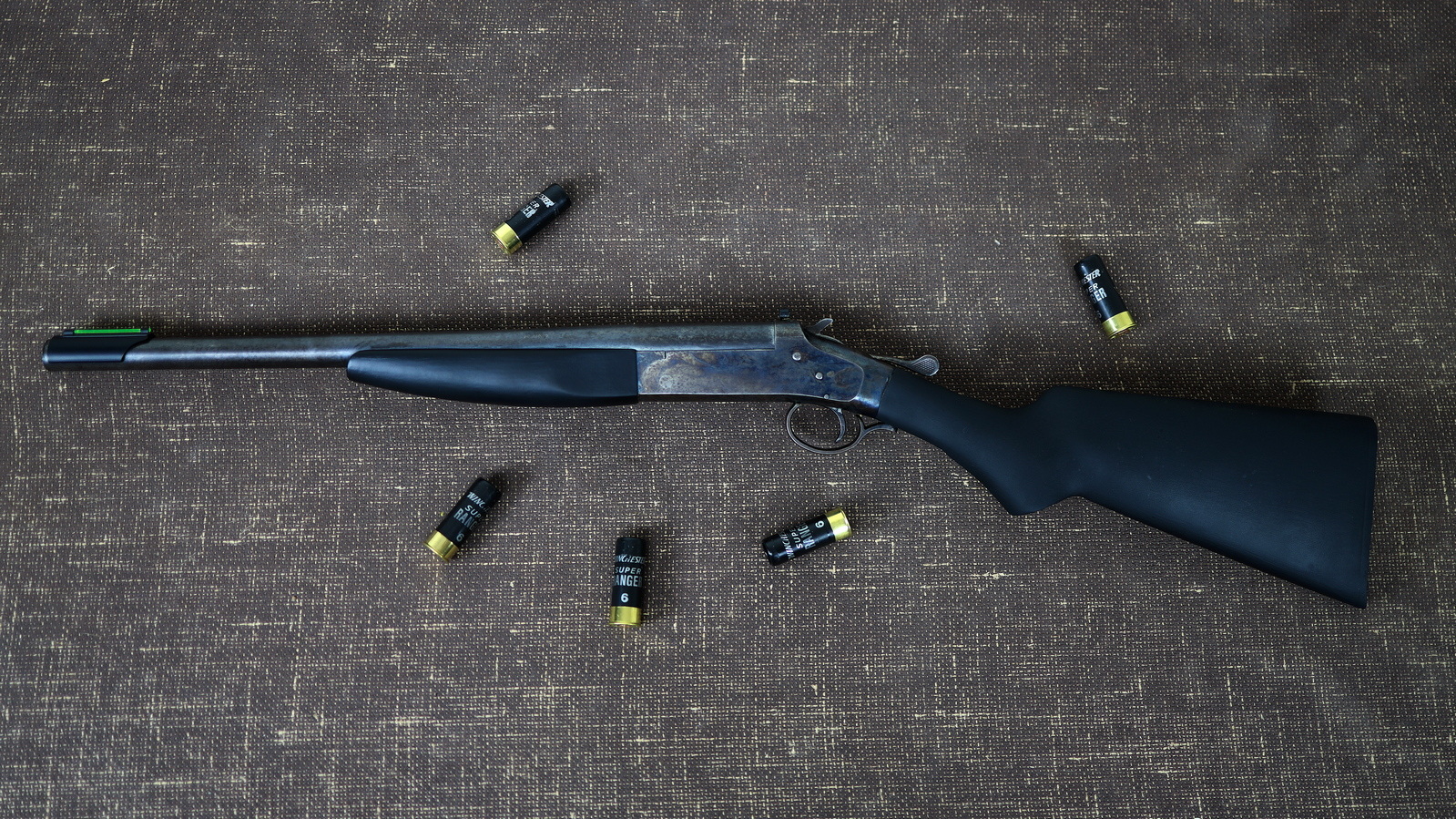

Post by SHV » 23 Jul 2022, 5:59 pm
the receiver finish looks a little ugly
SHV
Posts: 1780

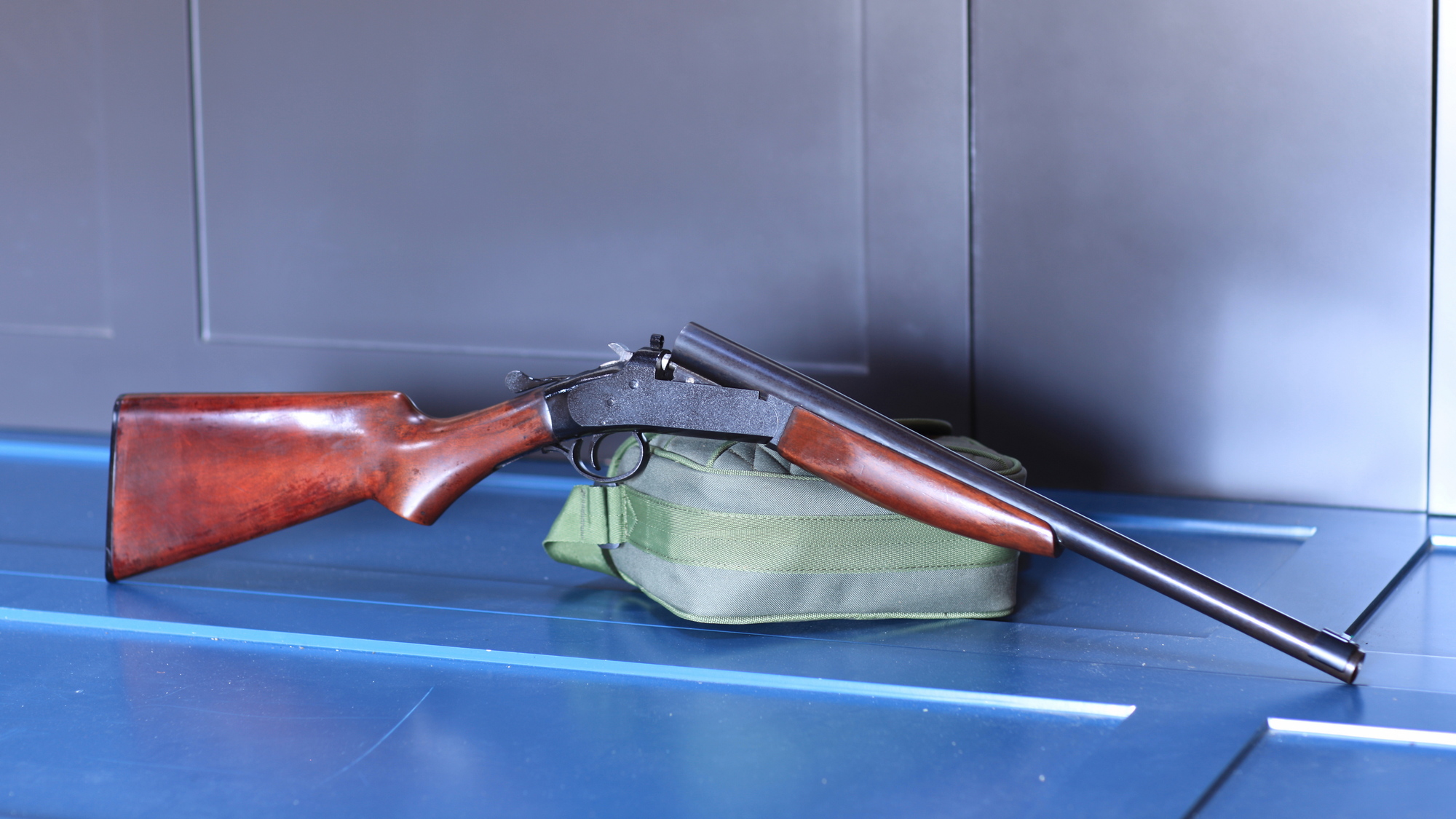

Re: DIY peep sight for my shortened single break barrel 12G
Post by SHV » 23 Jul 2022, 6:01 pm
spray painting dulux weathershield
SHV
Posts: 1780
Post by SHV » 23 Jul 2022, 6:03 pm
the barrel looks old now :crazy:
will try cold blue again later

Post by SHV » 04 Aug 2022, 9:03 am

Post by bigpete » 05 Aug 2022, 11:01 am
Accuracy test ?

Post by SHV » 05 Aug 2022, 11:14 am
bigpete wrote:Accuracy test ?
very accurate
20m dead on centre
