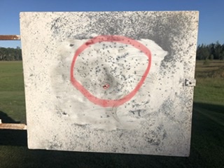

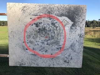

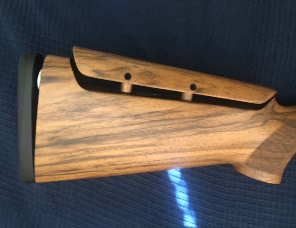

Makes me think I should’ve added picture .. This might help explain to a novice .. basically I’m aiming at the red dot, in this case standing about 25 metres away (both guns tightly choked)
My 50/50 Sporter:
50/50 shot pattern
The 80/20 Trap gun (recently I’ve setup even higher than this)
80/20 shot pattern
Adjustable stock on the trap gun .. this is setup to shoot about 90/10 now:
Adjustable stock
U can tell I’m really missing shooting trap at the moment :lol:
... so final message to the original poster .. you can read all this and analyse it to death or just buy the one that appeals to you most and get out there and shoot and enjoy it :thumbsup:
... if u have the means, buy both! :D :clap:

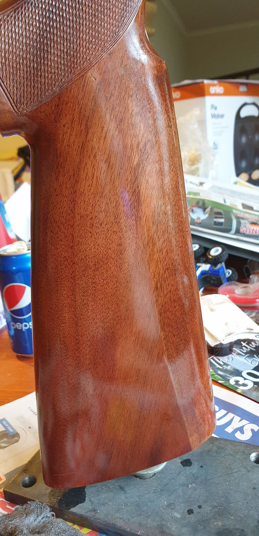

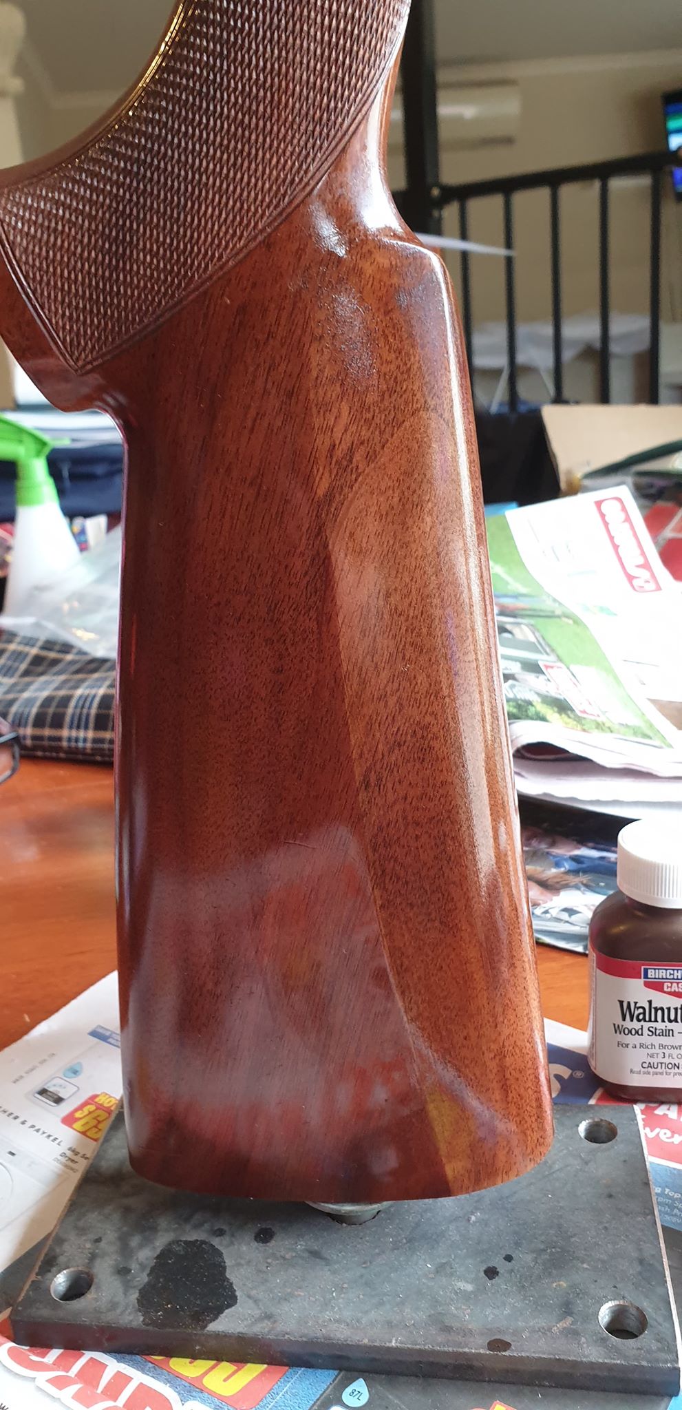

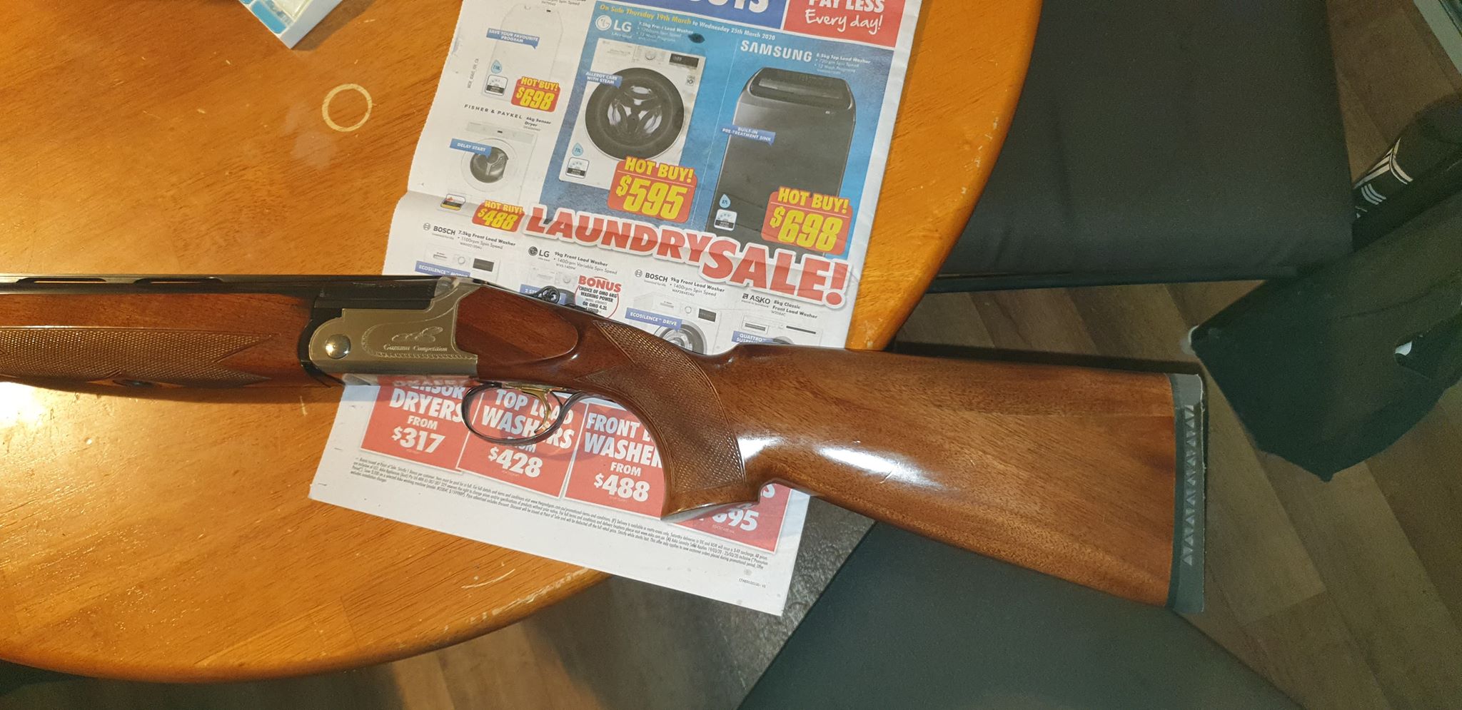

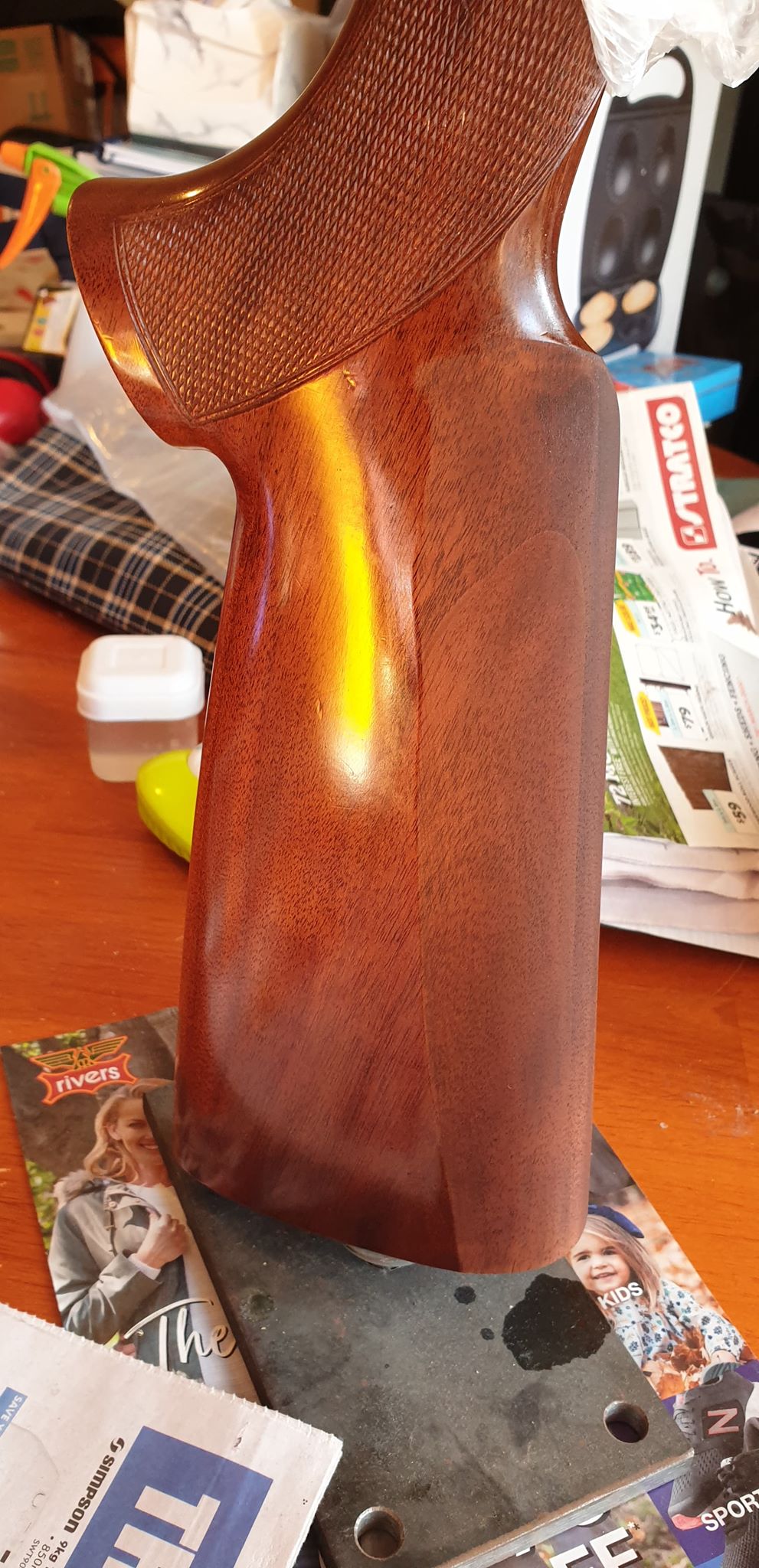

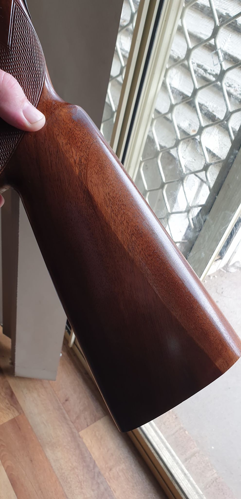

Just gone through this a bit myself, I recently bought a fabarm gamma competition, cased, 5 chokes, minimal use (my mate who owned it couldn't hit s**t with it so barely used it) now although the gun is a lovely looking, it just didn't fit me... so I modded the stock myself.
In its original shape, I couldn't get my cheek low enough to look directly along the barrels without pressing my face uncomfortably hard into the comb.
The original owner had the same problem (he since bought a miroku ML11 with high vent rib and now shoots much better)
So, I ground the top of the comb off and re-profiled the very large radius on the cheek piece.
The result is a shotgun that now comes up to my eyes way more naturally and I'm looking along the vent rib not looking down on it.
I only took approx. 8mm off the height and changed the shape to suit me on the left side of the stock, testing it for fit as I went.
I have then used a walnut stain and truoil to get back some sort of surface finish.
You can see what I've done but it doesn't look hideous... will post some photos of how it went.

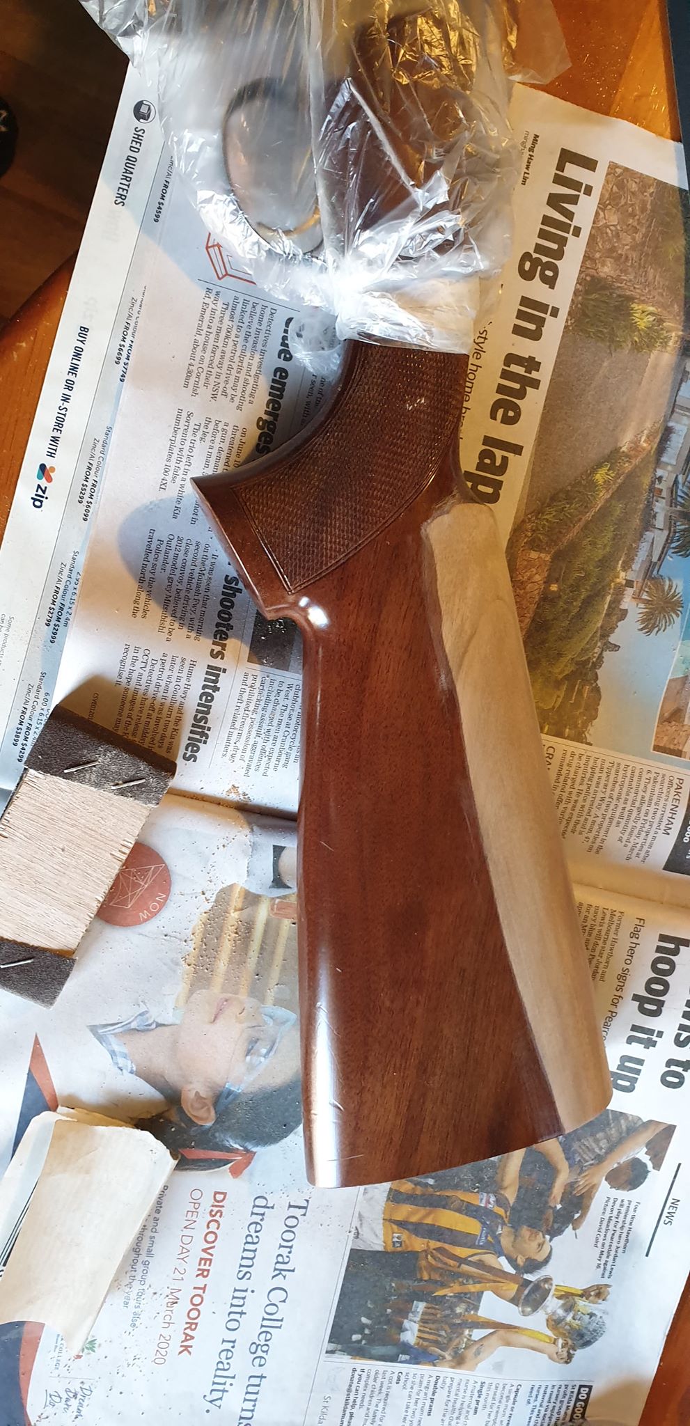

ratpaker
Posts: 57
Re: Browning 525 Trap One vs. Sporter
Post by ratpaker » 05 Apr 2020, 8:56 am
Ok, so pictures as promised
not perfect but Im happy
finished
more coats
more truoil
starting to use truoil
first coat of stain
8mm lower and thinned
ratpaker
