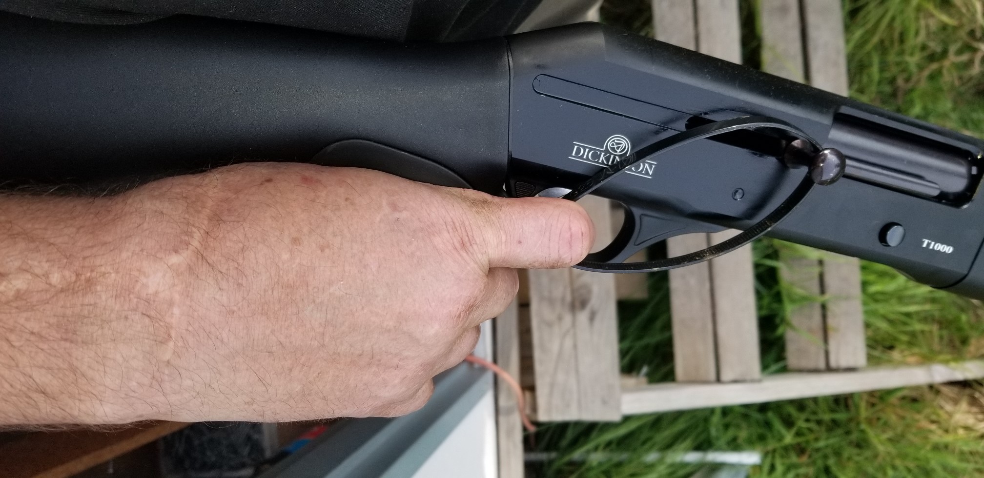

bladeracer wrote:As for left or right bolt handle, I do struggle to operate the right-hand bolt, but that's due to my own injuries and nothing to do with the gun, although the bolt handle is a long way forward of your shooting side hand either way. But shooting it left-handed I find operating the right-side bolt significantly easier than I would with a left-side bolt. I have thought about making a bolt extension that reaches over to the left side for this reason.
Just to add to this, I have experimented with a cable-tie, in about an 80mm loop, taped to my index finger makes it far easier to reach and operate the bolt handle.
The pistol-grip would also allow me to extend the bolt handle rearward about three-inches which would also be helpful.
