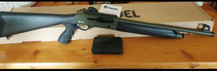

So......I just finally gave in and sold my baikal 45-70 double rifle to a mate who's been lusting after it for years,so I decided to put the money towards something completely out of left field....for me at least....
Behold ! In all its tacticool wankery goodness ! A Citadel BT3000 straight pull 12g shotgun ! All bow before the almighty and tremble in fear ! :lol:
:sarcasm:

Re: It Followed Me Home....
Post by BenniBoiBlep » 17 Jan 2022, 6:52 pm
Haha followed you home hey. Love the colours.

Post by womble » 18 Jan 2022, 2:51 am
bigpete wrote:I had a look at one of these today,and honestly surprised myself by actually liking it ! Didn't like the sights though
Well you did say you liked it
