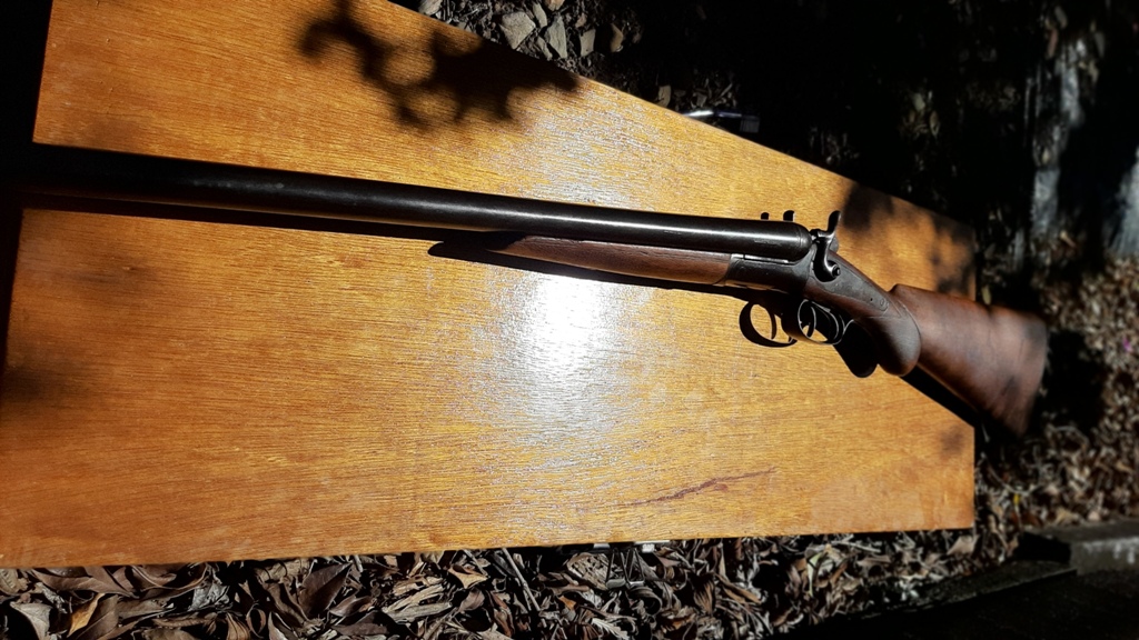

I own an old Liege 12 Gauge hammer shotgun which belonged to my father's father. (Roughly 100 years)
I'm considering selling as I have held it for the last 40 years or so and just need to know what these would sell for at a licenced dealer.
Its fully operational and in pretty fair condition. I did a bit of research and there were quite a few of these made in a couple of the Liege United Arms company. This one was apparently built in Belgium. I am hoping someone is a bit of a historian and my be able to help.
Photos attached.
Posty

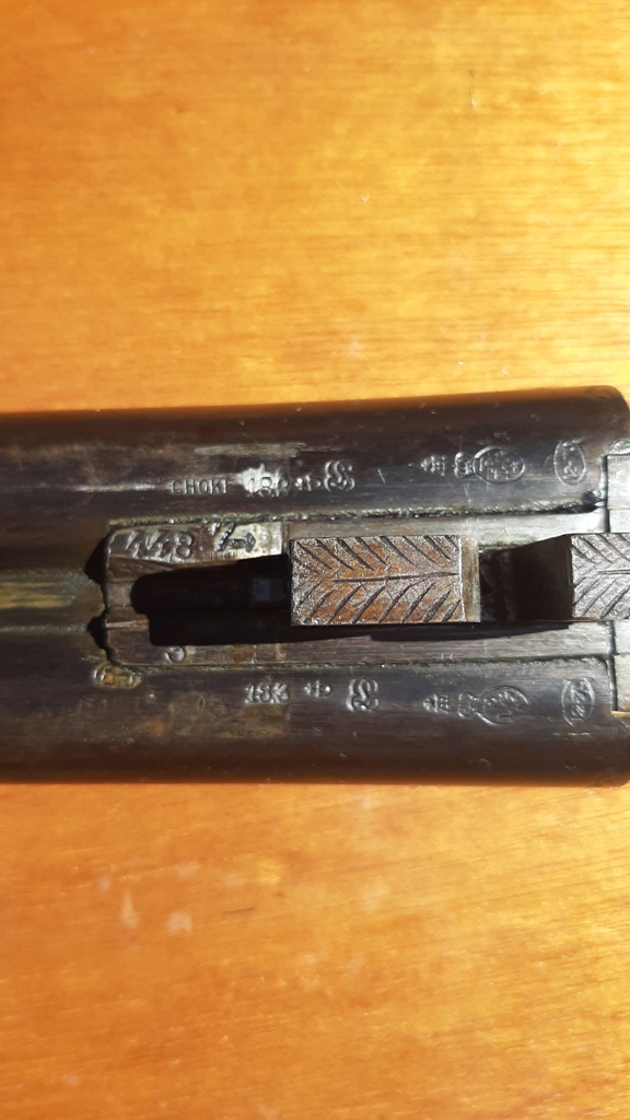

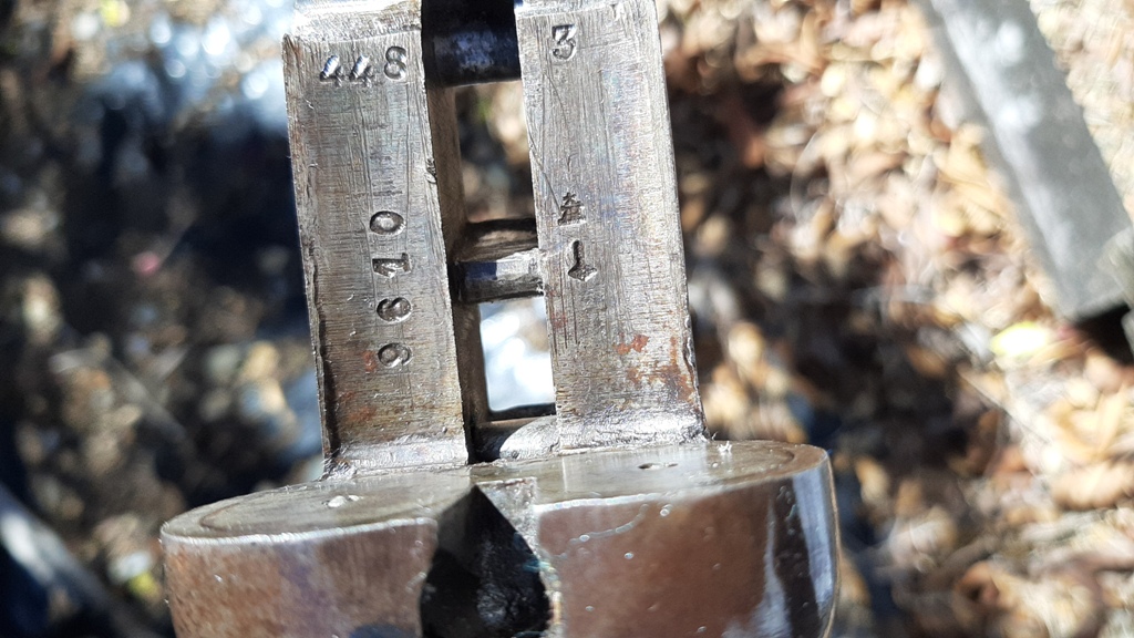

Hard to say about value but I'm guessing the sentimental value far outweighs what you'd get for it. I'd guess not very much at all. It seems to be proofed for black powder only - not for smokeless powder. That doesn't necessarily mean it's dangerous but it hasn't been tested (do a search for where BP shotgun barrels burst when firing smokeless shells and you will see why its an issue). Hard to read from the photos but there appear to be a marks reading (12-70) which might mean 12G, 70mm chambers (i.e.2 3/4").

Your gun was made in or after 1924, they were sold all around the world. I have the same make and model as yours, same era, and I paid $100 for it last month in good condition. A dealer is unlikely to offer you much more than $50 to $80, if they do then take it. A top price would be $200 retail. As for proof, these were proof tested with BP at a higher pressure than the Nitro Proof, and Nitro proofing in Belgium at the time was purely voluntary and used by makers as a selling point especially in the US, given that both Bulk and Dense Nitro loaded shotshell were in common use at the time your gun was always intended to fire Nitro loaded to the common pressures of the day which are about 2000psi under todays high pressure loads. As such, I shoot any modern shotshell in my old steel barrel guns that are loaded to 9000psi, and most light hunting loads, up to1 1/8, lead only, under 1200fps. Have the gun checked by a competent gunsmith first of course, loose ribs are a pain!
