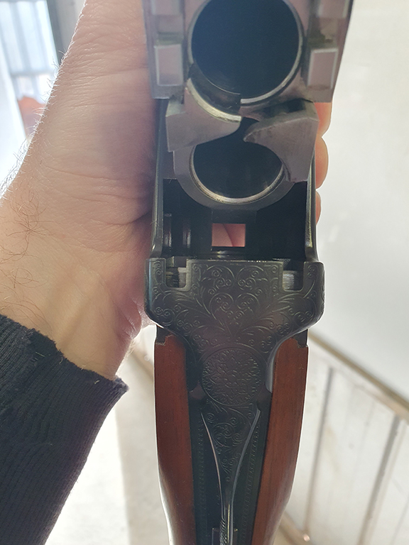

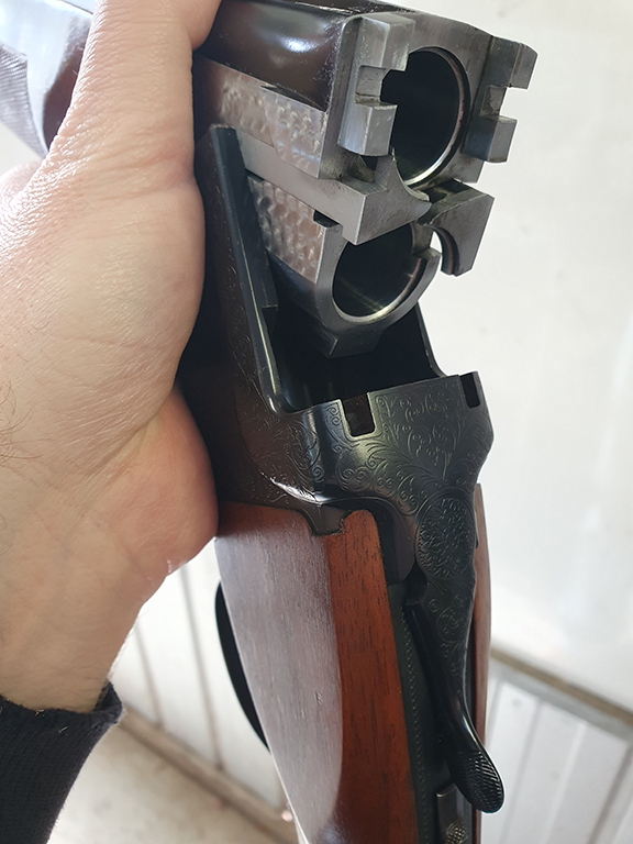

I inherited this SKB 500 O/U 12g from my Uncle/Poppa and when I first opened the case, it was quite rusty/gummed up around the locking latch.
I soaked it in some break-free and penetrene and with the help of a brass drift, got it moving until I could open/close it, then I gave it a thorough clean with penetrene, G96, compressed air and gently wet/dry sanded the "grabby" bits of rust on the lugs that I could feel when working the latch.
Now I've spent some more time cleaning it in preparation to take it out and bust some clays, I can't get the latch to close all the way when the barrels are closed. It seems to cock, eject, etc. fine but I don't want to fire it until I get this sorted. The latch goes in all the way when the barrels aren't closed..
It does seem that the barrels are fully closing but the latch/locking mechanism just doesn't go in all the way.
I'm thinking the next step is to take it to a gunsmith for a full service/clean before I go about using it.
Any other suggestions?

On a new gun, or one seldom used, the lever will not close all the way. As the action wears you will notice the lever move more towards center.

It's normal. Yep, as No1 says. My SKB still did it for many years but is closer to centre aligned now.

Normal, my 1950's Browning is now noticeably "left of centre" and it locks up solid and shoots fine. Your SKB has many thousands of rounds to shoot before it is likely to be of any concern.
