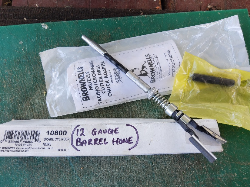

In case you guys are interested, might help out.

Wapiti wrote:In case you guys are interested, might help out.
Also known as a brake cylinder hone. :lol:
