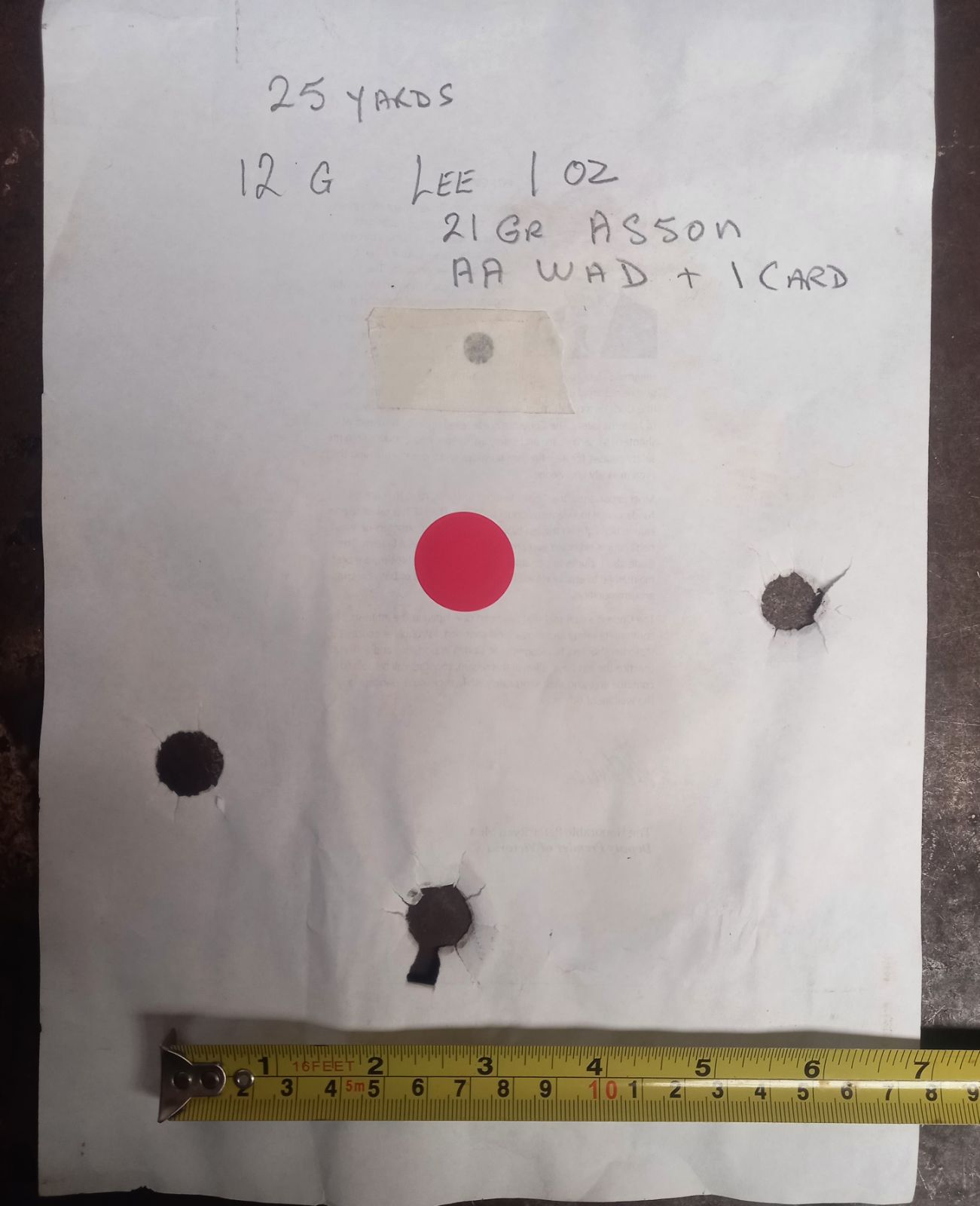

I never checked on paper. But hitting a 4 ltr paint can at ummmm IIRC ABT 30 yards just using the bead. Maybe 4 out of 5.
Think I'll take it to the range when I go next. I have about 20 rounds in the ammo locker just waiting patiently.

Went to the range Monday.
Shot this out of the old Stirling single barrel. No sights. Just used the front bead.
