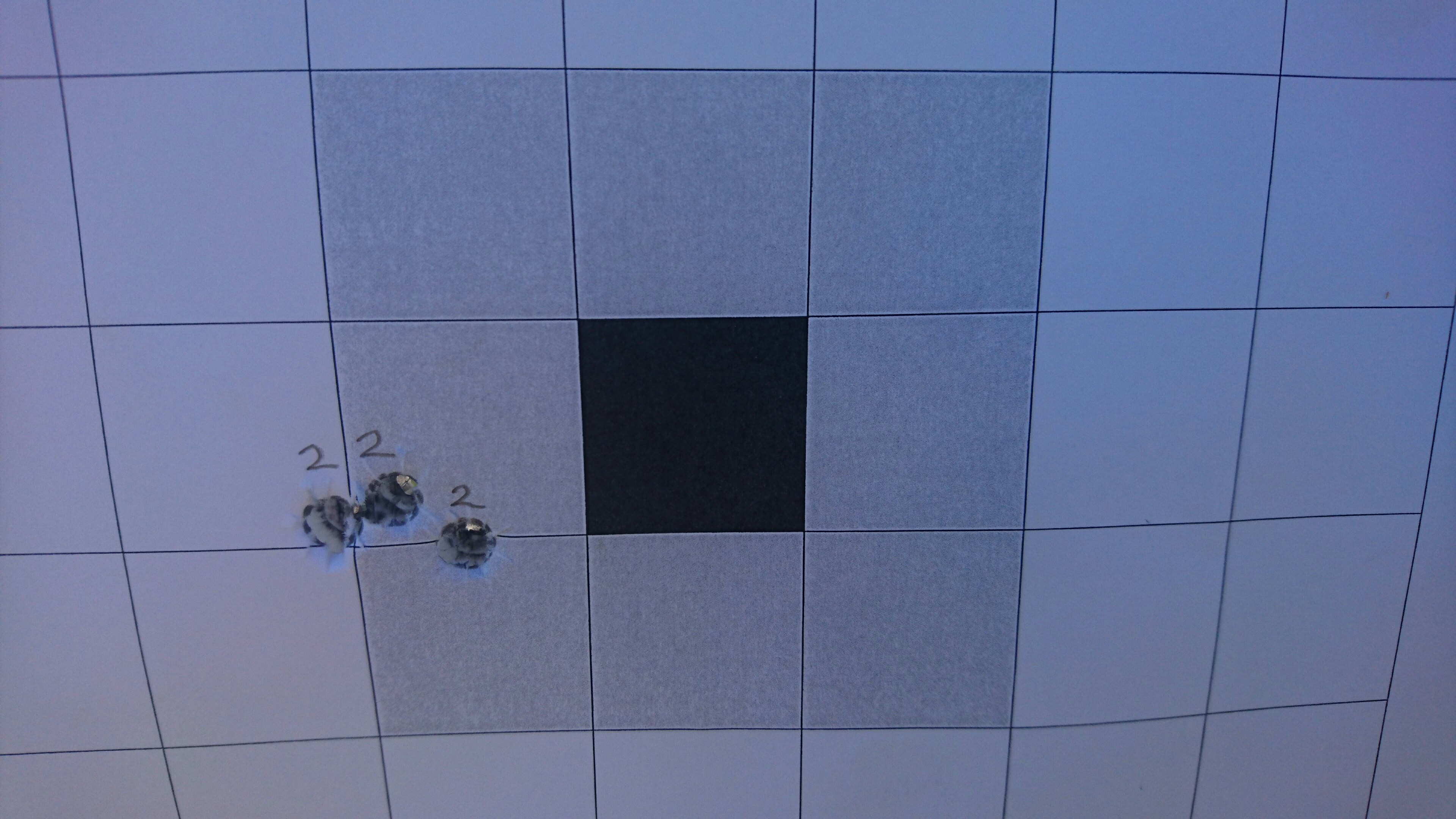

Anybody have any experience with 25-06 twist rates ?
I have one in 1-10 twist and having trouble with grouping from 100gr projectiles up to 120gr
Tried large number of various brands in this weigh range but no better, different powders,primers and still average
110gr@ 1'' TO 117-120GR @21/2'' TO 3'' , compared to cutting 5 holes to clover leaf with 100gr sierra matchking
Been told and read on many occasions that 1-10 won't stabilize projectiles over 105gr but when i bought the rifle gunsmith at the gunshop
maintained it would , maybe i should have stuck with getting a 1-9
although it does the job with 100gr i would like to have used 117gr for piece of mind on larger animals

I don't have any experience with 25/06, but from what I'm seeing a 10" twist is really only useful under about 100gn, above that and the manufacturers are specifying tighter twists.
Berger want 9" for the 115gn VLD.
Barnes want 9" for their 115gn TSX.
Cutting Edge want 10" for their 100gn MTH, but 8" for their 115gn MTH.

Yeah that sounds pretty much the situation with 1-10 just that the smithy was so sure it would work and that had me wondering
Up until i bought this 25-06 i hadn't had much to do with that caliber at all
Berger and Barnes wouldn't call for 1-9 twist for their 115 gn if there wasn't something behind it
I can't keep spending money trying to develope a load for 110gr up to 120gr when it most likely won't shoot any better
Like i said in the question it shoots quiet well with 75gr up to 100gr projectiles,so it looks as though i may have been better off with a 1-9
I suppose i'll have to make do with it now after all its only a new rifle and i don't think the wife would be too happy if i wanted to rebarrel it especially
after deciding to go with the 1-10 after talking to the gun smith
Anyway thanks for the info Cheers

Hey mate I have a 25-06 in a 24" x-bolt (1:10 twist) and I went through about 200 reloads before I could get below 1 Moa. It's a finicky caliber. One thing I definitely noticed is that flat based bullets shot a lot better then boat tails in my rifle. I tried 100g nosler balistic tips and 117g sst's and only one powder charge well above max charge with the nosler BT's resulted in a group less then 1 Moa. I then tried sierra 100g pro hunters and got down to about .8 moa (my goal was .6 Moa or better). I started doing some research as I heard the caliber and the x-bolt are both accurate and a load I often saw posted was 49grs h4350 (use ar2209) with sierra 117g pro-hunters (don't use the game king) seated About 15-20 thou off the lands. Loaded these up and straight away I got consistent .4-.5" groups at 100yrd. Decided to try .5 gr up and .5 gr down and both groups opened slightly to about .7 moa so I'm going to leave it as is. Give these a try and let me know how you go. The bullets are also the cheapest I tried at $50 for 100.

Hmmm. I've got a tikka T3 Hunter in 25-06 that's (meant to be) 1in10 twist and I get reasonable groups with federal 117 gn factory ammo. This is is good as I've managed so far at 100m over a bipod, but I'm a crap shot and need to work on my technique.
Im pretty sure my bad groups are all me. But... based on your comments that a 1:10 will struggle with projectiles over 100 gn maybe I should buy a couple of boxes of lighter projectiles just to see what happens.......

The 1 in 10 twist rate is correct for the 25 cal, I had a 25/06 for a quite a few years, loved it, but could never get it to group all 5 shots under a 1 inch, always one or two fliers, but it would tighten up if run at max loads of 2209 or 2213 and later on with 2213sc. There is a theory that the long powder column is not conducive to accuracy, good hunting accuracy just not good on paper. I have stayed with the 25 calibre, my favourite being the 250 Savage Ackley Improved, not finicky to reload and is a tack driver with identical or slightly better velocities than the 25/06 with less powder, great round :thumbsup:
Edit:: forgot to add the Berger 115VLD's are the most accurate projectile I have used in the 250AI, with 1 in 10 twist, consistently well under •5moa but they do like a bit of jump, in my rifle others may vary.

Yep i'm hearing you Strikey but i tightened mine up with MatchKing 100gr just touching the lands, move them away and it would open the group
slightly also found 2209 had an edge on 2213sc with the lighter projectiles
If 100gr 25 cal won't do the job for me after all the drama i've had with rifles this year i'll sell them all and get a 7mm with a twist to shoot 168gr to 175gr
Back to one rifle
