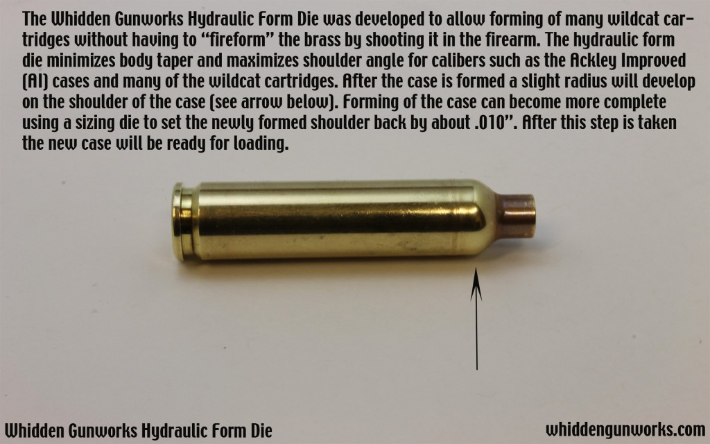

deye243 wrote:AI chamberings are only worth it if you have a separate barrel to screw in to fire form brass otherwise you are just burning up your throat on a bloody good barrel absolute waste of friggin time
There are options for brass that don't involve fire forming which doesn't burn up barrels.
Video here- https://www.youtube.com/watch?v=KCqb_7UYh9k
