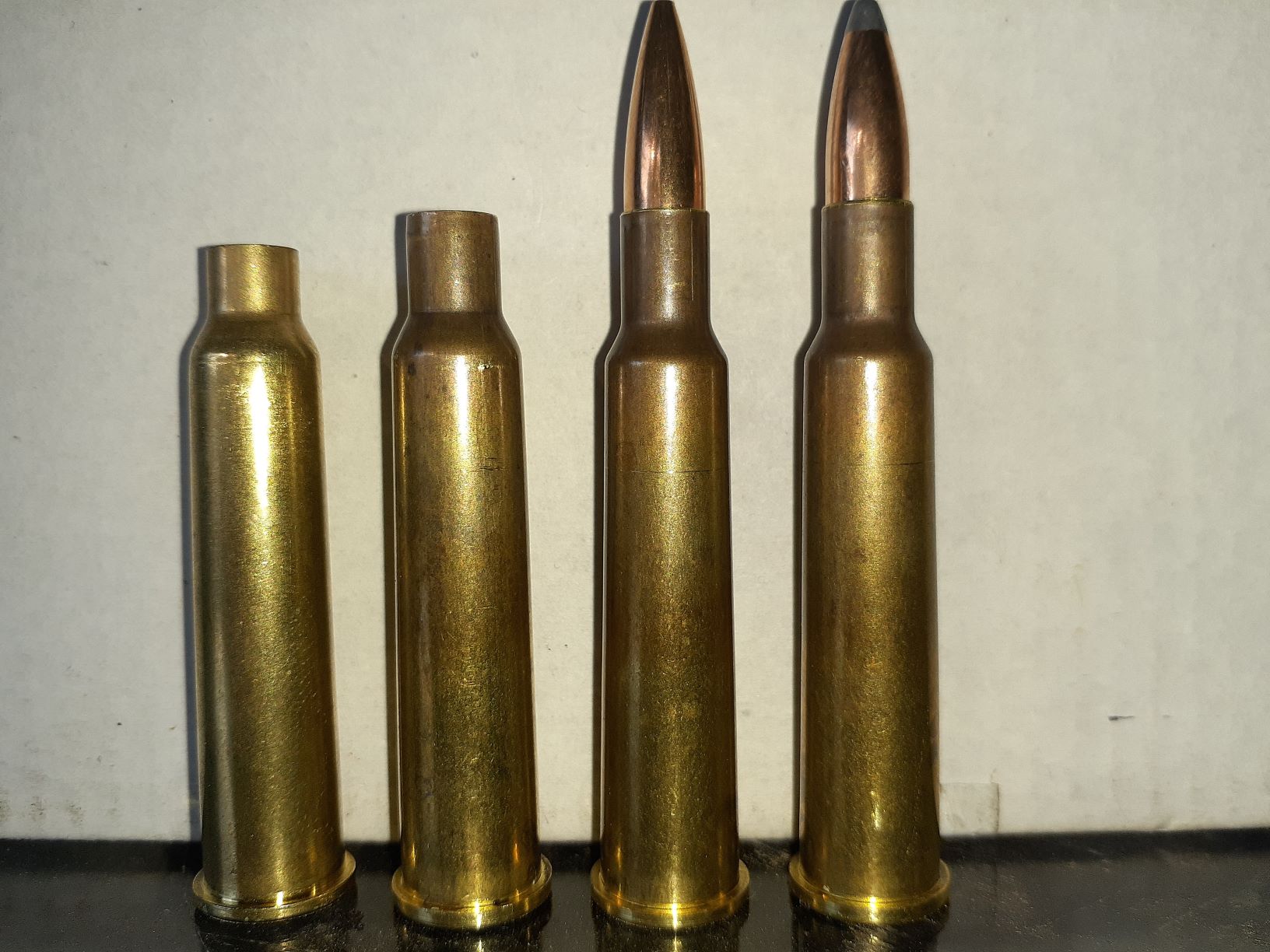

Post by Stoney » 29 Sep 2020, 6:11 pm
G'day fellas,
Just an update on the old P14 if you are interested. Firstly, the twist rate on the barrel is indeed 1:12". Secondly I managed to fire a few shots out of the old girl on Sunday at Ripley and here are the results. Definitely 303/25 Imp, NOT 303/25 Sprinter Imp or A.I as I incorrectly stated. The two rounds on the right are Bertram brass loaded with 87gr Sierra TnT middle right and 87gr Speer soft points extreme right. The fired case on the left is a fireformed Bertram case. The one on the very left is a fired Unique 303/25 factory loaded case. I bought a box because I knew they are loaded way down and not really knowing the chamber as a safety margin and also to use them to get me on paper @ 50yrds.
303-25 Imp.jpg (260.39 KiB) Viewed 10353 times
Stoney

Re: My new P14
Post by marksman » 30 Sep 2020, 12:26 am
its a sexy looking fireformed round :thumbsup:
the unique shortened quite a bit and the rim looks heaps thinner :unknown:
Re: My new P14
Post by straightshooter » 30 Sep 2020, 6:57 am
Stoney wrote:G'day fellas,
You have resolved one question and now you are faced with another.
Suitable reloading dies?
My suggestion is contact Simplex reloading. They may already have suitable die sets.
When it was run by Bill Marden Jr. it was possible to send him a couple of fired cases and he would produce a custom die set, but he has retired. It is now run by his daughter and chances are they might still offer the same service although the business now appears to be much smaller.
Posts: 1467
Re: My new P14
Post by Stoney » 30 Sep 2020, 5:10 pm
in2anity wrote:The Speer TNTs go good, especially for the price point. Keep the updates flowing Stoney, enjoying it. I’m eying off some p14s myself, in an upcoming auction, to potentially replace the No4. Looking for a 303 with a little more consistency.
Yes In2anity, I am becoming quite a fan of the P14 action.
marksman wrote:its a sexy looking fireformed round :thumbsup:
G'day marksman, the unique case has a really short neck and the shoulder is pushed way back as a loaded round. Unfortunately I didn't take a pic. I guess this is so it will fire in any 303/25 version. It is also loaded very mildly, some of the cases didn't really fireform that well and have an almost rounded Weatherby shoulder.
When it was run by Bill Marden Jr. it was possible to send him a couple of fired cases and he would produce a custom die set, but he has retired. It is now run by his daughter and chances are they might still offer the same service although the business now appears to be much smaller.[/quote]
Funny you should mention that straightshooter. I did in fact contact Simplex about my dilemma and received a phone call by Bill Marden Jr himself. He set me straight about the gun and told me I was probably wrong with the A.I as Australians only generally used Imp back in the 60's. He was totally right of course. Awesome bloke to talk to. I have since purchased a Super Simplex press with 303/25 neck die and bullet seater. The old one 5/8? Anyway I intended to ring Mr Marden back and tell him he was absolutely right. And also see if I can send a couple of cases for a FLR die. As an aside I also spoke to him about a 303/270 rifle on a M17 action that was made by his father that is for sale. I will be buying that shortly.
