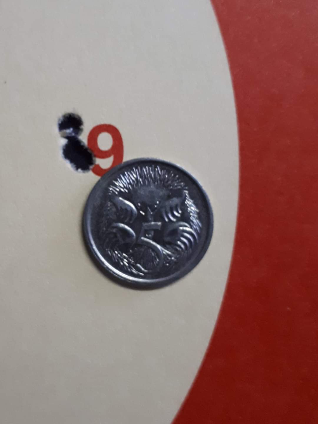

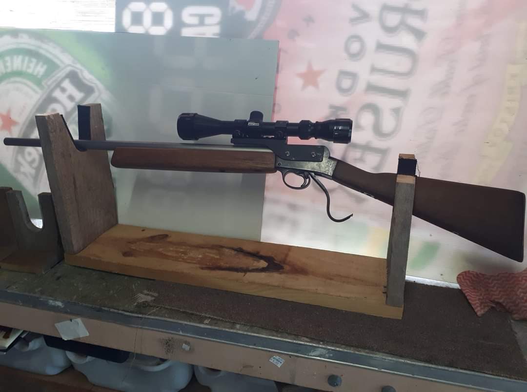

Post by snag » 11 Sep 2021, 8:07 pm
The build is happening.
snag
Posts: 313
Re: 17 Hornady Hornet
Post by snag » 28 Jun 2022, 5:12 pm
Complete.
snag
