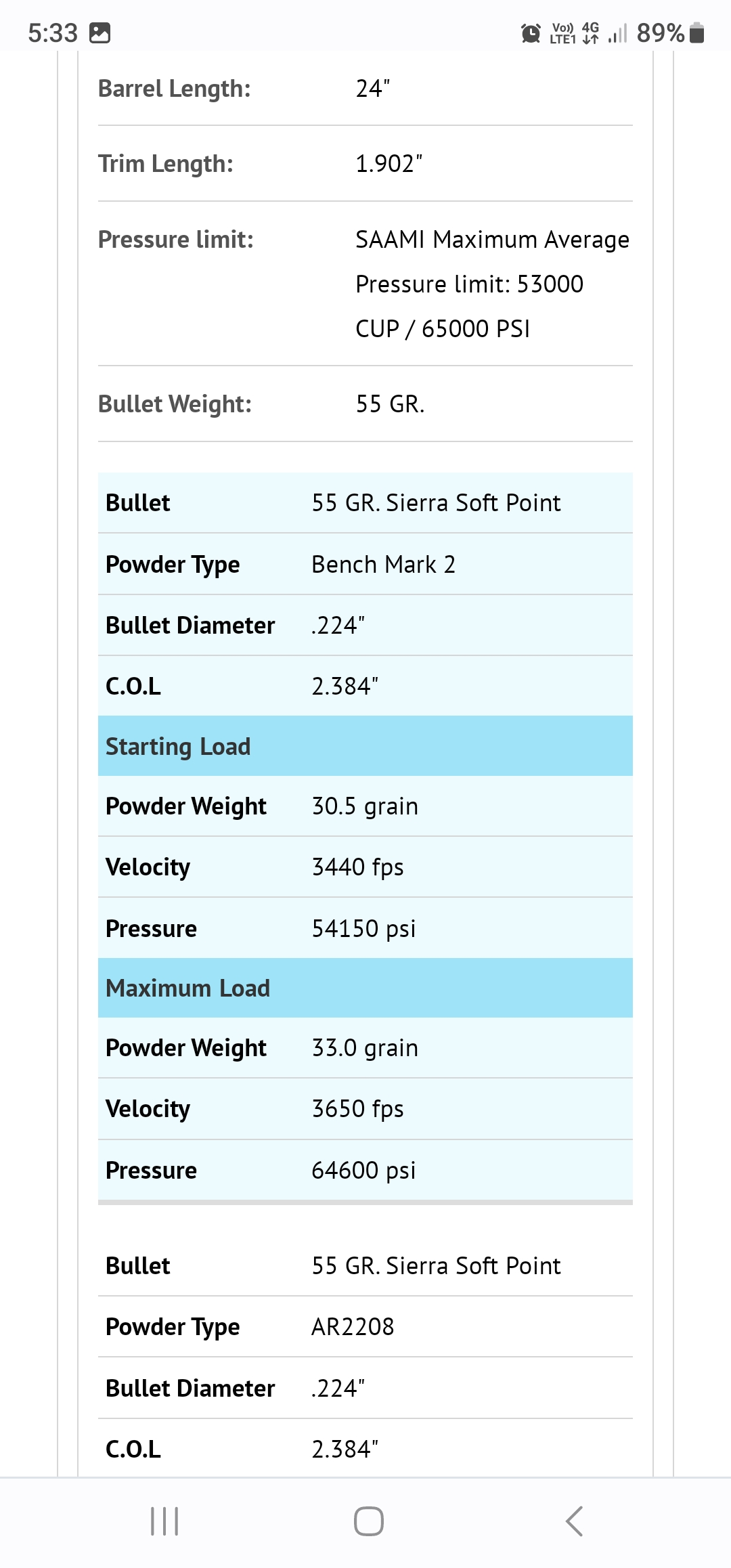

Hi, I need some help with starting loads for a 22.250 using benchmark 2 powdwer and Sierra 55 gr HPBT projectiles.

Some members here were getting good results with 31.6g for appx 3450fps. The load is fairly low but the groups they were getting made up for the lower velocity.
