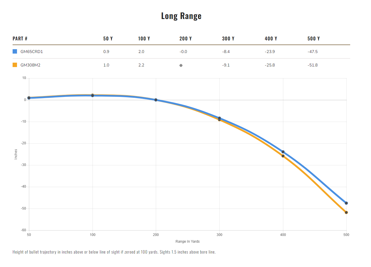

Post by gunderson » 06 Feb 2024, 8:49 pm
]My thoughts would be unless you have some special need to shoot extra accurately etc... the 308 will do fine.
but compare some numbers:
Wind Drift 6.5 vs 308
wind drift.png (56.51 KiB) Viewed 23936 times
Trajectory
the 6.5 is no doubt the winner, whilst federal didn't have a PRC listing I poached this pic of a 6.5 CM vs PRC
CM vs PRC
The PRC therefore shoots one heck of a lot flatter than the 308, which is no surprise given the 308 is a lobber/not a magnum etc.
Cost effectiveness? no idea what the PRC costs vs the 308 but I'd be willing to bet you will be hand loading anyway if serious about accuracy, so Id consider it negligible at best in the reload cost difference.

Dont get the 6.5 there is no practical difference in the ballistics. I would say this even if you did have aspirations of competing as the two are in different classes and the 6.5 would be competing against many other target based calibers and lots of other expensive target accessories. The 308 competes in a class of its own against other 308s and normally using the same weight projectiles a much more even field.
Even when hunting the difference of several inchs of drop difference between the two is not an issue as the difference compared with the overall drop. Well you have to adjust your sights for the overall drop so adjust them accurately for the precise drop.

If you're only shooting at 500m then 308 for sure imo. The difference in trajectory is negligible. If you were planning on pushing past 800 then I'd start looking at 6.5 cartridges.
