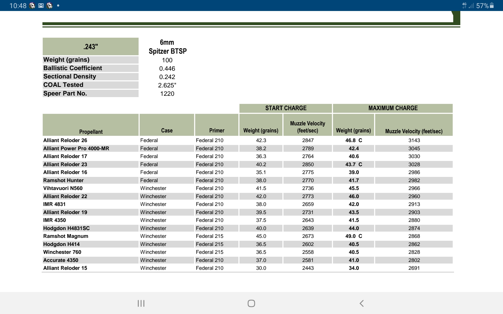

Post by bigrich » 17 Feb 2024, 3:46 pm
thanks for the replies, a real wealth of in depth information guys . especially wylie coyote . i think after digesting all that i'll just stick with a boring old 243 ;) however , tikka make 243 in 1-8 twist now as well as the standard 1-10. as i want to shoot 90-100 grain projectiles this twist would be better suited methinks
any thoughts on the 6mm creed but :unknown:
