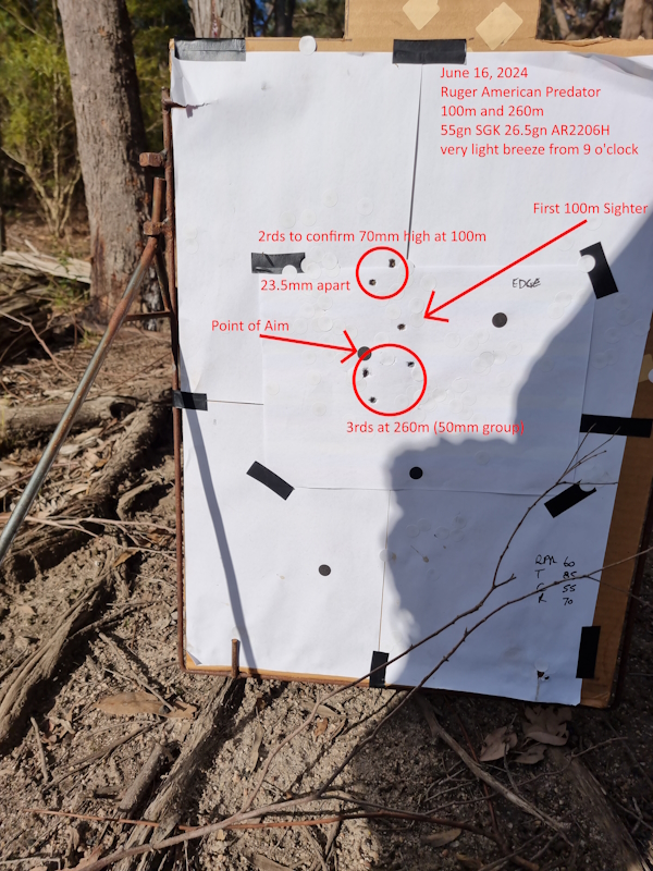

Post by bladeracer » 29 Jul 2024, 9:58 pm
animalpest wrote:I would think a lot of rifles and shooters - let alone service rifles - would struggle to get groups of 2 moa at 300m?
I confirmed zero on the .223 six weeks ago. Fired a sighter at 100m, made a scope adjustment to give me a 250m zero, then fired two rounds that were 23.5mm apart and 70mm high, then fired three rounds at 260m that grouped right on 50mm and were 30mm low. One minute at 260m is 75.6mm. I wasn't shooting groups so don't know what it would've actually grouped if I'd fired five round groups, but I was pretty happy with that, more than adequate to head-shoot most things. That was off the bonnet of the ute with the 55gn SGK on 26.5gn of AR2206H at 2.290", very cheap shooting.

Nice group on your 223 btw - keepi that load Blade.

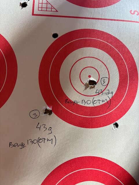

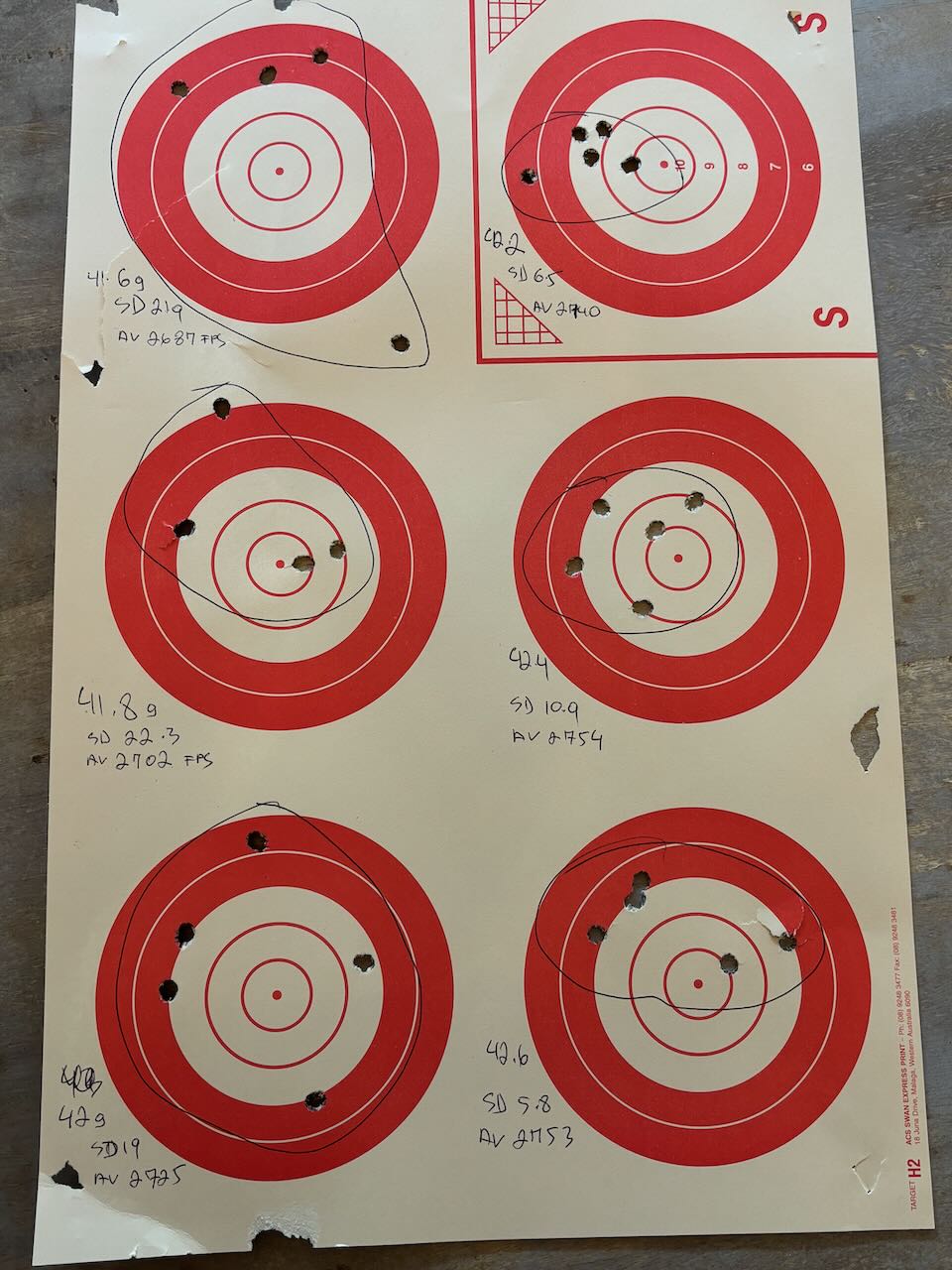

Post by zbenga » 21 Sep 2024, 9:54 pm
it 100% does and I can attest to that. On my LA105 with Berger 130 OTM's it's a laser, with Berger 144 Long Rage hybrid it's awful same brass same primer same 2209 same jump same day
on the 130 OTM's ignore the bigger holes, they are from zeroing the 45-70
IMG_0137 (1).jpeg (663.87 KiB) Viewed 10573 times
