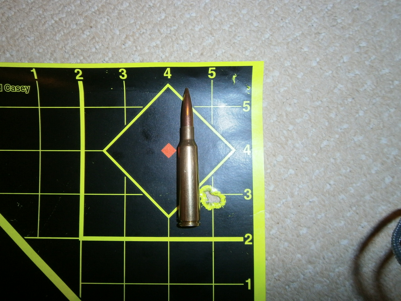

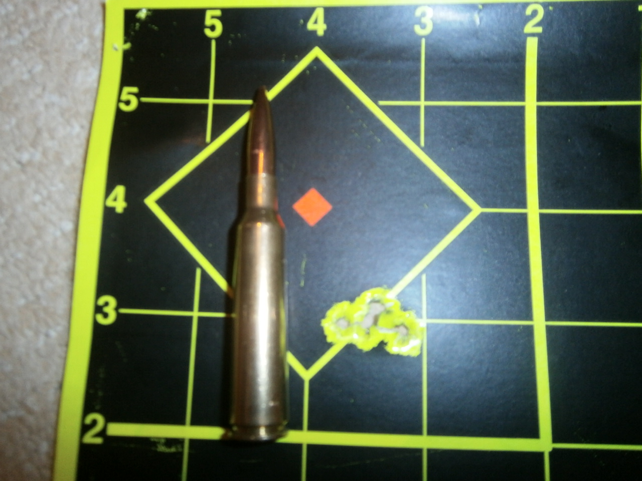

Well finally got the time and the right weather to do some load testing today with the new Swede and I'm pretty happy with the performance so far??? I think I'm headed in the right direction with this ??? 123 Grn serria HPBT with 44 Grns of 2209 driving it at a average speed of 2710 FPS on the crony :P :) :P Had a few different loads and surprise- surprise this thing like to jump the lans ,this even blew me away as the other T3 hunter using 140 Grn SST likes to be 10 thou off the lans go figure???? Anyway will try to post some pics up soon/tonight and see what you guys think needs to change????Minded you this rifle has now only fired 55 rounds so it still is in it development stages. We also did some testing on the 8" gong at 500m and well we rung that sucker 4 outta 4 times man I'm loving this thing. Thanks Mr tikka!!!!!! :lol: :D :lol:
44 Grns 2209 oal 3.000 1st group of 5
44Grns 2209 oal 3.100 3rd group of 5
44 Grns 2209 oal 3.050 2nd Group of 5
Westy

When I upped the load to 45 Grns it opened right up it's amazing how much it can change?????
