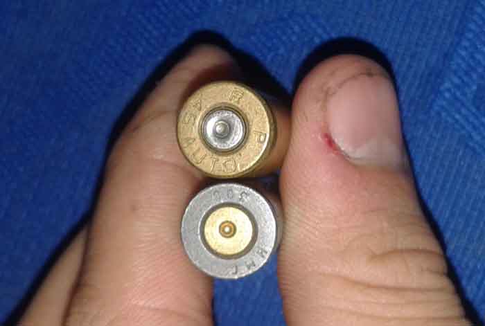

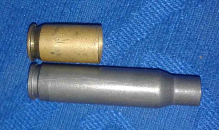

Am I right that this can be done?
Cut a .308 Winchester case off at the right height and you've got working .45 ACP brass?
Just curious.

I dont think so. The primers are a different size and the ejector grooves are a lot smaller and a completely different profile

Look in the latest shooters mag,dealers selling once fired 45 brass for sixpence,the dimensions are very close I grant you that, but the extractor groove is different profile and probably won't engage the extractor.
The primers will be an issue also,rifle primers are very hard relative to piston primers.Awhile ago,a small volume pistol manufacturer based an auto cartridge on the 308,tell us who it was ?

Yes, you can, and it's done in the States all the time to make .45 Super.
Be aware that you'll have a thicker case wall and you'll have to reduce loads to match. .45 Super is usually fired from 1911 pistols that have been modified with fully supported chambers and heavy springs.
The .45 Super and .45acp cases are almost the same, except that the .45 super cases are thicker. Remember that the .45 Super loads are fired from fully supported chambers and that you need to stick with reduced .45acp loads (keep in mind the thicker case; reduced volume!) in standard 1911 pistols (and any other pistol without a fully supported chamber) or you risk case head separation.

Thicker case wall is a problem. Reduced loads is one option but a better one IMO would be to ream the inside of the case and this would prevent potential seating issues as well.
The brass would also be hard as hell given where it's taken from on the rifle case. Annealing would be beneficial.

308win is ever so slightly smaller in size except for a little thicker rim....
