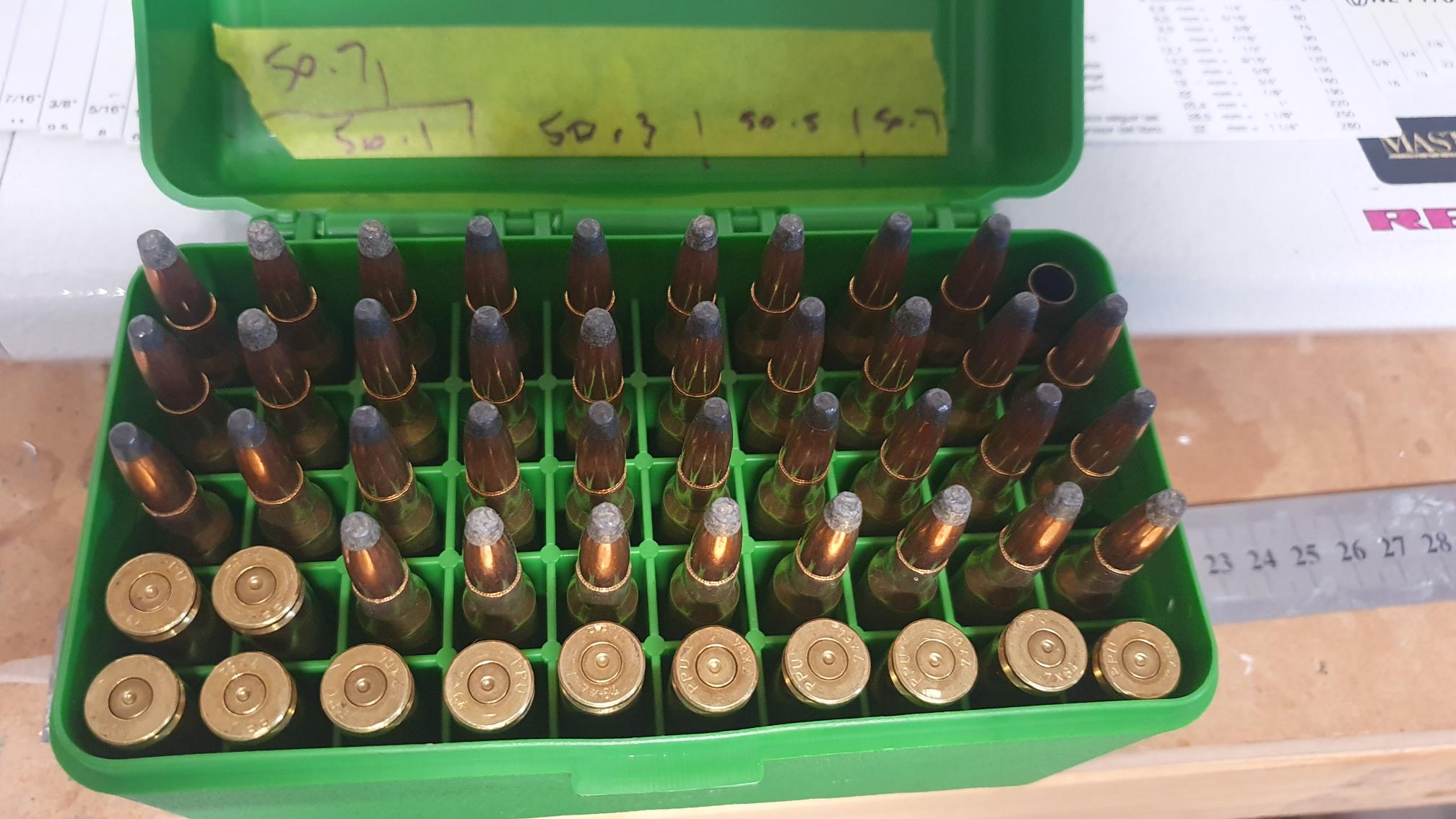

I know it's an old thread, but I thought I'd share some info since there's bugger all data out there for 7x64. I've tried a few loads of recent using PPU brass and starting from the lower end of 280 rem data. I found a great load at 50.7 of 2209 with 140gn Nosler BT's but unfortunately showed signs of pressure (flattened WLR primers). I've now backed it off a bit and settled with 49.5 gns of 2209, I'm not sure of the velocity but they grouped well in my Sako 85

That’s interesting. I have been loading 54 grains of 2209 behind 160 grain Accubonds for many years. Velocity is 2850 fps , with probably close to 500 rounds fired. Very easy extraction and very good case life.
Blaser R8 and GECKO / RWS brass.
But every rifle is different…

Yeah most likely the lower capacity of the PPU cases, unless someone has other thoughts. Here are the primers up to 50.7, looking a little flat

Yes, different cases, primers , and rifle.
What rifle are you using?

Sako 85 Hunter

Depends on primers but its 3.5 grains below max so shouldn't be too higher pressure.

Yeah, I'll try some Remington primers, see how that goes, I was quite happy with the result at 50.7 gns, thanks!
