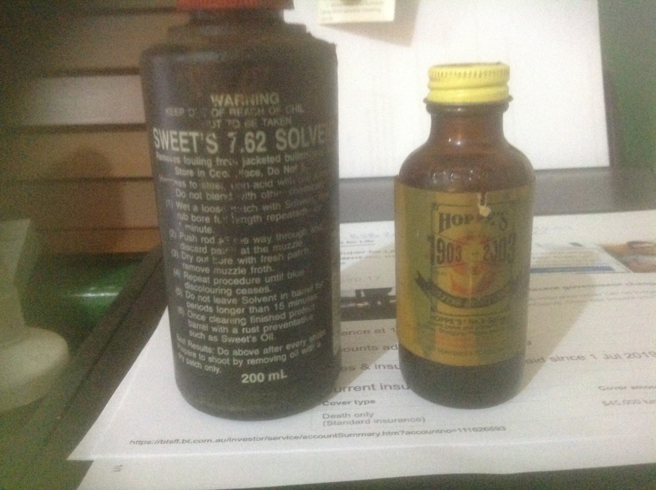

Post by TassieTiger » 18 Jul 2019, 7:24 am
I soaked both the 06 and the 300 in hoppes 09 for an hour and did not get any blue colour on any patches.
I then found the smallest torch and examined closely as per pics above and couldn’t see any copper on either muzzles, lands, etc.
I’m going to try and get some sweets today.
Thanks for all the advice.
Cheers.

Post by TassieTiger » 23 Jul 2019, 8:39 am
Okay - so small update to this.
Pushed some saturated patches of sweets down the barrel and left for 10 minutes - then patches out the residue...and yep. Blue.
I then looked into the muzzle and was gobsmacked - what I couldn't see before I could now clearly see...long streaks of copper chasing the rifling. Just a tiny streak on the 300wm but very clearly defined Cu lines in the 06.
Took about 15 mins to get rid of the copper streaks in the 300wm...but I had to do follow the "process" about 6 different times (2 hours) on the 06 and it still has some slight discolouration in the rifling...The strange thing to me was - I expected to see blue patches regularly but this was not the case - blue patches came out only on the first application / scrubbing of initially applying the sweets.
Every time I patched out after leaving the sweets in - I just got a black discoloration on the patch but could still see copper in the muzzle. So, I'd put another wet patch in with sweets and that would turn blue very quickly - then nylon brush with sweets in the barrel - then patch out and only carbon...and so on. Bit different to what ive seen elsewhere as cleaning expectations.
