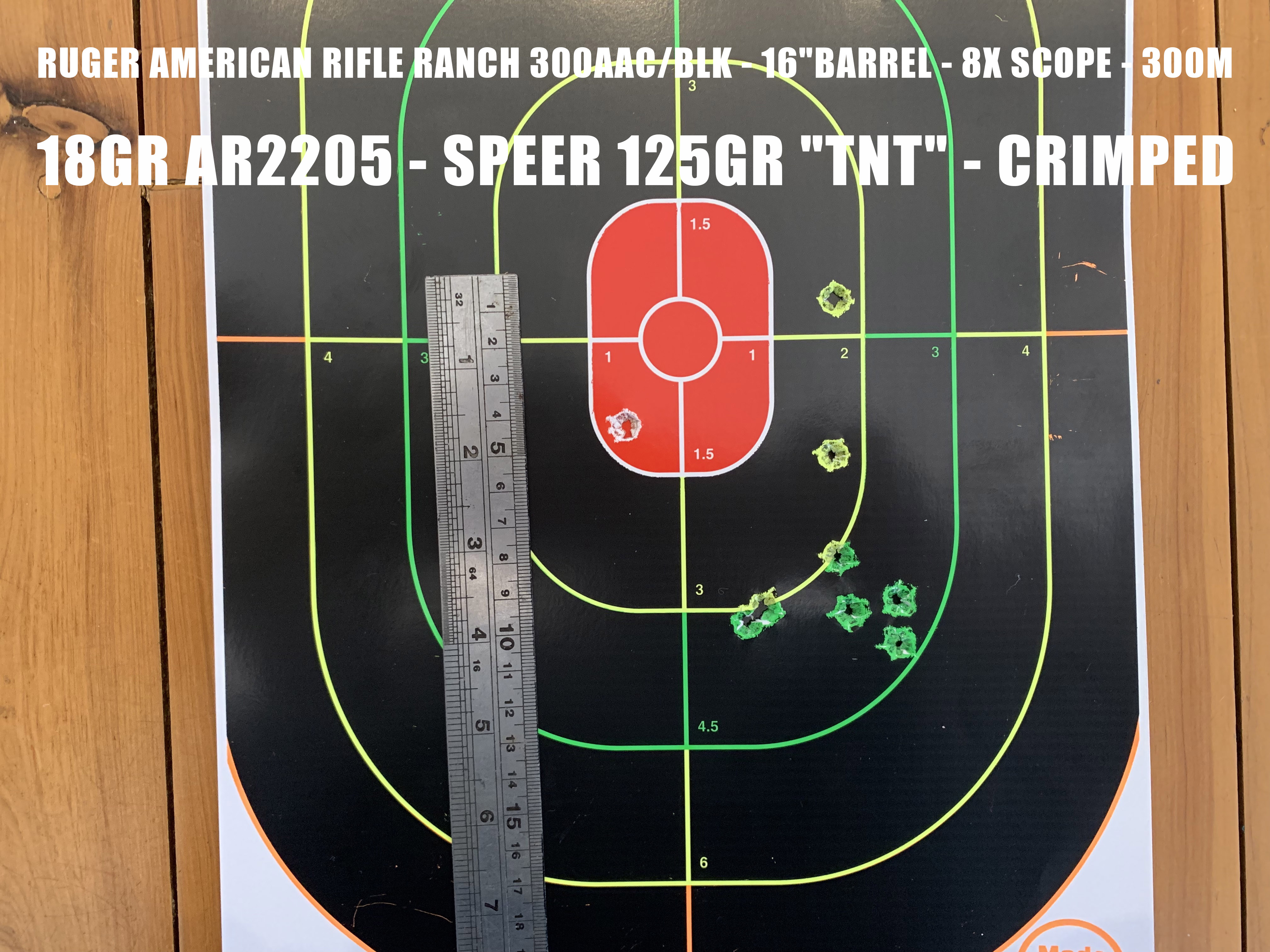

Using the little 16" Ruger blackout, I shot this group from the 300m line at ANZAC on the weekend. We had a 15-20km/h 8-oclock crosswind:
300m, 9-shot group, 15-20km/h 8-oclock crosswind
I've shot a fair few different bullets through her now, and the Speer TNT is the clear favorite. Overall it groups better than the Hornady bullets. A 125gr projectile with at least -0.003" of neck tension and a moderate crimp seems optimal for this barrel+action.
I was also shooting my 308 Tikka CTR with the exact same bullet over a safe amount of AR2207 (38gr). At 300m, the little blackout was grouping only marginally worse than the 308 spitting them out 800fps faster.
This particular group was better than some of the "tacti-cool" setups on the line shooting factory 6.5cm :lol: moral of the story, don't bash based on other people's heresay.
One thing I might add, the listed BC for the Speer bullet is a fair way off out of the blackout. I'm (currently) extrapolating 0.27 instead of the listed 0.341. I can only presume Speer averages this based on significantly faster muzzle velocities.
