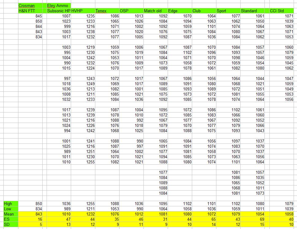

Rather than add the velocity data to separate posts I thought I'd just do a graphic of all the Eley.
Eley test velocities.JPG (184.28 KiB) Viewed 15191 times
The CCI is the final fifteen rounds I finished the session with.
The Crosman is just some readings I took on the air-rifle with H&N Field Target Trophy while I was out.
Two shots went 1101fps and had a supersonic crack, the highest that did not go supersonic was 1098fps.
Statistical Deviation of 9fps for Tenex and Match, 10fps for Edge and CCI Std Velocity.
But 5fps for the .177" air-rifle surprised me, especially with the cheap H&N's.

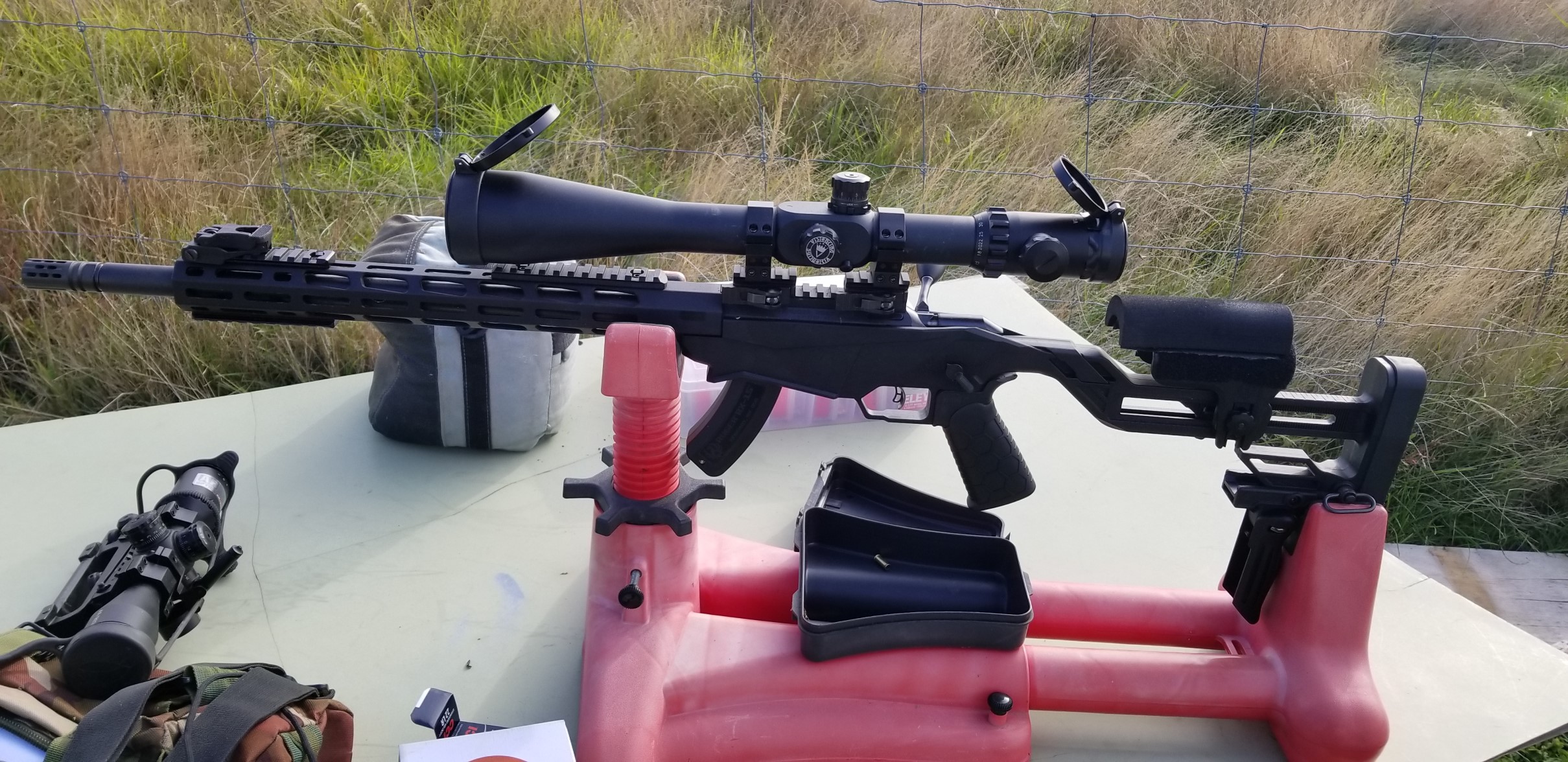

I used the MTM rest for this test.

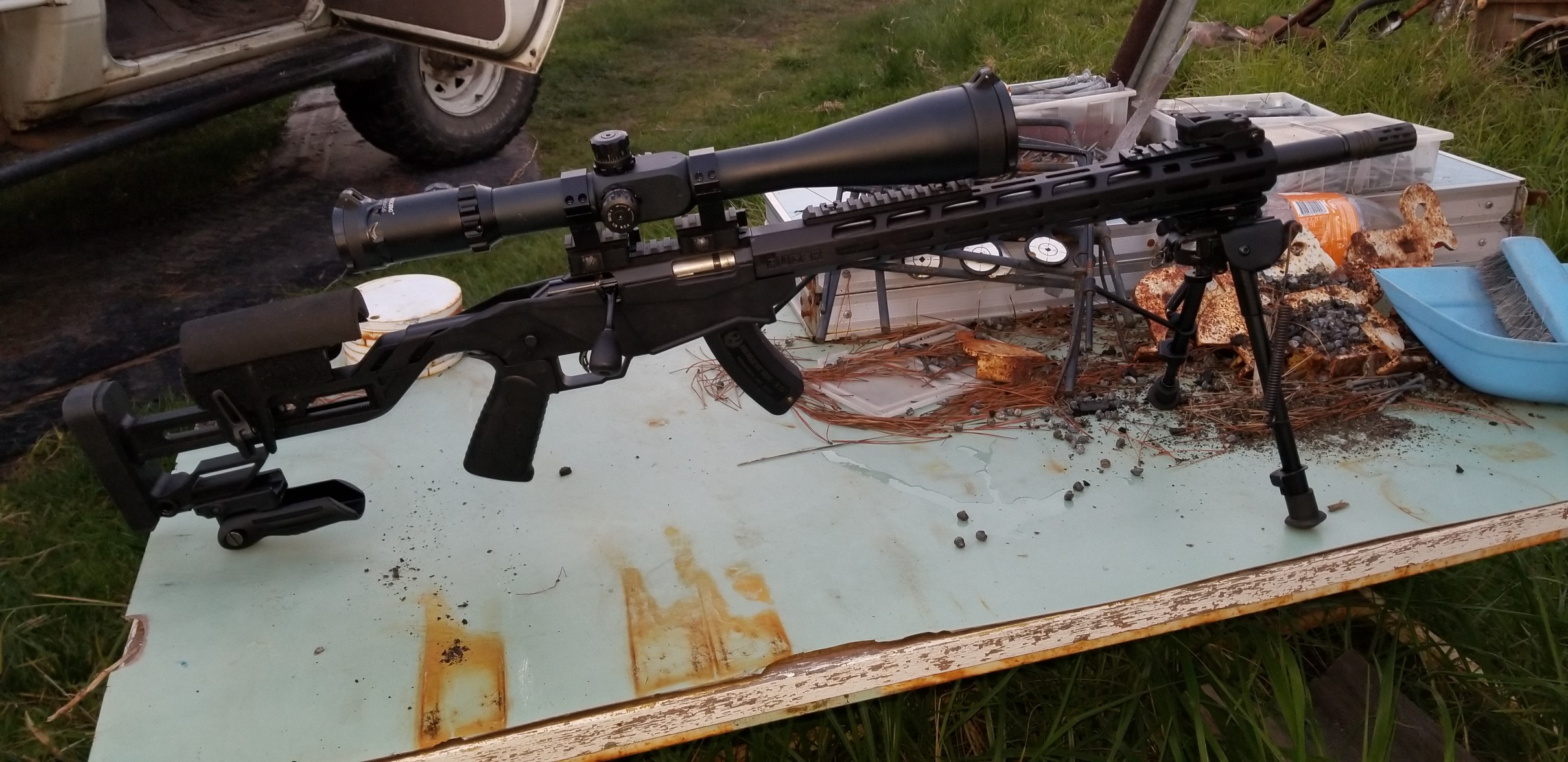

The VisionKing 10-40x56 is a monster, but I haven't had any problems with it so far.
Very limited elevation adjustment so I had to shim the front ring .012" to be able to get a 50m zero for this testing.

I have to say that I am getting a little sick of lugging the huge VK 10-40x56 around on the .22, looking forward to completing this and swapping the AR Optics back on.

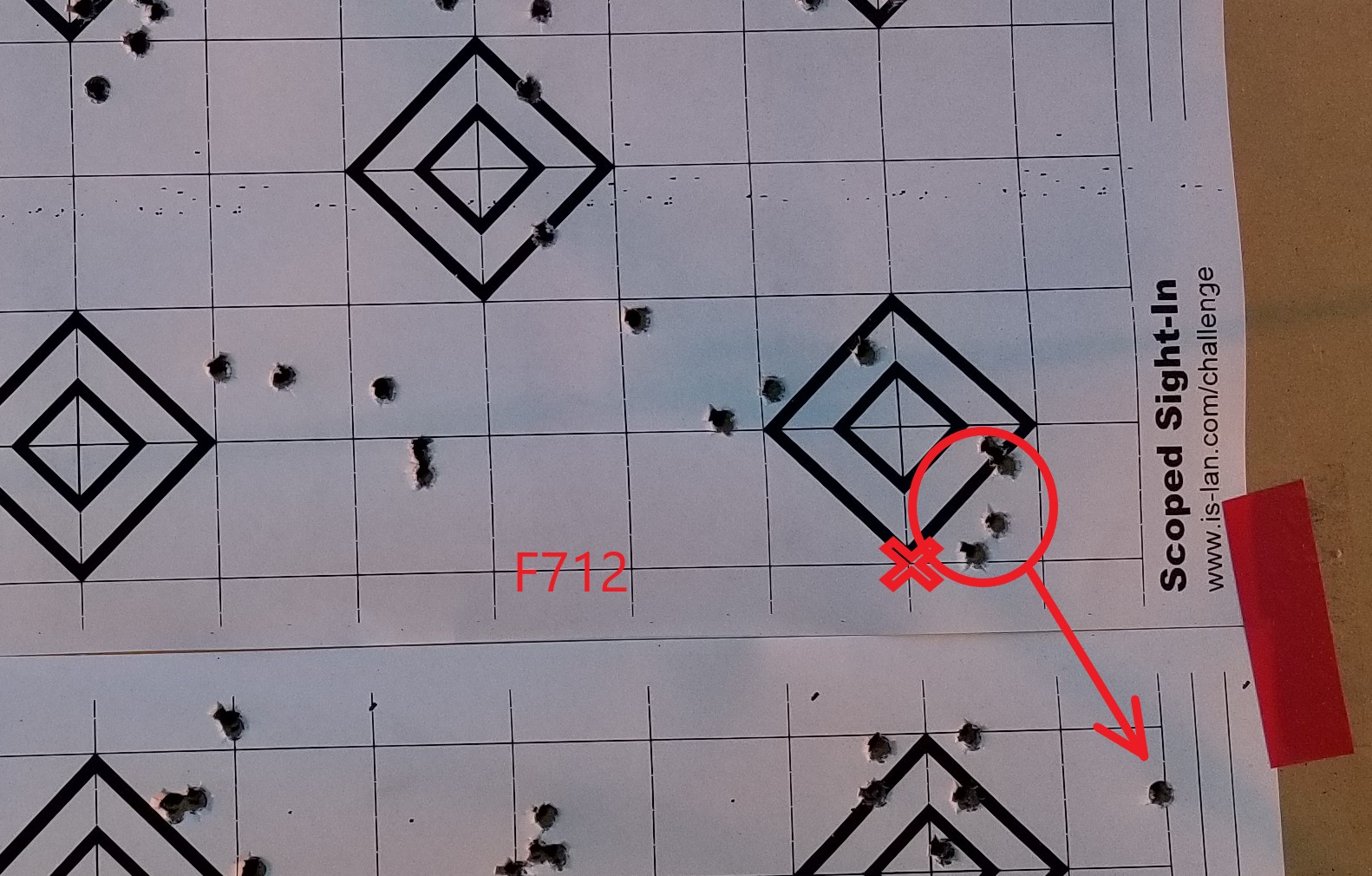

One weird shot occurred with the Federal F712, I fired a clean shot but I couldn't find a hole in the target, must've gone through another hole. Then I spotted the damned hole five-minutes low and two-minutes to the right (the grid is 2MoA at 50m), what the hell! I _know_ the shot was good. The other two groups were terrible though (49mm and 73mm) so it was probably just four rounds clustered in 22mm in the top left of a group with the fifth at the extreme bottom right, making a 78mm group. This was some of the lost velocity data, but I didn't notice anything with the shot.
F712 dropped a shot.jpg (372.58 KiB) Viewed 14450 times

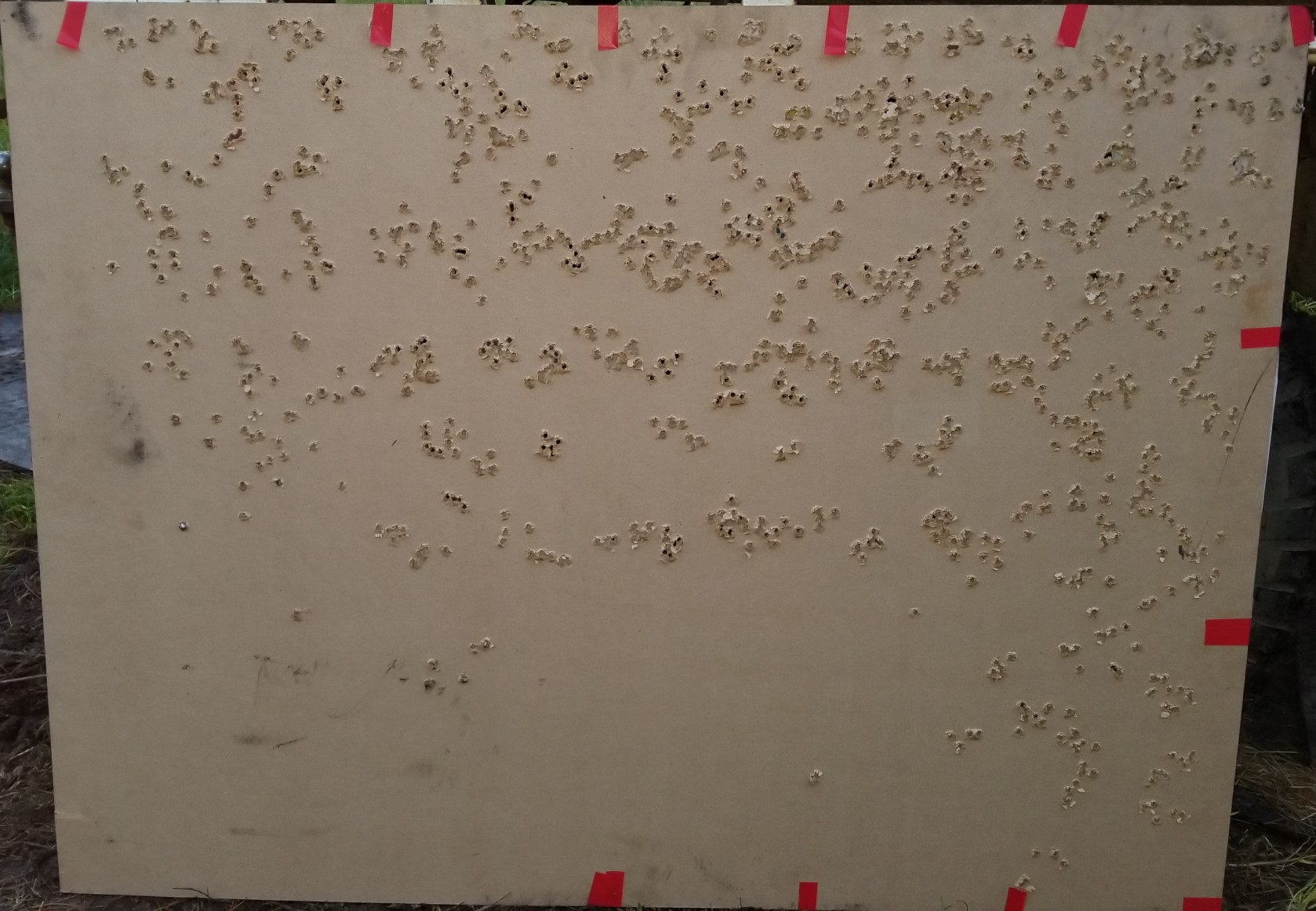

And the back of the 3mm MDF sheet after about 1500 bullets have passed through it, tons of life left in it yet, and only $8 at Bunnings.

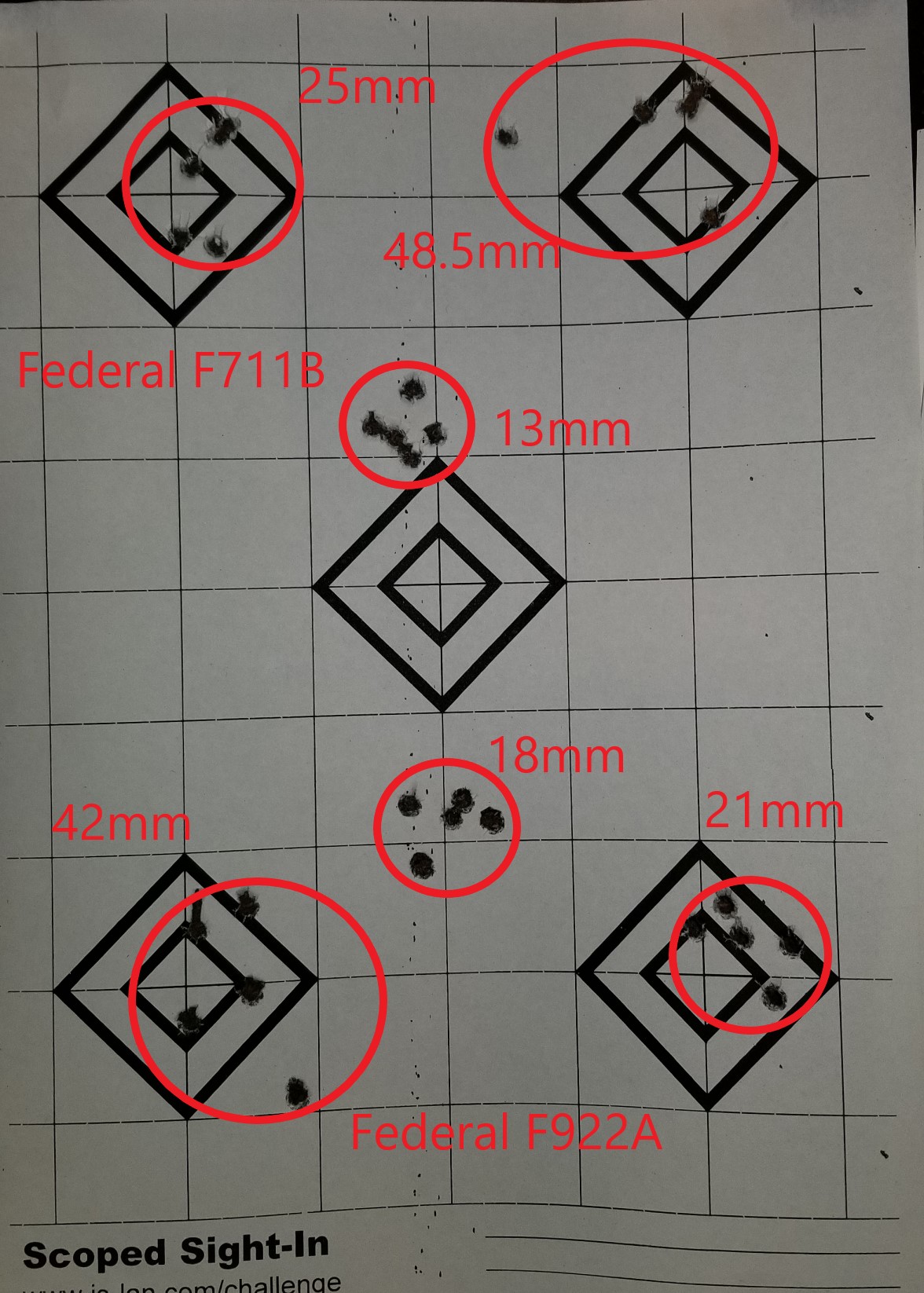

I started with the bulk Federal Auto Match.
The first group, at 21.5mm was looking good, but the next eight groups were not great, between 27mm and 50mm. These were batched by rim thickness but I'm not seeing any measureable difference between them. Velocity was 1157fps, ES 94fps, SD 22fps.

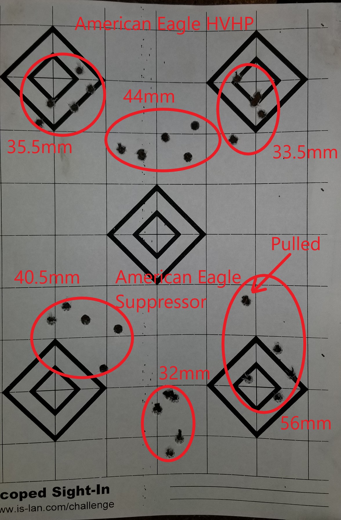

Then we have the American Eagle HVHP (40rd boxes), nothing special at 33mm to 44mm groups. Velocity was 1212fps, ES 112fps, SD 32fps.
Then AE Suppressor with similar results. Velocity was 973fps, ES 61fps, SD 16fps.
I had high hopes for the Federal F510, and it's good stuff, even cheaper than the CCI Std Velocity. Six groups around 20mm to 25mm, very consistent. Velocity was 1274fps, ES 48fps, SD 16fps.

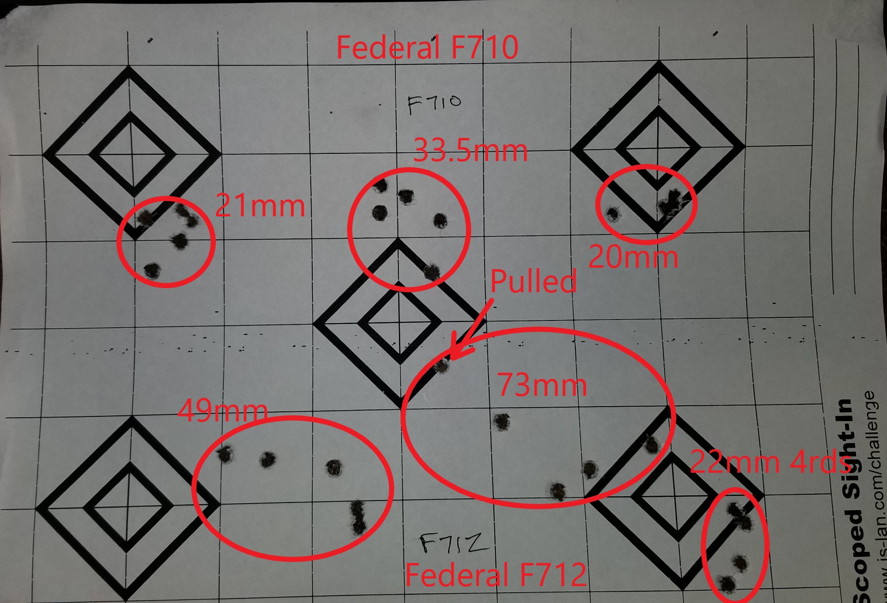

Then the F710 which shows some promise at 20mm to 33mm groups. Lost the velocity data :-(
F712 was pretty awful at 50mm to 75mm groups. Also no velocity data.

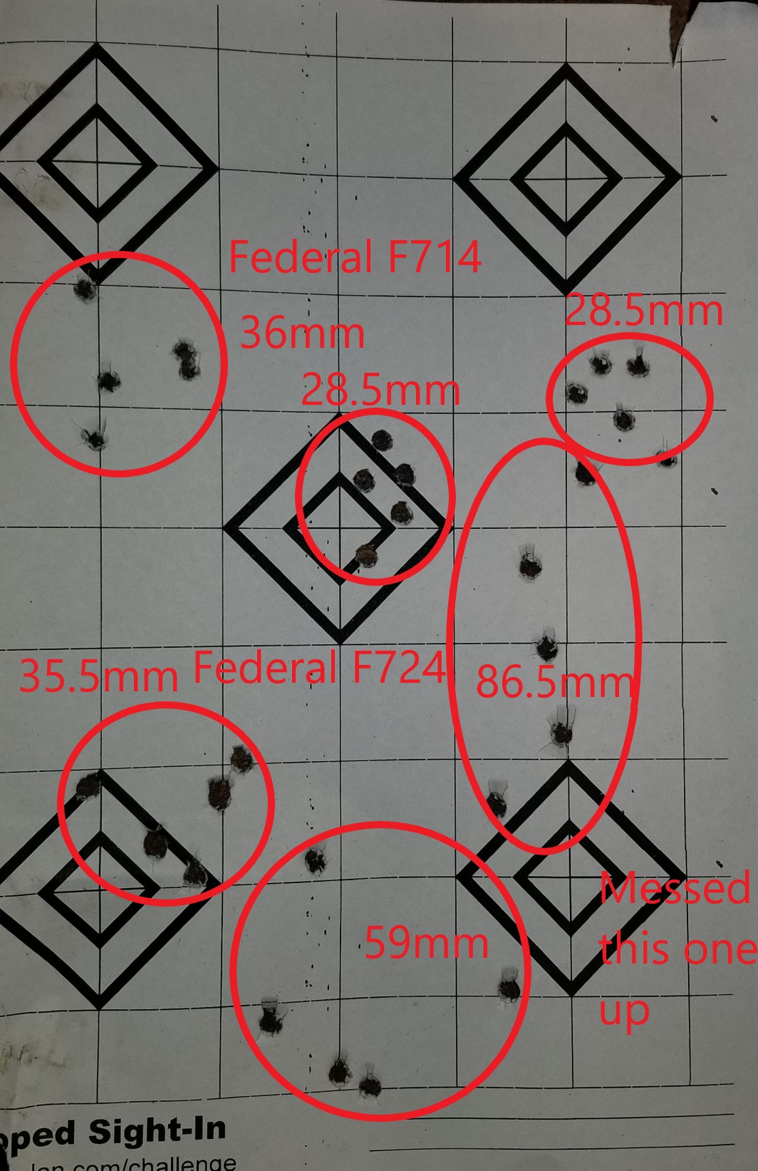

F714 looks fairly consistent with 28mm to 36mm groups.
F724 was pretty awful at 35mm to 60mm groups.
F711B started out with an excellent 13mm group, but opened up to an awful 48mm group.
F922B did similar with an 18mm group opening out to 42mm. Velocity was 1042fps, ES 39fps, SD 12fps. Very greasy though, horrible to handle.

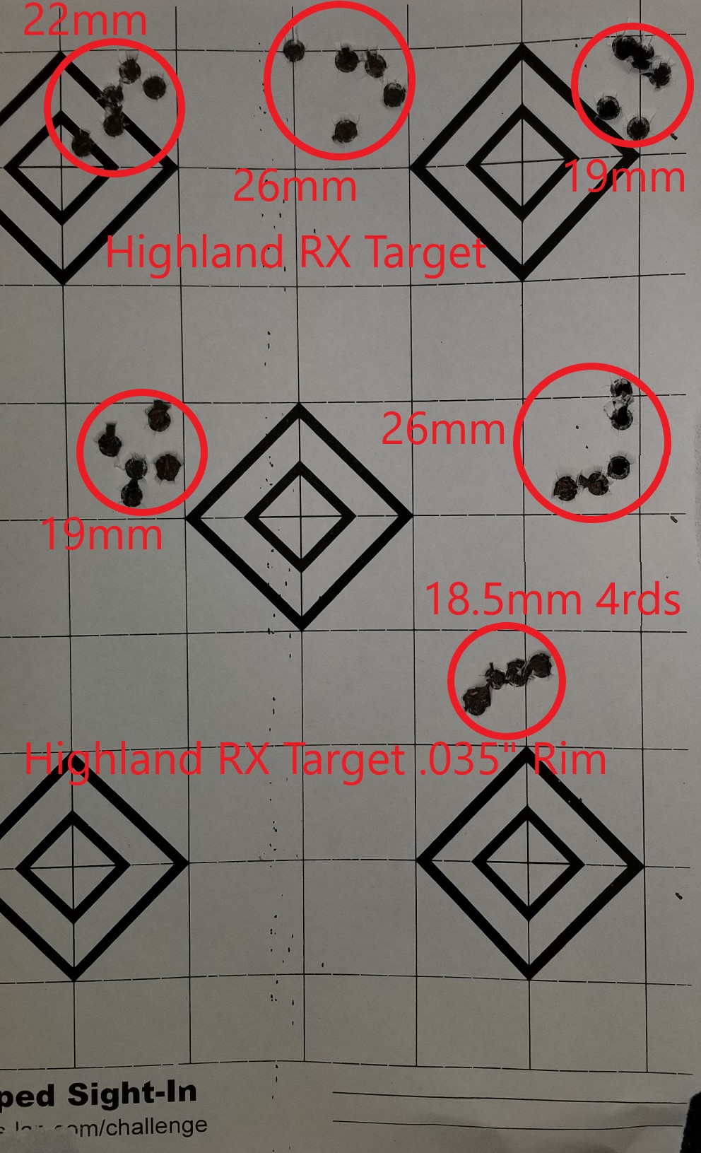

Three groups of CCI SV shows no change in my shooting so it's onto the Highland.

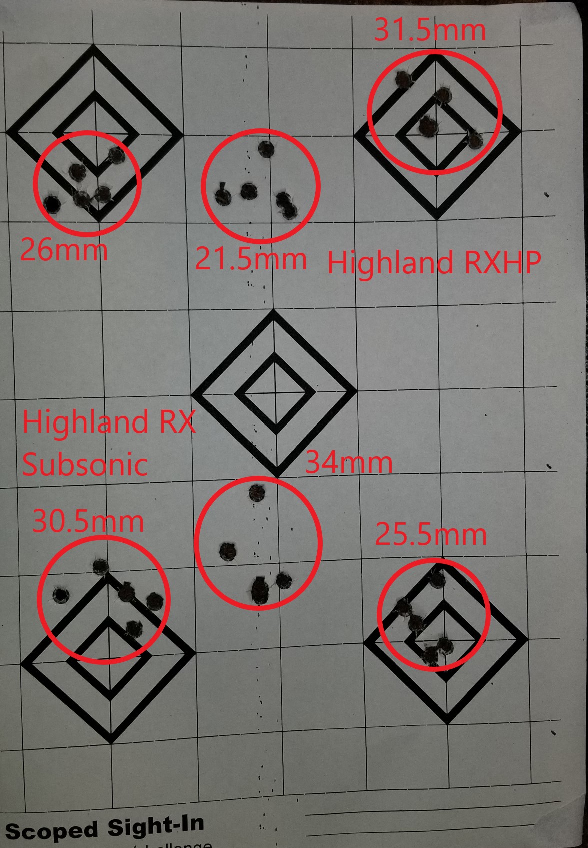

I start with the RX HVHP which has always been pretty consistent for me, though not especially accurate. Groups from 21mm to 31mm. Velocity was 1287fps, ES 44fps, SD 12fps.
Then the RX Subsonic HP, also fairly consistent with 25mm to 34mm groups. Velocity was 1071fps, ES 82fps, SD 25fps.
RX Target also shows excellent consistency with neat groups and no fliers, but around 18mm to 26mm for six groups. Velocity was 1178fps, ES 69fps, SD 17fps. All I can find when looking online is "Highland RX Target Standard Velocity 36gn Hollow Point", but they always have a picture of a box of "RX Target Solid Point". I have never seen the roundnose stuff, only the hollow point, and this stuff is definitely high-velocity. I can't explain it :-)
The RX HVRN opens up a little bit to 19mm to 35mm groups. Velocity was 1266fps, ES 41fps, SD 14fps.
Finally, the ZX Super Quiet lacks consistency, grouping 23mm to 54mm but with no pattern to the group. No velocity data unfortunately, but definitely subsonic. It's supposed to run 840fps. The VK has a dual retical with a second crosshair 5MoA below the centre one. I expected the ZX to drop significantly so I held on the lower crosshair, but was surprised to see very little drop at all.

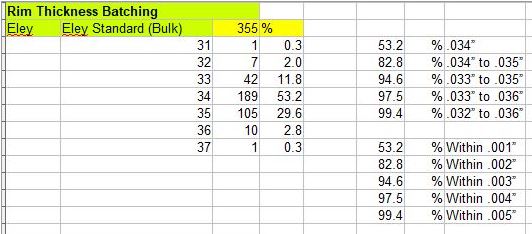

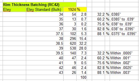

Post by bladeracer » 01 Aug 2020, 6:05 pm
Comparing your figures with mine.
I only measured one box, 355rds.
BR Eley Standard Batching.JPG (38.15 KiB) Viewed 14257 times
You measured four boxes, 1924rds, a far more relevant sample.
RC42 Eley Standard Batching.JPG (45.63 KiB) Viewed 14257 times
Yours spread across .009", mine across only .006". Mine measure from .031" to .037", and all but two rounds are from .032" to .036", but that could simply be due to my smaller sample. It's odd that using identical equipment you are measuring in a higher range than mine, probably just due to technique, yours are in the .034" to .043" range. Having so many more samples at the higher end though leaves me wondering if they might not fall into smaller batches when measured again.
I very regularly pulled rounds from batches I'd already measured and measured them again to confirm they were correct. And all of the smaller batches I measured again and found almost all of them actually measured smaller than my first measurements. This is why it is vital to turn the cartridge several times to ensure you are finding the smallest possible measurement of the rim. It is also very important to regularly clean the anvil and the chamber as lube residue builds up fairly quickly. The brass rim is not manufactured to half-thou precision, in my opinion, even .001" might be stretching it, and I think anything under .002" difference between cartridges is irrelevant at the target, from what I've seen. I did find that the consistency of thickness around the rim on Eley ammo is better than many of the other brands though.
Overall, I think we can see a similar pattern in consistency of manufacture, both our data show about 90% of them to be within .003". I didn't see any measurable difference in group size though. I fired one group taken from the extreme outliers of my sample (one at .031", two at .032", one at .036" and one at .037"), and the group was better than most of the batched groups, and only bettered by one group of .034" batched.
As you have 80rds in your extreme batches you could shoot groups with each, and with these two batches mixed, and see if there's a difference.
I'm thinking that due to the consistency of manufacture of the higher-quality ammo, the rim thickness/primer distribution is far less relevant than the bullet itself.
I consider Eley Standard to be the very worst of an exceptional manufacturer (most of their ammo measures within .001", throughout the entire batch), by a very wide margin, though still better than many other brands' best stuff. I would assume they take the brass that is rejected from their other lines, and use it to make this bulk ammo, but it is still very good. Assuming they do the same with their bullets, I think the weight, balance and symmetry of the 40gn bullet plays a bigger role in results at the target. Any production line that can turn out millions of rounds with consistently-measured 1gn powder charges can probably be relied upon for very consistent bullet weights also, so bullet diameter and shape are the best targets to address I think.
Looking forward to seeing more results!

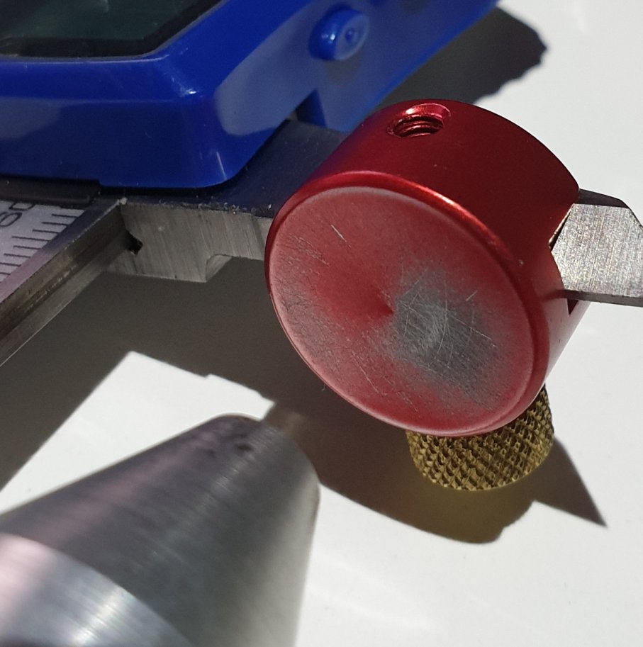

The Hornady rim thickness gauge isn't the best quality, the plate that the rim sits against during measurement isn't flat so the actual measurement is taken between the top of the rim and some point off center on the back of it, because of the stamped logo this makes it very prone to changes in measurement as the round is rotated.
I put the plate onto a flat grindstone and the picture shows how the high point was removed from it until the stone was touching the entire face, the additional scratches are from measuring 3,000 rounds.
The alignment against the tube that holds the round also needs some tweaking, I pushed them together with some fine grade abrasive paper between them which I then pulled out to get the top of the tube to sit completely flat against the back plate. By doing this first rotating the rounds often made no difference to the measurements but worst case was about 0.001" variation. This helped speed things up as I eventually moved to single measurements on each round unless they were extremes or the display was flapping between measurements.
Eley Standard is parfin wax lubricated so doesn't have the oily gunking up problem of other types but still needed cleaning every 30-50 measurements using a cotton bud with some G96 on it.
I have another 5,000 rounds still boxed but I'm not going to measure further, I have plenty of sorted rounds for testing and it's going to take me months to put those downrange and try to identify any meaningful benefit to the sorting process.

Grouping in the 38-40 range was noticeably better than the smaller or larger extremes but all groups still had flyers except the 34 which helped the score despite otherwise poor grouping.
Following that I shot a full 60 shot match with a 38.5 batch, scores were 99.7, 98.8, 95.7, 100.2, 99.2, 100.8
Total score was 594.4 which is actually the second best result I've ever got from Eley Std ammo (by about 1 point) and the main loss of points were those dammed flyers that I know weren't my fault, clearly the bad flyers aren't caused by rounds with a different rim thickness.
Testing will continue, I have nearly 3,000 sorted rounds and batching by rim thickness does seem to have improved things but cheap bulk ammo has a lot of flyers whilst expensive match grade ammo has very few. Hopefully sub-sorting by weight with further improve grouping.
Interestingly the Tenex that I have measures at 39 rim thickness, which my rifle really likes, with about a dozen measured showing almost no variation in rim thickness or weight.

My ES figures listed were generally taken over 25rds, five 5rd groups (just my preference as it lets me do this test twice per 50rd box of ammo). A few were only three 5rd groups due to lack of ammo, some were over 50rds, up to several hundred rounds (in the case of CCI Standard Velocity, Eley Edge, Tenex, and much of the bulk ammo that I have heaps of (so I shoot fairly it regularly). I shoot more CCI SV than anything else as I buy it by the case.
Highland RX HVHP has an ES of 12fps, but doesn't group much better than 2-minutes, though it does shoot those groups pretty reliably. I picked up a lot of bricks of all the Highland ammo, it's a good choice for cheap Metallic Silhouette practice, though not in my levers, the blunt bullet doesn't feed great in my levers. Highland RX HVRN has ES of 12fps. Federal F510 has ES of 16fps. Federal AutoMatch bulk has ES of 22fps but shoots very poorly. CCI SV has ES of 40fps and outshoots all but two other types of ammo, one of which has ES of 56fps.
I disagree that you can decide which ammo will be accurate based on the mathematics of velocity, while ignoring the mathematics of variations in bullet weight and shape, case volume, and priming compound charge and distribution, as well as the variation in the dimensions of the brass itself.
I just ran CCI SV through a ballistics calculator, the difference in elevation at 50m between 1080fps and 1060fps (SD of 10fps, ES of 20fps) is .15" or less than 4mm. That's less than the group size variation, thus the bullet may be travelling 15fps slower or faster, but that does not guarantee it'll drop or rise. It can be faster but hit lower, or be slower and hit higher, due to the other variations in the total dynamic of the shot, including the rifle itself.
