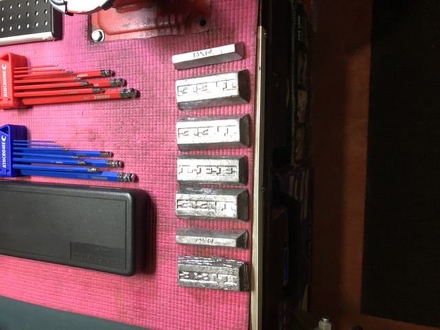

HI Im in north of melb been casting ingots in my Lee mold ,almost there next on my list is bullet mold....gas checks , sizing mold...I think

Post by flashman » 20 Mar 2022, 5:18 pm
Ingots …….. :thumbsup:
