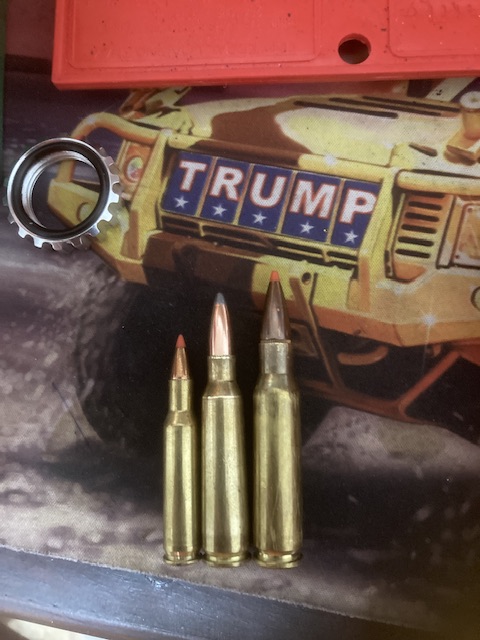

Got my 250 die set and reformed a 22-250 case with the base of a 87 Speer level with the “old” neck .
Left to right, 222, 250 savage, 308. They look like a good team.
wonder if i'll get any comments on my "trump" tekmat on my reloading bench ;) i bought that a few years ago as a laugh cause of it's pure overblown americana :lol:

So 250 savage isn't the same length as 22-250?
Posts: 4178
Re: 250 savage
Post by Blr243 » 03 May 2024, 3:34 pm
I just realised the 250 sav is actually the parent case of the 22250 Remington
