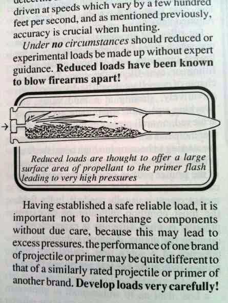

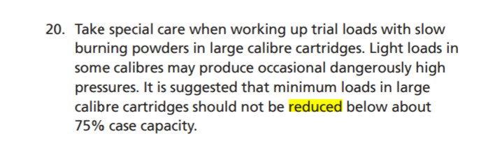

Post by Oldbloke » 20 Mar 2020, 8:21 am
These are the issues. Ocassionally guns blow up. Also bullets stuck in barrels. From ADI manual.
reduced loads .jpg (39.15 KiB) Viewed 12002 times
Reduced loads 60% max 2206H.JPG (72.59 KiB) Viewed 12002 times
Explosive detonation.jpeg (38.52 KiB) Viewed 12002 times
Re: Sub-sonic .308 hunting rounds
Post by Maxjon » 20 Mar 2020, 9:32 am
Oldbloke wrote:These are the issues. Ocassionally guns blow up. Also bullets stuck in barrels. From ADI manual.
Yes seen that, read it everywhere. All I can say is, the right powder choice is critical. The guys I have been shooting these loads with have been doing so for 30 yrs....or more, never had a problem ever. Go figure.....Beer is great, how do they make it so cheap??
Post by bladeracer » 20 Mar 2020, 9:51 am
Bullbarrel033 wrote:[quote="Oldbloke"These are the issues. Ocassionally guns blow up. Also bullets stuck in barrels. From ADI manual.
[/quote
People need to actually read what they're reading.
Light loads...large volume cases...slow burning powders...can sometimes be a problem.
Fast powders in small cases are not a problem.
Post by Oldbloke » 20 Mar 2020, 10:20 am
"People need to actually read what they're reading.
Fast powders in small cases are not a problem."
More or less sums it up. With shades in between.
