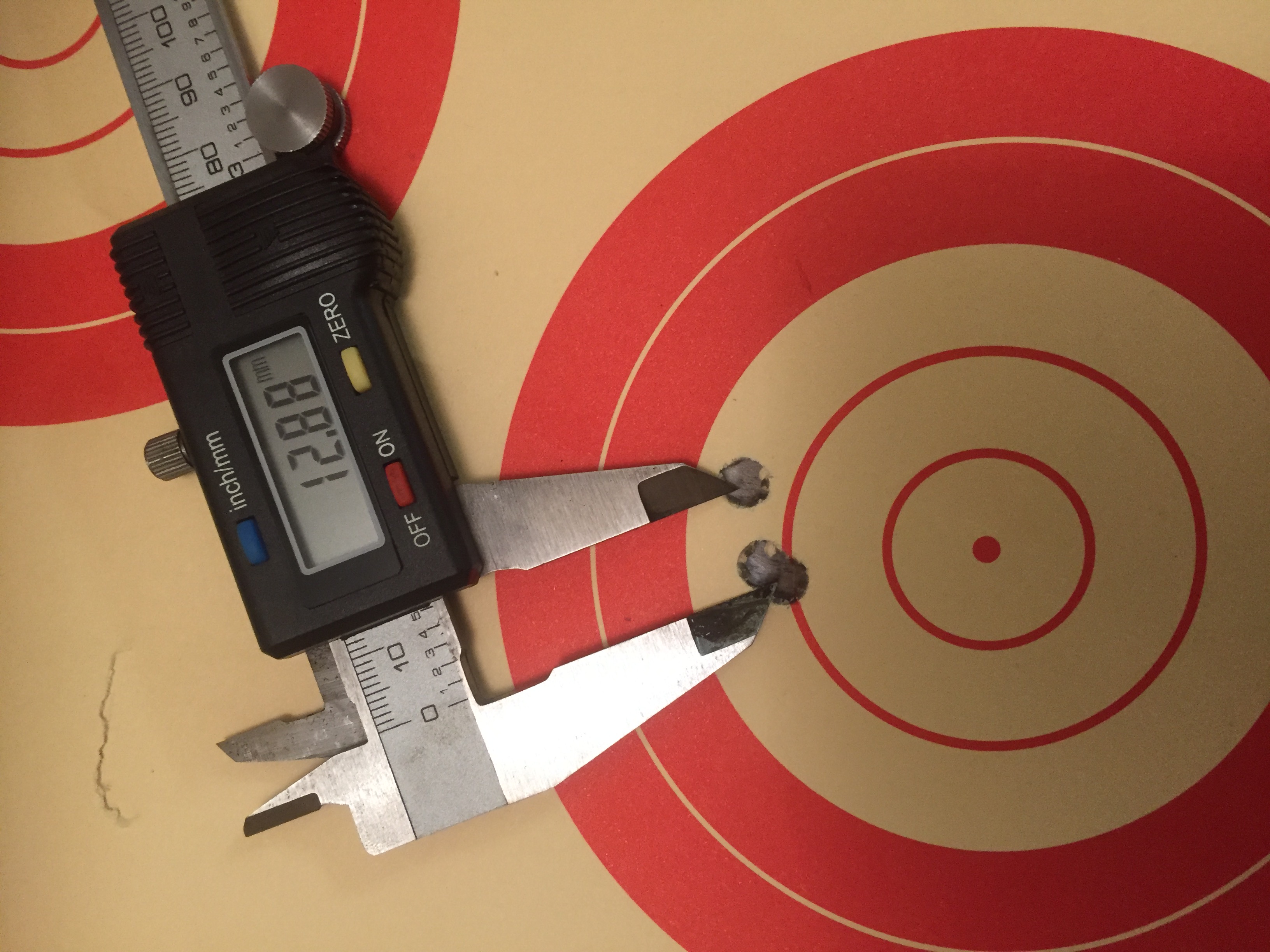

best 3 shot group at 100 out of my 6.5x55 on the weekend at ripley
