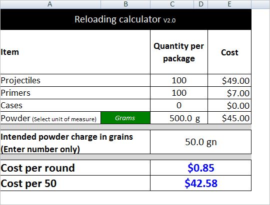

Sounds like YB needs to get into reloading...........Am I repeating myself here?
I can load my 3006 with 130gr proj for $17 a box of 20. I never buy ammo. The LGS is asking $33 a box of 20 150 gr plus my fuel to drive to the LGS.
He doesn't sell 130gr ammo only the bullets. So I get what I want this way.
A Lee kit is about $260 from memory. The kit should pay for its self in about 10 boxes.

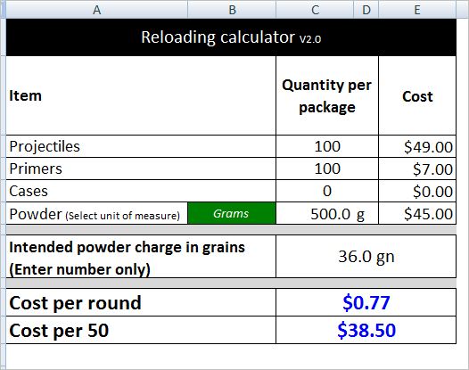

Example:
LGS lists 75 gr Hornady vmax at $49 a 100. And ADI lists AR2208 36gr as a middle of the road load. So reloading cost is about $15.40 a box of 20 for you. (not counting your time and brass, but you have that now.)

Didn't think I'd need to look at reloading so soon, then again I suppose the sooner I start the sooner the I start saving coin.
Sh*t looking at those numbers you posted it really does make sense to start sooner than later.
