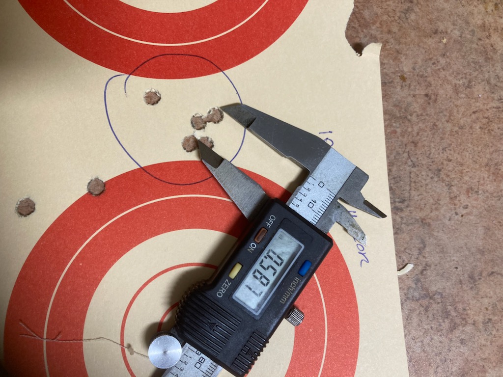

Post by bigrich » 27 Jul 2024, 3:01 pm
Well things didn’t go too badly today. With ADI starting loads 2208 wasn’t that flash, but I wasn’t expecting too much seeing as how I’m fire forming cases. But 2206h starting load was reasonably impressive. Except for a flier, the first four rounds went around half inch at 100 yards. Thinking I’ll use this as a comp load and do fire forming , and develop hotter hunting loads for paddock use from the formed cases. From what I’ve read modern action loads aren’t far behind the 257 Roberts from the efficient little savage case. I’d put up pics, but my f@eking stupid iPhone won’t play ball. Honestly I could just throw these damn phones at a wall, jump on it, then for good measure throw it under a B double

now , back on topic, i've got formed cases , so warmer loads will be tested in coming weeks . 87 and 100gn speer hotcor's show accuracy potential , and their cheap :D as premium bullets go, i've also got 85 and 100gn nosler bt's to try . supposedly these are silly accurate and the 100gn bt are a good "all round" bullet that handle pigs well . the nosler's expand well but not too rapidly in the 250. has something to do with their design for use in the faster 25-06 . apparently ;) from everything i've read , 2206h works with 1-14 twist 250 savage , 2208 for 10 twist . some crossover with the 85's with powder choice . man i've got some load work to do .

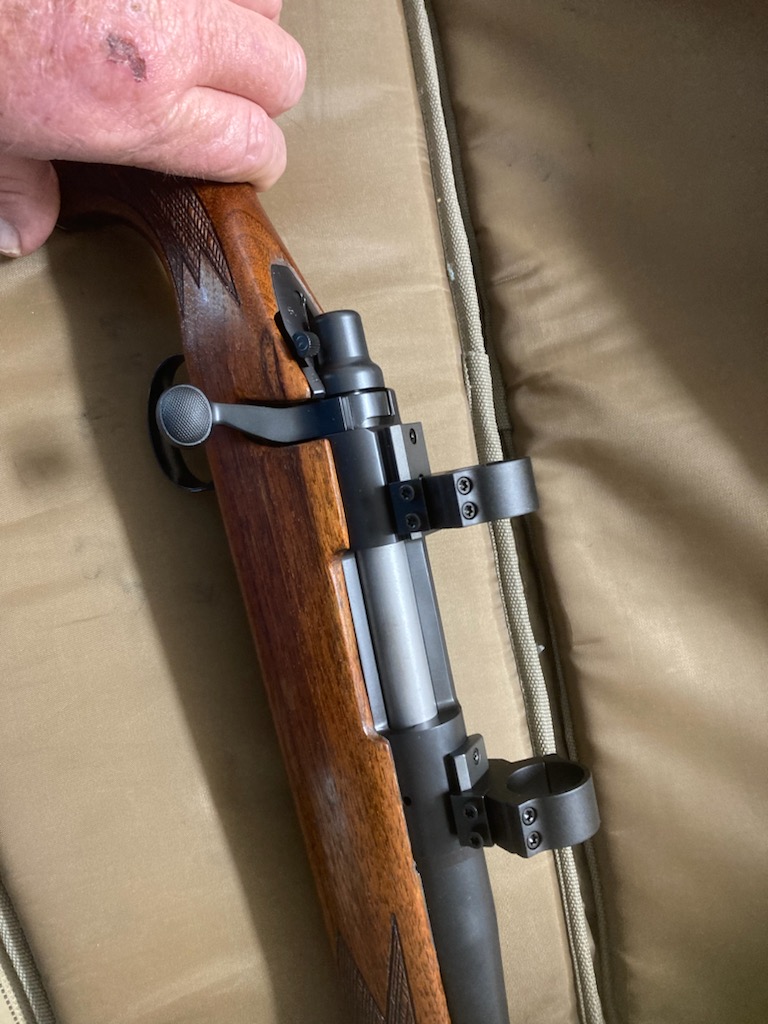

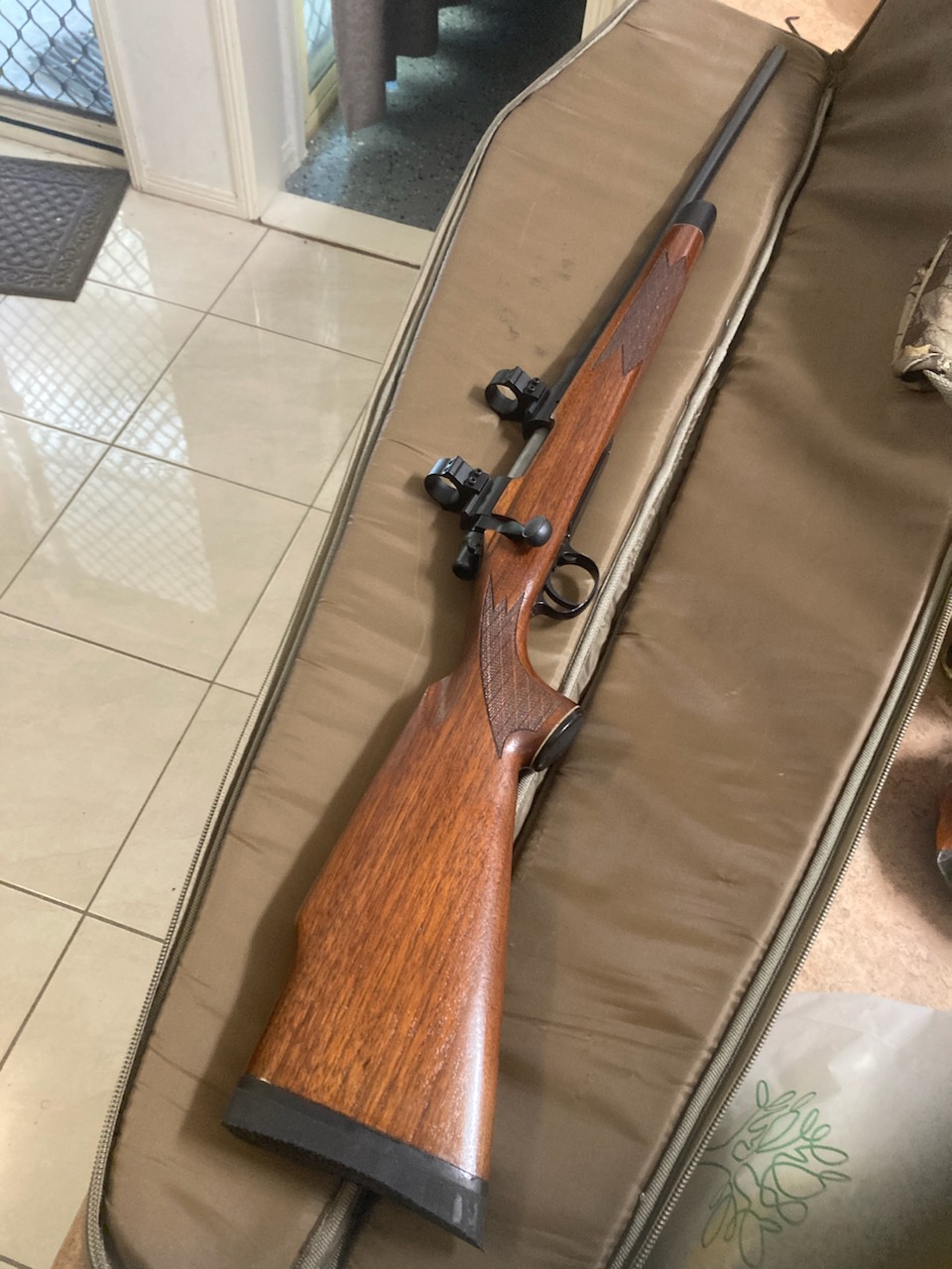

Post by bigrich » 28 Jul 2024, 9:02 pm
Well OB is not just a pretty face. My pics have been compressed and accepted for upload onto the forum. Thanks OB .
My smith matte blued my rifle. I wanted it gloss blued, but the matte has grown on me . It looks kinda sexy…..
