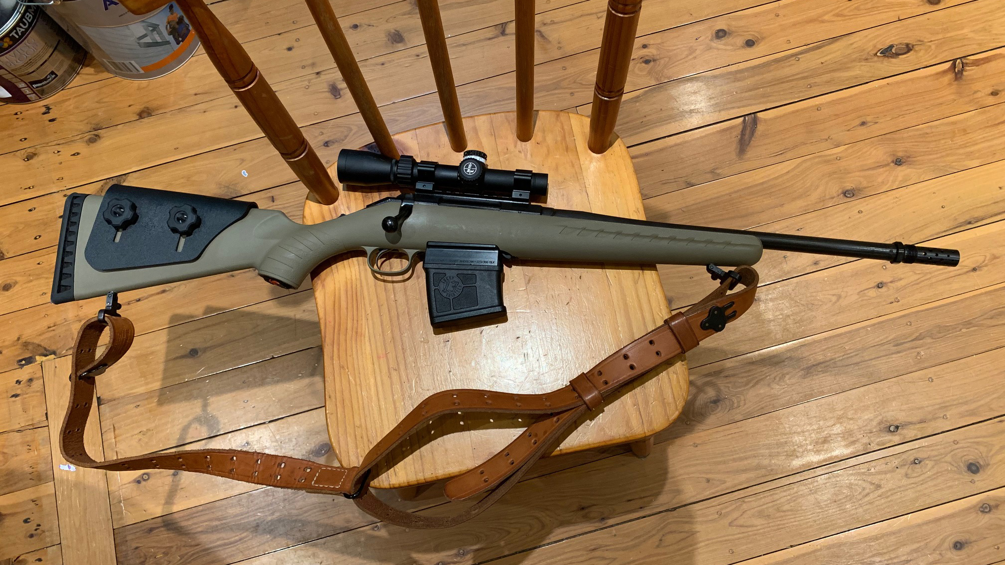

I built up my RARR to shoot 3p practical comps on the 100m and 200m lines, with the occasional crossover into hunting. They are an extremely light, handy little rifle still with an adequate lop. It definitely holds its own on the 100m and 200m line. I'm yet to test it properly on the 300m line, but on those blustery days, at 300m I think you'd be up against it (vs true long range cartridges).
I like it because it's economical. It only takes about 17grs of (fastest) rifle powder to fully fill the case which yields around 2100fps out of the 16" barrel (using a 125gr 30cal pill). With decent bullets, that load bucks the wind well enough at 100m and 200m.
Nevertheless, I reckon It's a finicky little cartridge. The brass around the mouth is thin compared to a 308w (after all it's stretched 223 brass). This means your up against it with regard to neck tension (compared to the 308w). And from my experience fast powders prefer tighter necks when compared to medium powder; you've always got to work harder to get fast powders consistently grouping.
I had to turn down my (collet) die's mandrel a fair bit to get it to group - even then, it's not really a sub-moa cartridge. I'd say It's probably more a 1 moa cartridge. I've got mine shooting about 1moa for 5 shots at 100m (when shooting from a chair). But I'm far from shooting 1moa from the elbows, so that suits me just fine :lol:

Are you using bullets that take advantage of the 7"-twist?

bladeracer wrote:Are you using bullets that take advantage of the 7"-twist?
Nah I'm yet to experiment with that Blade, and may never. I didn't really buy the rifle for that reason. And that's actually a negative - If I had my way I'd slow the twist and shorten the throat to match the shorter varmint style 30cal pills. The jump to lands must currently be bretty massive...

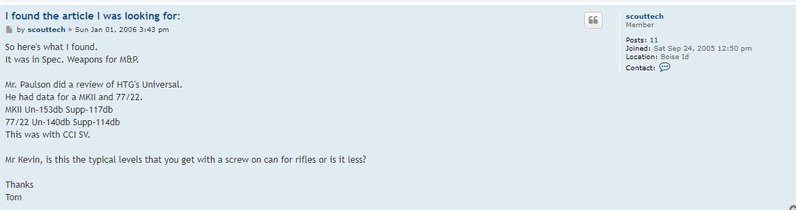

I'm not sure about this.
It seems to be that 110dB regular exposure for more than sixty-seconds causes permanent hearing damage. Long or repeated exposures above 85dB can cause hearing damage.
In Australia it seems to be that no employee can be exposed to over 140dB, at all. But up to 85dB is fine over an entire eight-hour shift.
I'm thinking standard velocity ammo is just fine, except for long and prolonged exposure.
https://www.safeworkaustralia.gov.au/noise

mate 'thinking something is fine' is pretty poor position to have on a safety related subject. Im guessing your not an OHS officer :D
Its generally agreed 135-140 is the 'threshold of pain' for impulse noise, where instant damage can occur. Different countries have different levels advised, but they generally agree hearing loss will occur lower than that through repeated exposures> plenty of articles out there.
Most the 22LR standard figures I have seen are about 135- 141 DB , generally the lower figure if barrel is longer.
Probably why the companies don't print 'hearing safe' on it, only the actual hearing safe stuff. ;)
I guess I am a bit careful having had hearing damage from the army and also reading into it. Most the experts can't agree we can even measure sound impulse accurately. Also its not as simple as 140DB = xyz damage. Different types of noise destroy different frequency hairs in the ear. Shotguns hit lower freqs for example, rifles hit higher freqs.
But I am a little suprised people want to ride this margin of risk at all. Ask on a US forum and see what the reaction is. I don't think I have seen many ranges recommend new starters go 'bare eared ' shooting with 22LR :crazy: .

Re: 300 AAC Blackout fad over?
Post by bladeracer » 30 Jun 2019, 10:53 pm
I just did a quick Google and found some numbers for CCI Std Vel - around 115dB in pistol and rifle supressed, 140dB for unsupressed rifle.
http://www.silencertalk.com/forum/viewtopic.php?t=1517
CCI SV dba.JPG (34.59 KiB) Viewed 11000 times
