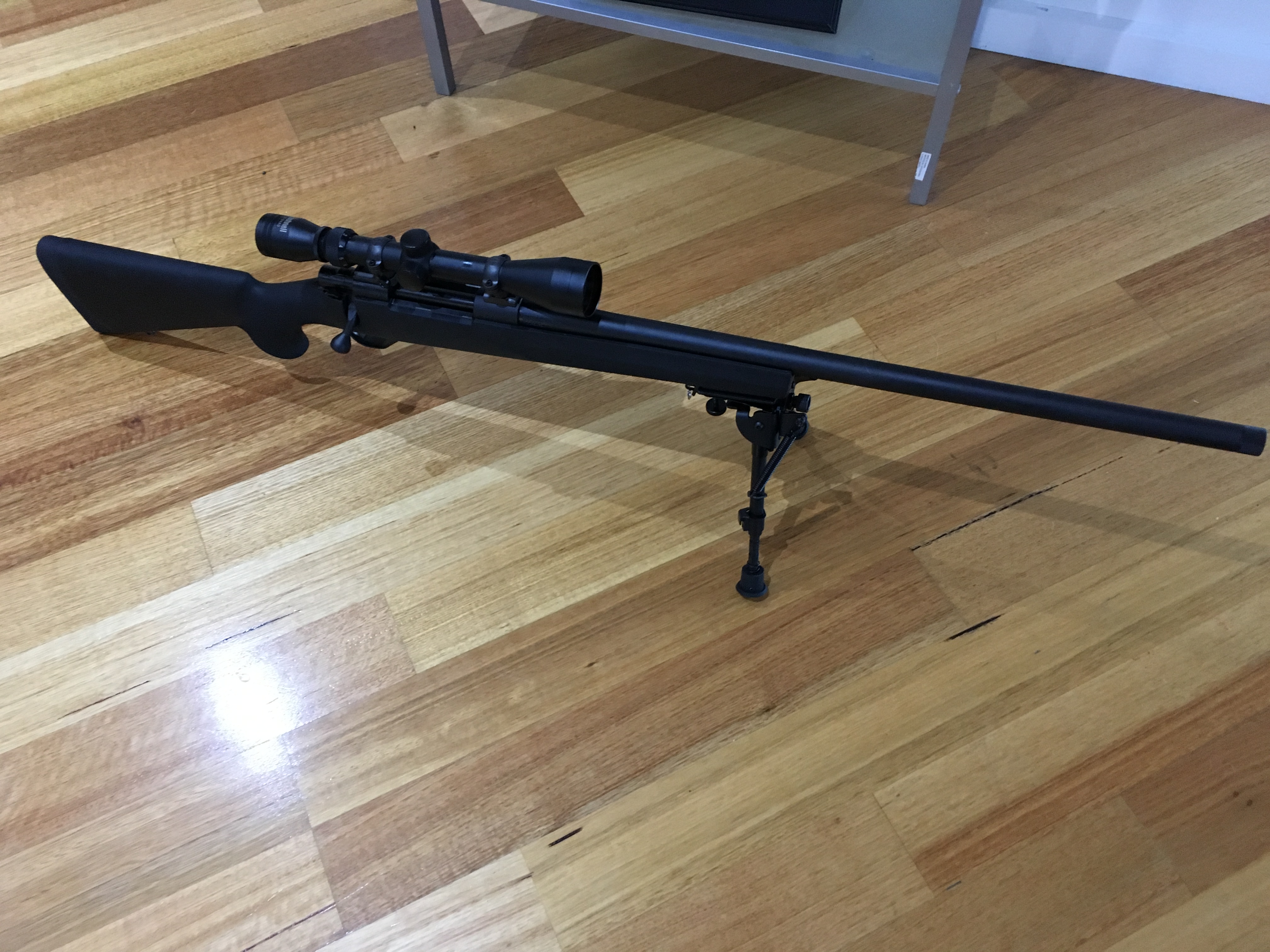

Picked it up this afternoon - 1st impressions are very good. Heavy but solid built...bolt is solid - not tikka smooth yet - but nicely firm.
Ole mate picks up his tikka lite next week - then let the ass kicking begin lol...(one way or the other)
Thanks to Marksman and some back end advice - I might just have a chance of showing this ole boy a comparable group.
Stay tuned. Game on lol.

Mr and Mrs Tiger would like to announce the safe arrival of Holly Howa Tiger, born 11/7/19 at 37 bloody pounds. Lol. Thanks to Godfather MM for his assistance.

Post by marksman » 12 Jul 2019, 5:38 pm
I have to say Tassie that I am very envious
I have the money to get one or to buy a new welder that I need to weld some alli parts for the boat and I'm talking myself into not needing the parts :lol:
maybe it will be next years mission I think
now is the time to check the rifle out and see if you want to do some tweaks, for example lighten the trigger and lap recoil lugs
getting the bolt to be smooth isn't that hard just polish the raceways
its good that you got the threaded muzzle just in case you want to fit a brake :thumbsup:
are you going to let the missus have a crack, I always found that lady's are a bit more recoil tolerant and usually can shoot the bigger cals pretty good
and the fun begins :drinks:

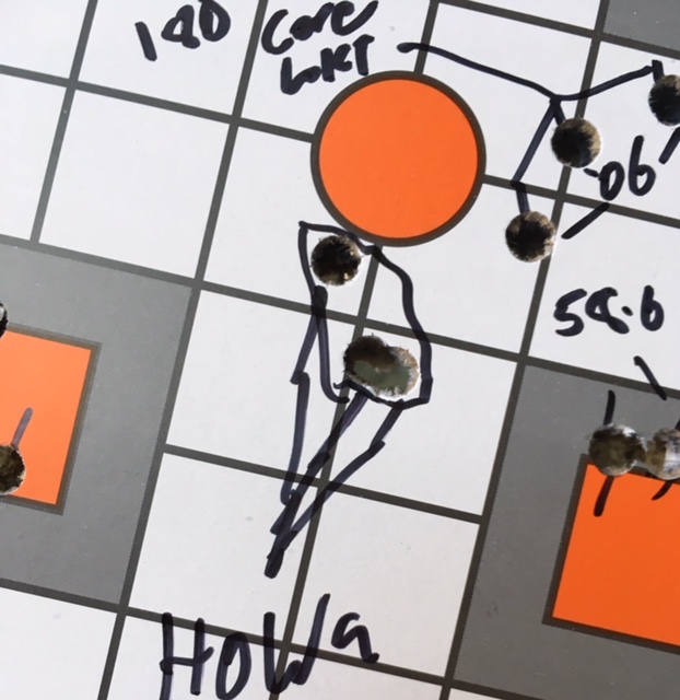

So, very first shots fired in anger of 300wm...
I wanted to sort my 06 load first - confirm a decision so I only had some Core-Lokt to warm the 300 barrel.
This was first ever 3 shots of 180 Core-Lokt at 105m off a front / rear bag but with an ole bushnell 3x9.
Not too bad if I do say so myself...

Post by SCJ429 » 16 Jul 2019, 6:06 pm
Excellent result, and you are running it in. How much copper fouling are you getting?
Re: 300 Norma, 300 RUM, 300 win, 300 WSM
Post by marksman » 16 Jul 2019, 6:54 pm
nice Tassie :drinks: , I'm green with envy, she will be a shooter, and yea any copper?
Post by Stix » 16 Jul 2019, 6:56 pm
Good stuff Tassie... :clap:

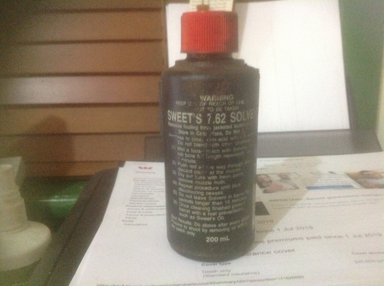

Sweets 7.62 is copper solvent.Standard solvent will not melt copper.You can only leave Sweets or similar products in for 5 minutes then brush with a nylon brush and patch until all the blue is gone then use normal solvent with a copper brush and patch out then lightly oil till next time.Once you have done this you will only need to do it when accuracy starts to diminish or you feel like it.I have done this to my .222 .243 and 7mm Rem Mag you sort of get a feeling when it is time to decopper the bore again depending on useage .You may find after a super clean with a copper solvent you need to shoot 2 fouling rounds before it groups well again.This is just what I do it seems to work for me
Post by duncan61 » 17 Jul 2019, 8:26 pm
:D :D I purchased a small bottle of Sweets 7.62 in Bunbury in 1990 and still have a near full bottle You clean as per normal then put a few drops on a patch and push it through twice.The second time you will see blue which is the copper starting to melt.You have to use a nylon brush as a copper one will melt.I went to the shed and got mine cos I felt like it.Its still got the destructions on it

I have not used Hoppes copper solvent for many year but back then it was next to useless. Sweets 7.62 and other ammonia based solvents are OK. The best by far is Boretec.
Clean out the carbon and the look up the muzzle, you can see the copper, patch it, soak it and scrub it until you don't see the copper on the lands and your not getting an blue copper sulphate on your patch. One shot at a time to start with. There is a lot of cleaning involved.
That 30/06 is going to need a lot of soaking to get it clean as a whistle. You will then have to resume the running in process for it as well.
