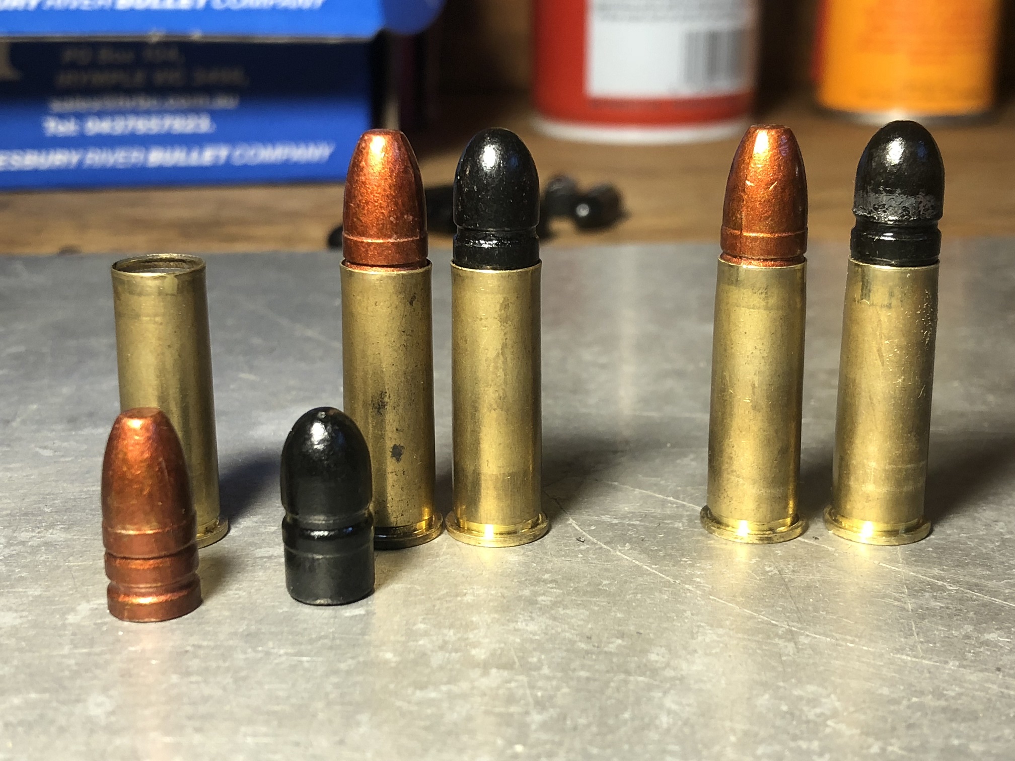

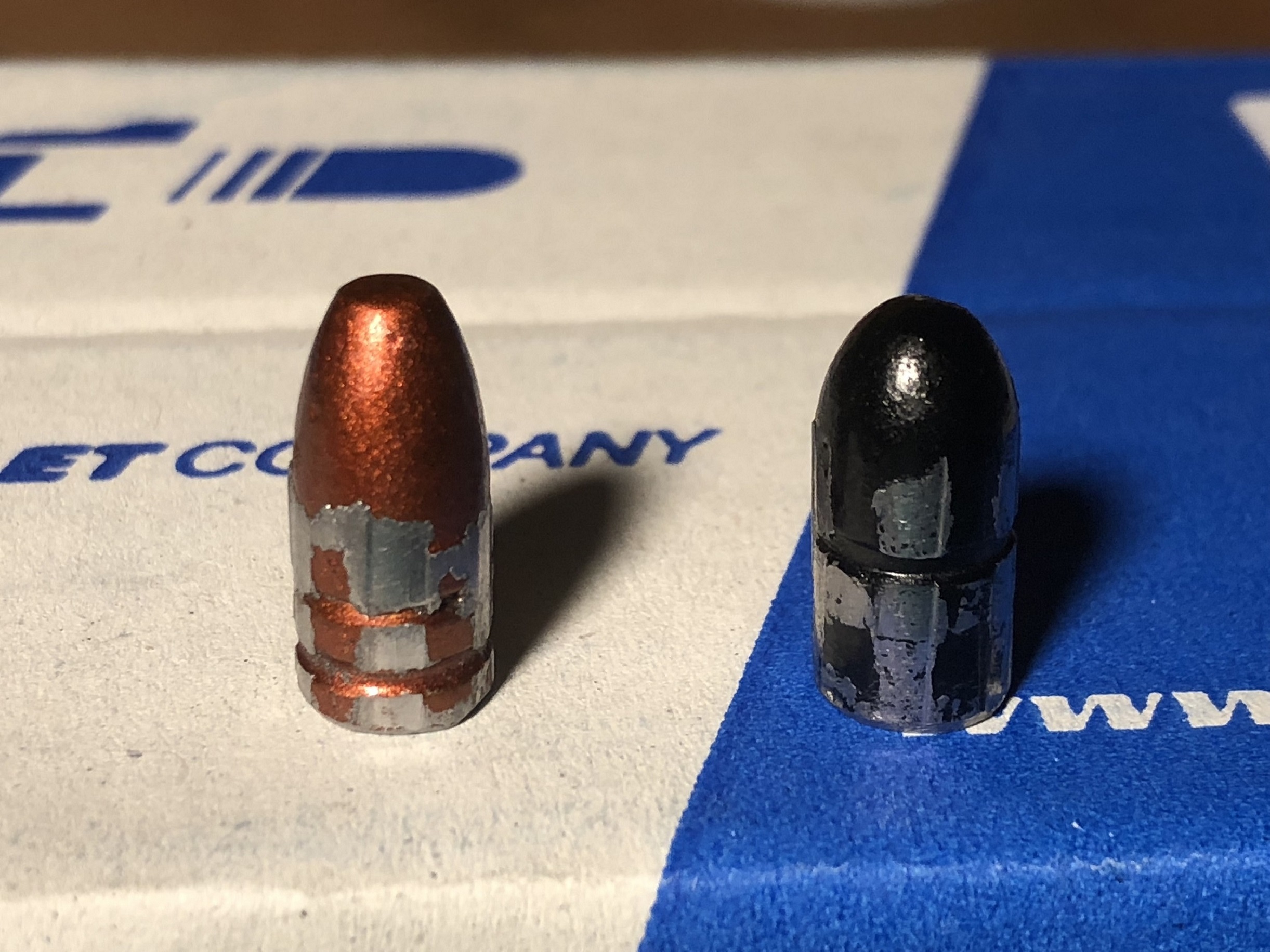

Post by goldiexxxx » 14 Aug 2018, 8:51 pm
Hi Stoney,
Yes I did slug the bore but Im not sure what the final result is telling me. I used both the .316 and .323 Hawkesbury projectiles and they both measured the same bore and groove diameter.
Bore diameter - .316"
Groove diameter - .321"
So if the bore diameter is .316, then the .316 projectile should have slipped straight through without any marks from the rifling; yet it was expanded to fill the grooves and has clear rifling marks exactly the same as the other slug from the .323" projectile.
See photo of rounds pre and post FL sizing in order to get them to chamber. Notice the coating slightly removed on the black .323 projectile.
And see photo of both bore slugs used.
I have not had any experience with slugging a rifle bore, so is this what I should have expected?

Post by Stoney » 15 Aug 2018, 4:46 pm
G'day goldiexxxx ,
Yes I encountered the same problem and I can only guess that the smaller projectile at some point gets grabbed by the lands and then whilst you are smacking away the bullet " fattens " because of its softness? The resistance makes it go outwards as well as forward if that makes sense. Just like a .22lr heeled section expands somewhat into the bore. Maybe someone more qualified can answer that. I used to get a .38 wadcutter which are soft and smack that down the bore. They are all over the place when it comes to bore size and chamber size as No1Mk3 rightly said. Just when you get the right projectile you find you cant chamber it. Now I remember some of the headaches :crazy: If you haven't chamber cast perhaps give that a go as it will add to the " big picture ". Also there is an Aussie bloke on YouTube that does a series that is good. I think he end up putting a .308 barrel on for convenience. https://www.youtube.com/watch?v=UbCAQW2isv4

I'm starting to get the feeling this rifle has been reamed out to make a longer chamber. I can drop one of the copper coloured Hawkesbury projectiles down the chamber and then put a case in behind it without the projectile seated in the case. The .323 projectile doesn't get too far into the chamber even by itself, so its just simply not going to be the correct projectile for this rifle without swaging with the FL sizing die.
What cartridge overall length are most people loading for their own Cadets?
And what case length is working with that COL?
Looking at the pictures above of the copper coloured projectile, I can seat one of them only down to the first cannelure and it will still chamber comfortably in the rifle.
Is this the correct seating depth?
Thanks,
Goldie

I did, however, attempt to make some crude measurement based up component lengths and displacement of those components ............ I know what I'm talking about.
So the following is only hypothetical information based upon my particular measurements taken this evening:
Bertram Brass case - 1.069" case length
Hawkesbury River 122gr projectile - 0.704"
I can put the projectile and case into the chamber, and still have space before the projectile touches the lands - 0.06" space
Not knowing exactly at what point on the ogive the lands make contact, theoretically, I could load a round for this rifle slightly less than 1.833" COL.
Does that sound right for a .310 cadet? To have a chamber length that long?
So now taking the two of my first attempts at reloading for this rifle, as pictured above, the COL for these are:
HR copper coloured 122gr - COL 1.554"
HR black coloured 128gr - COL 1.570"
That's an average bullet jump to the lands of 0.270". Does that sound sort of average? Its way more than what I load for in my .308 or .223. I mean, its not a revolver!!
Does anyone think that this is out of the ordinary and maybe the chamber has been reamed out a bit?
I have a batch of newly loaded rounds for Sunday, trying to at least see if I can get some consistency. Just need to take me out of the equation I suppose :crazy:
I know, Stoney is just going to tell me to cast the chamber and stop asking questions. I know Stoney, I'm just warming up to it. See how I go this weekend first though.
I really appreciate any info and help you folks provide too, its very much welcomed.

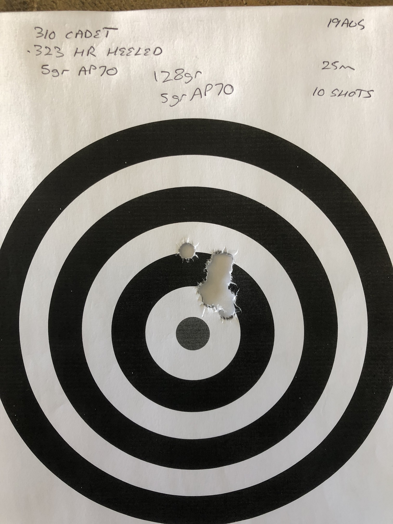

Post by goldiexxxx » 19 Aug 2018, 4:10 pm
Well back from the range today. I'm pretty happy with the results. I took another batch of handloads, having learned a bit from last week's efforts, and was confident my work should yield a lot better consistency. I was glad I decided to put a middle load between 4.5 and 5 grains of powder too.
So now I have a load for both styles of Hawkesbury River projectiles using ADI AP70N powder. Case lengths are all over the place as I have not trimmed the Bertram cases. Bit surprised there was not a little better consistency in the case length for brand new brass to be honest.
HR 122gr .316" Copperhawk
4.7gr ADI AP70N
HR 128gr .323" (heeled) Blackhawk
5gr ADI AP70N
The 128gr projectile produced a group only slightly better, but that could have just been my shooting. After all, I'm only basing this on a single 10 round group from each at this time.
Anyway, here is the best group of the day.
Cheers, Goldie

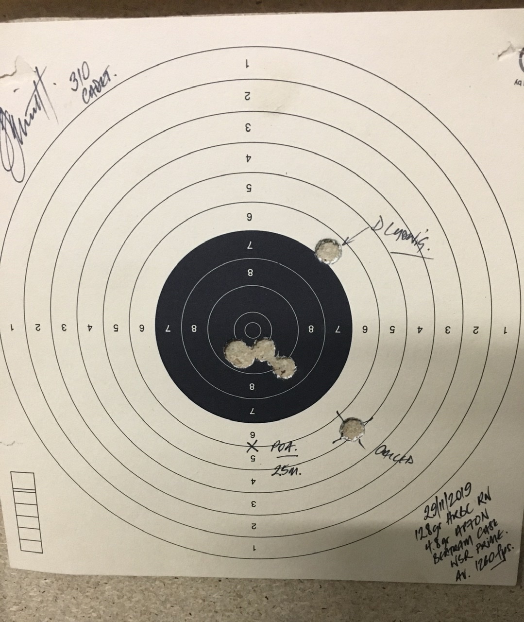

Post by Tank » 01 Dec 2019, 8:28 pm
6 shots at 25m in the bull. 1 shot I held off at 4o’clock as I couldn’t see previous shots and one a mate shot at 2....colour me pleased!
Quick update!
Great advice man. Put 20 together settling on 4.8gr AP70N in the slightly long Bertram cases and.....load development over! (Chroni average of 1,260fps....so the sights should regulate nicely too)
Cheers again!

Post by goldiexxxx » 14 Dec 2019, 6:48 am
That's a great result Tank. I have also found the load to be correct for the 2nd Pattern sights also. I'm only shooting at less than 100m anyway, and with only two graduations of 50 and 100 yards on the sights, there is not a whole lot of granularity available; regardless, the sight marks align as expected to whatever range I'm shooting. Good luck shooting your Cadet in those club competitions.
Goldie
