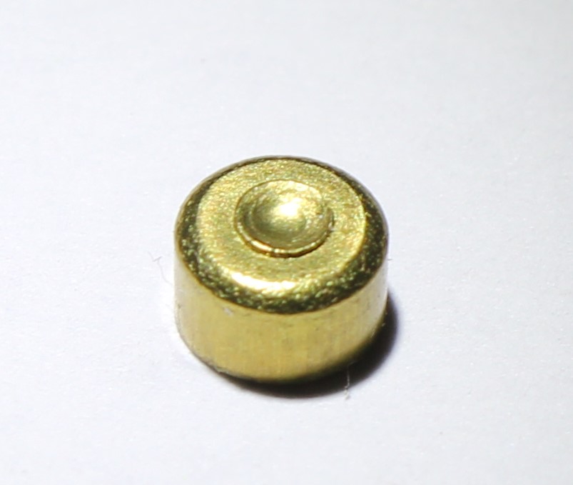

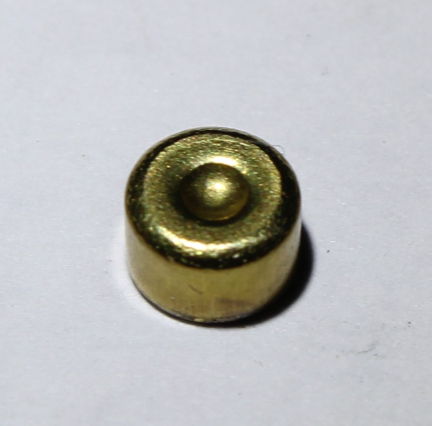

OK, I had to find where I'd stashed an example of the cratering to get a couple of pics.
The pics are both Remington Small Rifle, the cratered was 25gn and the uncratered was 23gn of 2206H.
I have since run out of these and I'm currently using CCI BR4

Post by marksman » 23 Oct 2018, 12:31 pm
its not IMO pressure, the edges are still round, the primer is not flattend out at all, the primer has not enlarged
no pressure :unknown:

Post by Gaznazdiak » 23 Oct 2018, 5:14 pm
I'm not trying to be argumentative here marksman, I appreciate your input, but if you look closely at the pics the uncrated one has an even, round profile from the outside edge and over into the pin impression, whereas the cratered one is distinctly flattened around the crater.
The pin impression on the uncatered is also far deeper than the other, which looks to my barely tutored eye to have flowed under force into the firing pin hole in the bolt.

Post by Oldbloke » 23 Oct 2018, 5:17 pm
marksman wrote:its not IMO pressure, the edges are still round, the primer is not flattend out at all, the primer has not enlarged
Agree 100% maybe warm, definatly not hot. Fairly normal really.

Post by marksman » 23 Oct 2018, 7:45 pm
Gaznazdiak wrote:I'm not trying to be argumentative here marksman, I appreciate your input, but if you look closely at the pics the uncrated one has an even, round profile from the outside edge and over into the pin impression, whereas the cratered one is distinctly flattened around the crater.
I would suggest that your firing pin hole is a bit sloppy causing the cratering
the edges of the primers are both rounded, no pressure
rem 7.5's are a good primer and are supposed to be a thicker cup but they measure 20 thou and the cci's 25 thou
honestly try the cci br4 or 450 mag primers with that load
check out these primers from factory ammo
the hornady has rounded edges on the primer but a very slight crater, but I would consider it mild and safe
the s&b is totally flattened and probably has an enlarged primer pocket, this I would say is on the edge but I must assume it is safe as it is factory
I would never load to this level of flattened primer even though I don't believe in looking at primers for pressure
measure the case head its much more reliable

Post by Gaznazdiak » 24 Oct 2018, 9:50 am
As nobody was able to offer an explanation that definitively disproved pressure, I did some googling and much more reading.
Every source, without exception said that a common cause is ill fitting firing pin, but every source also said that if factory loads or your minimum loads do not cause cratering and hotter hand loads do, pressure is the only logical culprit.
So erring on the side of prudence and safety, I can only go by the majority of opinion.
Thanks to those who took the time to offer some advice on this problem.
