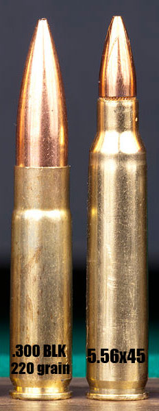

It's actually a necked up and shortened .221 Fireball/.223 Rem, not a shortened .308.
Picture here of a 300 Blackout compared to a 5.56x45 Nato.
.300 blackout vs 5.56x45 Nato.
Like Baldrick confirmed though, the concept is to shoot 30 cal weight bullets at sub-sonics speeds. It's a military designed round intended to be used with a suppressor for urban sniping and tactical operations.
Quiet, effective within 200m (or thereabouts) and without the potential over penetration of a .308.
