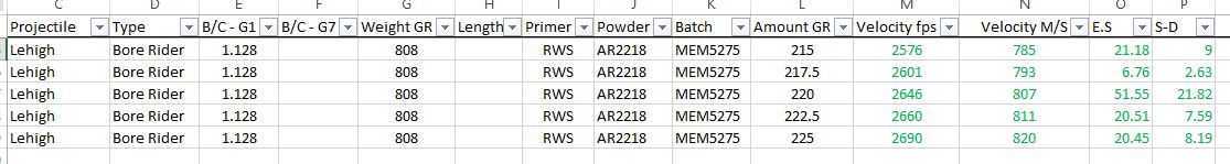

I have managed to achieve the holy grail of low numbers in a large cartridge (2nd Row) and many smaller ones...This is one of my go to loads for 1000yd competition :) Data was captured from a 5 shot string using a Lab Radar and I've managed to repeat it more then once. Even with a 10 shot string I was still in single digits for ES & SD
This is approximately 27.5 levels above where I am lol.
